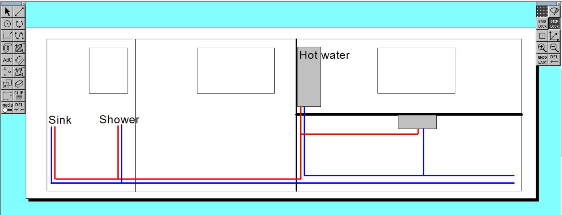

  4. I'm about to start the basic plumbing on my refurbishment. I have the thought to split the cold into 2 separate lines, one going to the water heater and the other to be the cold taps in the shower room. Is this worth doing? Would it maintain the pressure to the hot water for the shower? Or is it just a waste of time, pipe and fittings? Thanks, Kevin
