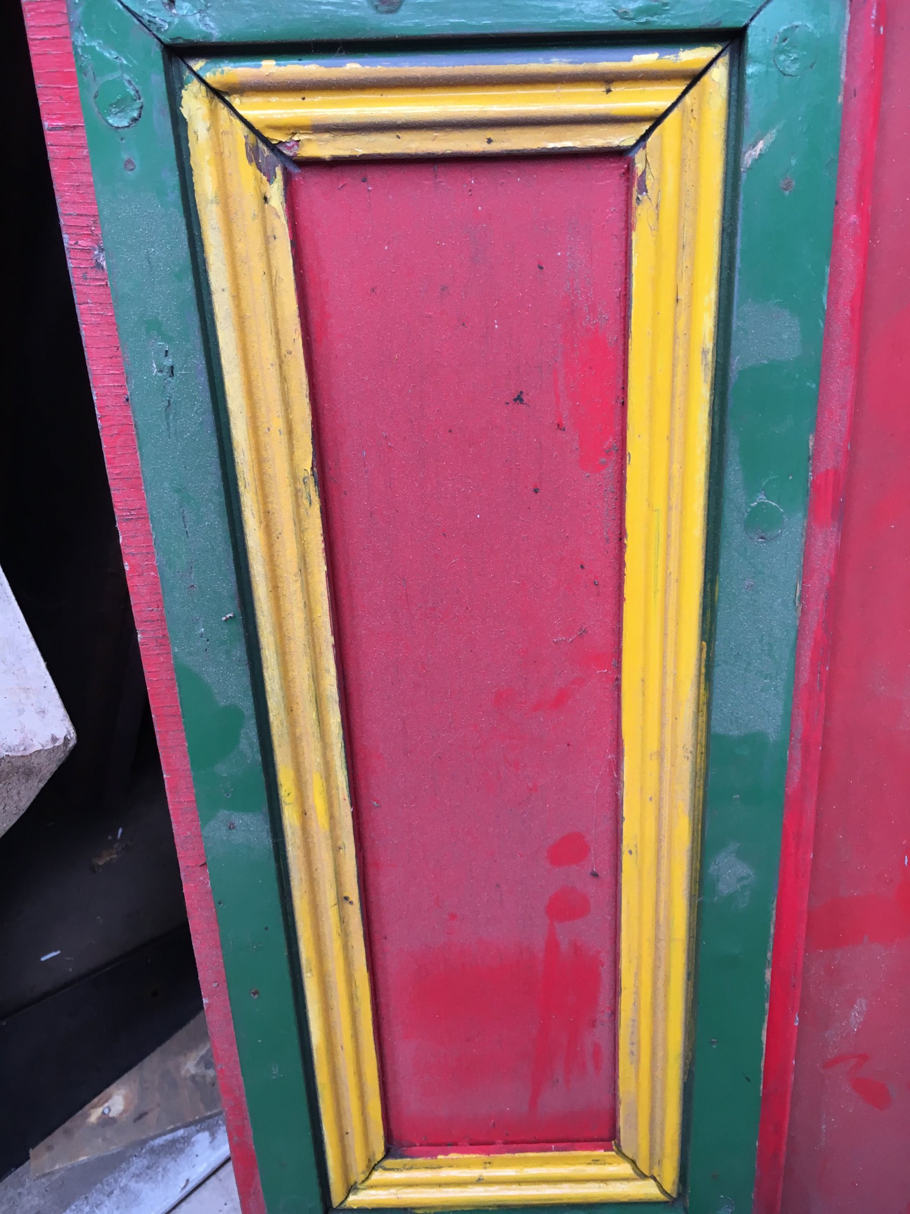

Tiggers Posted July 9, 2018 Report Posted July 9, 2018 As some may be aware, we are currently rebuilding the Ken Keay tug ‘Canis Major’. She was reskinned in 2005 by Jem Bates and looking at some old pictures, it looks like the mouldings/beading has been changed from what was original (it looks like Jem just used skirting board..). I know Ken used to use quite a destinctive moulding so I was wondering if anyone had any close up pictures of this? We really want to put her back how she was originally but can’t make out the beading properly from the photos I have of her. Thanks!

Tiggers Posted July 10, 2018 Author Report Posted July 10, 2018 Seeing that picture makes me believe that the moulding that is still on my back doors is the same as what was originally on the cabin! That makes it easier to replicate. Will certainly have a chat with Malcolm though as well

Tuscan Posted July 10, 2018 Report Posted July 10, 2018 6 hours ago, Tiggers said: Seeing that picture makes me believe that the moulding that is still on my back doors is the same as what was originally on the cabin! That makes it easier to replicate. Will certainly have a chat with Malcolm though as well I’m pretty certain that this is the same moulding as existed on Canis when I had her.
Tiggers Posted July 10, 2018 Author Report Posted July 10, 2018 12 minutes ago, Tuscan said: I’m pretty certain that this is the same moulding as existed on Canis when I had her. That’s good to know I’ve got a couple of pictures of Canis but none close enough to see the moulding! That’s definitely made my mind up, thank you

David Schweizer Posted July 16, 2018 Report Posted July 16, 2018 On 10/07/2018 at 10:21, Tiggers said: Seeing that picture makes me believe that the moulding that is still on my back doors is the same as what was originally on the cabin! That makes it easier to replicate. Will certainly have a chat with Malcolm though as well From what I can see, that moulding is probably a "Quirk Ogee and Bead" and will be quite difficult to find. A sprecialist joinery company might be able to mill some for you, but be prepared to pay a lot for it if they do not already have a suitable milling bit.
Tiggers Posted July 16, 2018 Author Report Posted July 16, 2018 2 minutes ago, David Schweizer said: From what I can see, that moulding is probably a "Quirk Ogee and Bead" and will be quite difficult to find. A sprecialist joinery company might be able to mill some for you, but be prepared to pay a lot for it if they do not already have a suitable milling bit. You certainly can’t find it anywhere but we are currently making enquiries to have some made up, aa we need about 80m of it. Having just bought all the marine ply and about to get the bill for the opepe bottom boards, I fear it is going to be an expensive month ?

furnessvale Posted July 16, 2018 Report Posted July 16, 2018 40 minutes ago, Tiggers said: You certainly can’t find it anywhere but we are currently making enquiries to have some made up, aa we need about 80m of it. Having just bought all the marine ply and about to get the bill for the opepe bottom boards, I fear it is going to be an expensive month ? Stockport Timber next door to Reddish North railway station, have a planing machine and a wall full of different cutters to fit it. They fixed me up with the profile I needed for Badger's cabin which is not a currently available profile. Not cheap, £60 set up fee plus timber and labour for the job, so I took the precaution of buying enough to redo the whole cabin just in case! Tel no 0161 432 8777. HTH George 1
Tiggers Posted July 16, 2018 Author Report Posted July 16, 2018 Just now, furnessvale said: Stockport Timber next door to Reddish North railway station, have a planing machine and a wall full of different cutters to fit it. They fixed me up with the profile I needed for Badger's cabin which is not a currently available profile. Not cheap, £60 set up fee plus timber and labour for the job, so I took the precaution of buying enough to redo the whole cabin just in case! Tel no 0161 432 8777. HTH George That’s worth knowing, thanks George, will give them a ring this week
BEngo Posted July 16, 2018 Report Posted July 16, 2018 Draw the profile full size and Axminster Power Tool Centre will supply a router cutter or a spindle moulder blade set to match if they don't have a stock item. N
Tiggers Posted July 16, 2018 Author Report Posted July 16, 2018 2 minutes ago, BEngo said: Draw the profile full size and Axminster Power Tool Centre will supply a router cutter or a spindle moulder blade set to match if they don't have a stock item. N Ooooh I didn’t know they did that! I never need an excuse to go to Axminster, especially now they’ve stopped doing their printed catalogue, need to get my fix some how!
David Schweizer Posted July 16, 2018 Report Posted July 16, 2018 (edited) 56 minutes ago, ditchcrawler said: Might be cheaper to make a moulding plane blade if you can find someone who can use it I could use it, but it would not work on its own, as you would need to fit it into an apropriately profiled plane body and that would probably already have an iron. 26 minutes ago, BEngo said: Draw the profile full size and Axminster Power Tool Centre will supply a router cutter or a spindle moulder blade set to match if they don't have a stock item. N That is a much better idea, but rather than draw it, take a piece of the moulding so that they can copy it. Edited July 16, 2018 by David Schweizer

BEngo Posted July 16, 2018 Report Posted July 16, 2018 1 hour ago, David Schweizer said: I could use it, but it would not work on its own, as you would need to fit it into an apropriately profiled plane body and that would probably already have an iron. That is a much better idea, but rather than draw it, take a piece of the moulding so that they can copy it. I think they will do that, but a drawing will save money as it can be fed into a CNC profile grinder without much ado. A physical profile would still have to be converted to instructions the grinder can follow. N
David Schweizer Posted July 17, 2018 Report Posted July 17, 2018 This is a long shot, but have you tried a picture frame moulding supplier. The profile in the photo certainly looks as if that is what might have been used originally, and screwed to the door blank. Of course you would need to get it unfinished, but that should reduce the cost. 1
