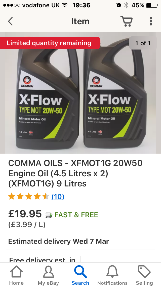

beerbeerbeerbeerbeer Posted March 2, 2018 Report Posted March 2, 2018 2 minutes ago, ianali said: No idea about the filters but oil is much cheaper than that on ebay..I pay around £12 for 5 litres. Ian. Yea, my last order was £20 for 2 x 5L of Coma.

Johny London Posted March 2, 2018 Author Report Posted March 2, 2018 Could you be specific please? Ie exact details of product and where to purchase? ta
beerbeerbeerbeerbeer Posted March 2, 2018 Report Posted March 2, 2018 (edited) 27 minutes ago, Johny London said: Could you be specific please? Ie exact details of product and where to purchase? ta 9L not 10 I've an old BMC engine this oil seems to be fine. Others may recommend alternative oils. Edited March 2, 2018 by Goliath D
Johny London Posted March 2, 2018 Author Report Posted March 2, 2018 Thanks - but this is the problem, no one does 15/40, only 20/50 (except Morris).
