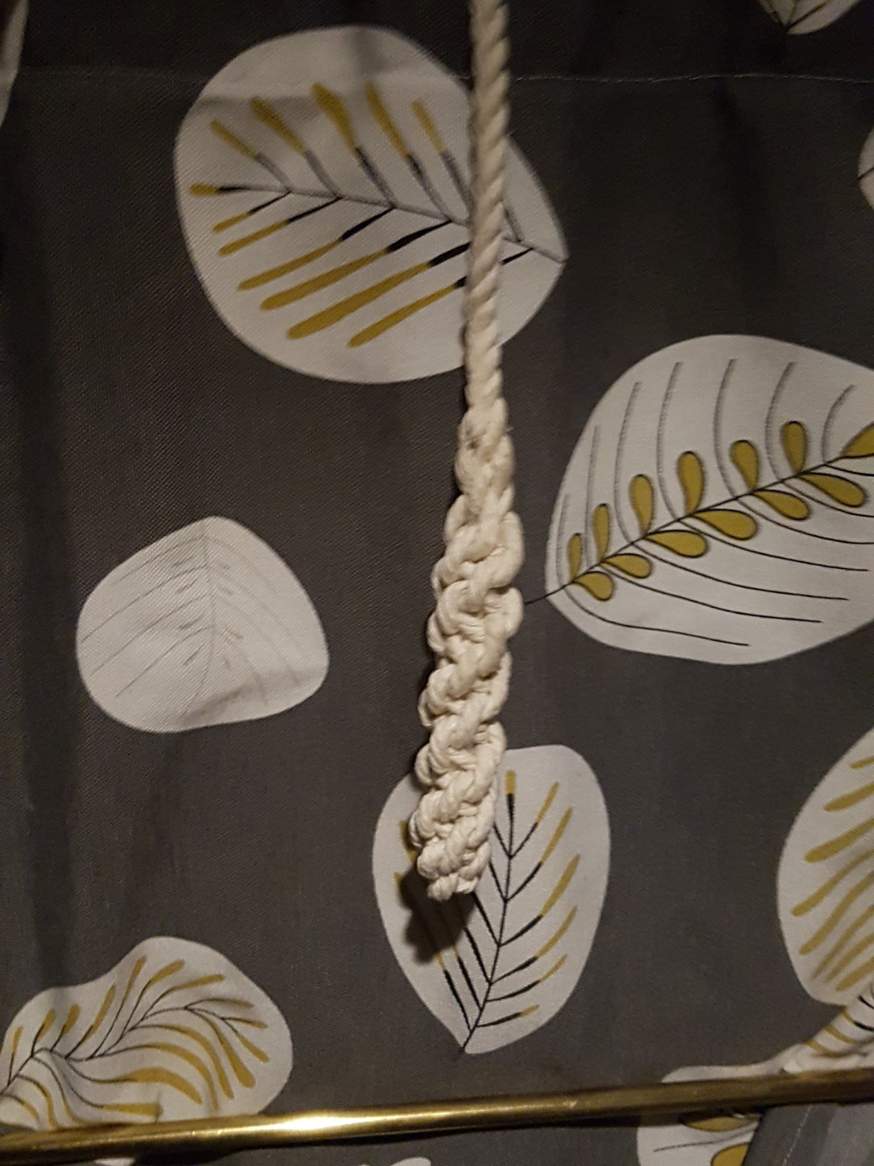

Little One Posted February 12, 2018 Report Posted February 12, 2018 Hi, Lately, I have been dabbling with rope work. I have been using Synthetic Hemp for the mats and white cotton for the Turks head. My problem is I found that when working with the white cotton that the strands which make up the 3 strands become very lose fast, which when trying to make as cabin string the crowning looks uneven and a bit messy. I ordered some White Polypropylene Rope, but this looks very plasticy. What is the best type of rope should be used for the cabin strings? It needs to be a white. Thank you in advance
dave moore Posted February 12, 2018 Report Posted February 12, 2018 White cotton line is the norm. In the past, I’ve put a temporary whipping on the end of each of the 3 strands using masking tape to stop them from unlaying. I have a source of the stuff, a supplier in the north east, happy to share if you need it. Dave 1
Little One Posted February 12, 2018 Author Report Posted February 12, 2018 Yes please, may I have the suppliers details. I wonder if the rope I was using was just bad quality. The stands just seem to unravels themselves. Even after wrapping the ends with eletrical tape. As I was crowning they just seem to be very uneven. Maybe it's something I'm doing. I'm following written instruction on how to make the side cabin string, i'v not done much rope work. What size rope would you recommend. I'v been using 8mm at the moment. Cheers - Rachel

Little One Posted February 12, 2018 Author Report Posted February 12, 2018 Will see what I can find. If I do find cabled laid I will let you know! I found it very hard to find instruction on how to make cabin strings. There is very little out there. After a week of playing with test rope tonight I worked out where I was going wrong making the cabin string. I was crowning the wrong way. Practices makes perfect. Defentily need more rope now.

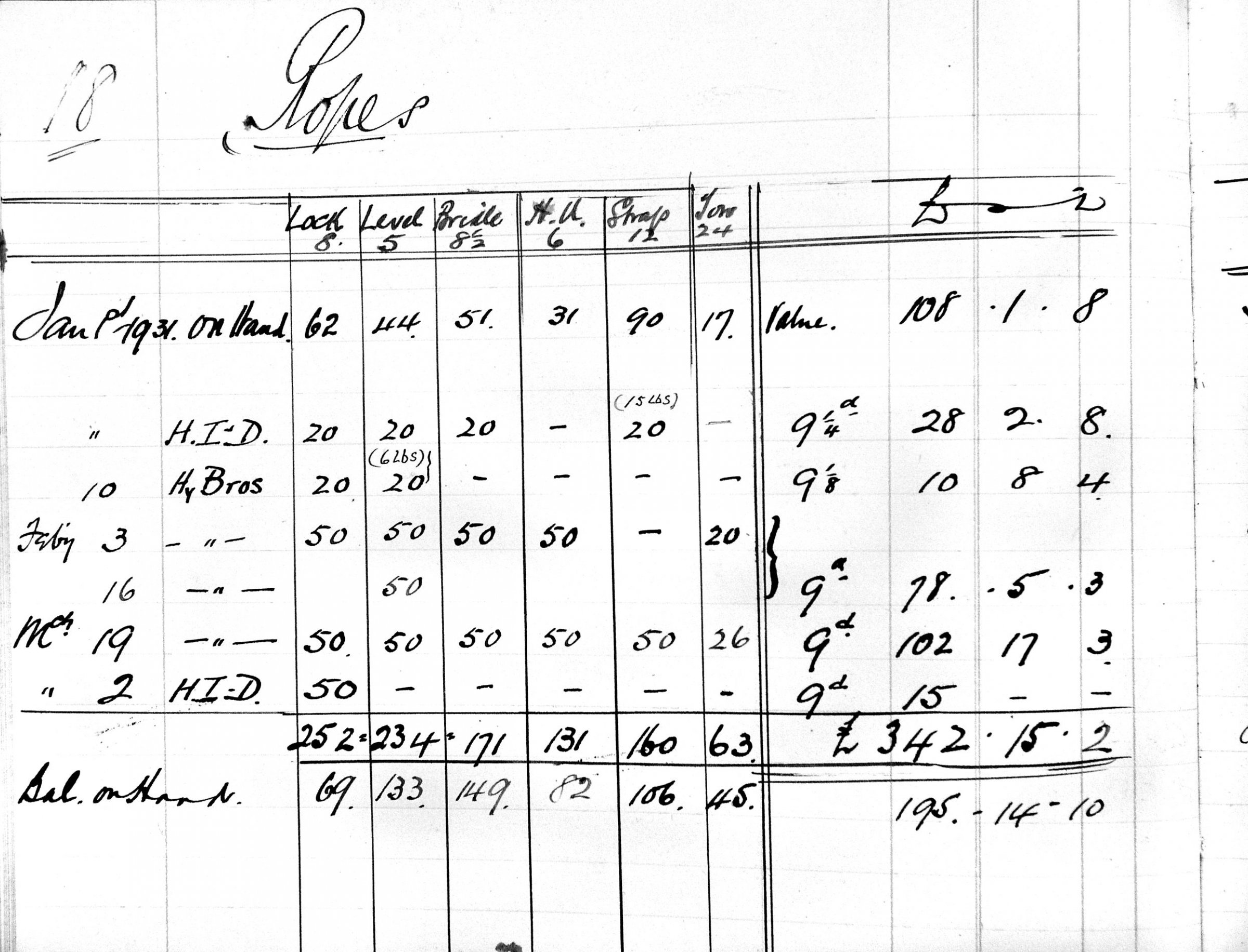

Pluto Posted February 13, 2018 Report Posted February 13, 2018 There were a wide range of cotton lines used on boats, as the list made for Lancashire Canal Transport in the 1920s shows. The following letters give some idea of length, though this varies with use. The tow line was heaviest as it was used for towing boats in the docks and across the Mersey. The amount of twist also varied with use, and those used on textile machinery, such as on mules for spinning, were probably tighter than that used on boats, though the latter would also be fairly tight. There were numerous ropewalks around Lancashire where the warp yarn left on beams after they were removed from a loom was the usual raw material. Cotton rope was used in coal mines as it did not create static, and these two uses, mining and textiles, were possibly the mainstay of the industry, with rope for canal use just a side line. 1
Little One Posted February 13, 2018 Author Report Posted February 13, 2018 5 minutes ago, Pluto said: There were a wide range of cotton lines used on boats, as the list made for Lancashire Canal Transport in the 1920s shows. The following letters give some idea of length, though this varies with use. The tow line was heaviest as it was used for towing boats in the docks and across the Mersey. The amount of twist also varied with use, and those used on textile machinery, such as on mules for spinning, were probably tighter than that used on boats, though the latter would also be fairly tight. There were numerous ropewalks around Lancashire where the warp yarn left on beams after they were removed from a loom was the usual raw material. Cotton rope was used in coal mines as it did not create static, and these two uses, mining and textiles, were possibly the mainstay of the industry, with rope for canal use just a side line. This is amazing, its very interesting too see the different lengths an thickness the used for straps and other thing. It gives an real insight to the olden days boating. It's brilliant what you can find when you start digging through archives.
