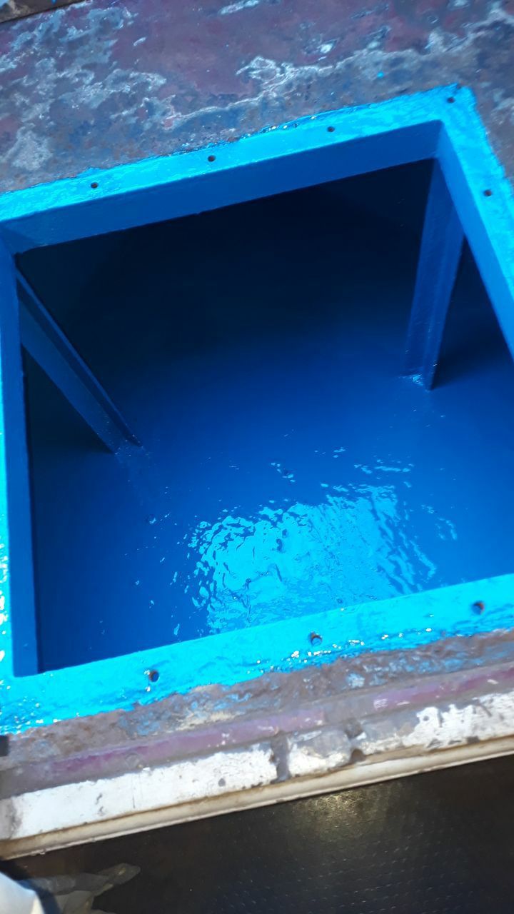

We have an integral steel fresh water tank that gues under most of the front well deck, (and forward under the gas locker).
It has a large access hatch at the front of the well deck, (bigger than many), and this is simply a square steel plate (5mm probably) which overlaps the hole by maybe 3cm all round. It is drilled and countersunk, and bolt go through into tapped holes around the side of the inspection hole.
The plate sits proud of the foredeck by it's own thickness - crude but functional!

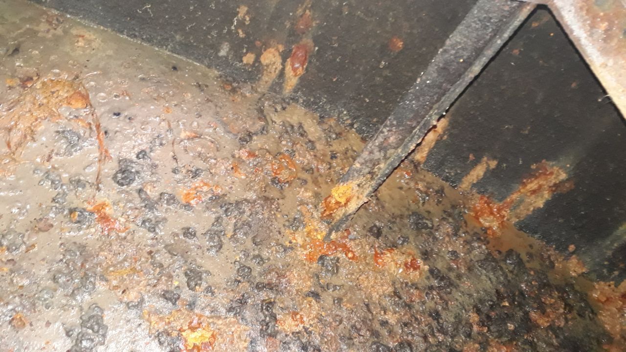

There is every evidence because of heavy pitting around both surfaces, that this has not been well sealed in the past. Our surveyour said that silicone was not an appropriate seal, and on the last opening a mastic putty like 'Glasti Cord" was used, but this was not really a success, as it is designed not to set, and hence gets squashed out by people walking on it.
I'm now not really sure what to use for the best seal, (obviously I want to keep rain and towpath muck out of my drinking water :P) .
Suggestions, please!
Alan
