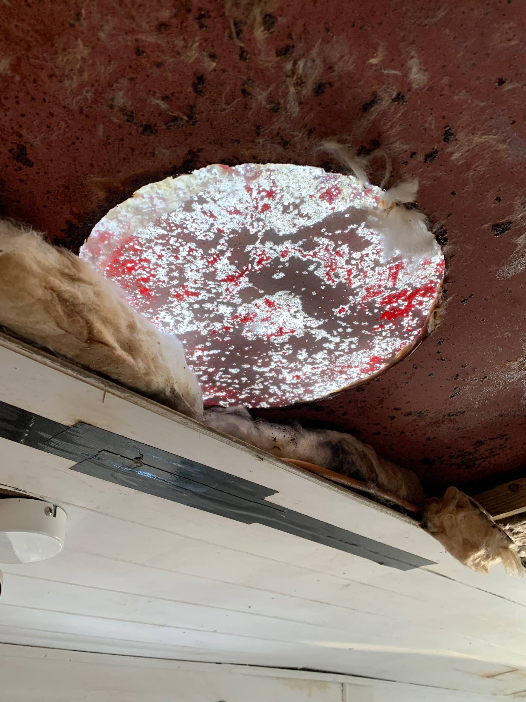

uncle nick Posted November 1, 2024 Report Posted November 1, 2024 Hi all, while working on our project narrowboat, we’ve found the three circular ‘patches’ on the roof (two 10” dia and one 8” dia) are actually Perspex that’s been painted over. Inside was boarded as if they weren’t there, apart from the fact they leak, which rather gave the game away. Can anyone recommend some sort of porthole type fitting that would look good, not hold water or leak and not be a snag hazard for the centre line? The only things I’ve managed to find so far are the yacht type hatch covers (which I’m not sure would look right) or the bull’s eye type (which are smaller, potentially a fire risk and very expensive). Or, although we like the idea of the extra light, would it be be better to just have them properly welded up flush? Thanks.

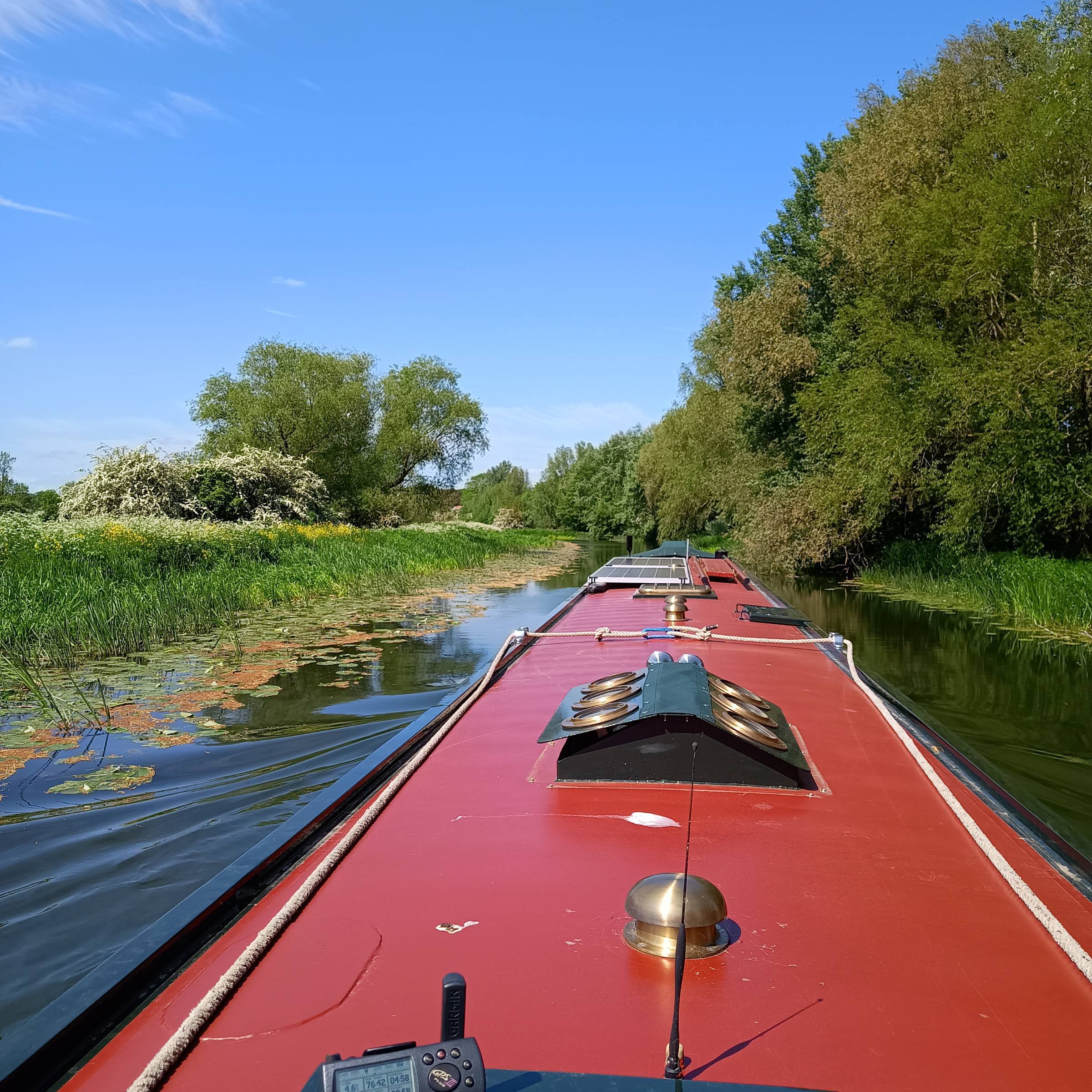

GUMPY Posted November 2, 2024 Report Posted November 2, 2024 Just get some 3mm steel panels welded to cover them. It's what I did when I removed a stove at the rear of the boat. Bottom left of the picture. 3
NB Alnwick Posted November 2, 2024 Report Posted November 2, 2024 9 minutes ago, GUMPY said: Just get some 3mm steel panels welded to cover them. It's what I did when I removed a stove at the rear of the boat. Bottom left of the picture. Best plan! Keep it simple! 2
uncle nick Posted November 2, 2024 Author Report Posted November 2, 2024 1 hour ago, GUMPY said: Just get some 3mm steel panels welded to cover them. It's what I did when I removed a stove at the rear of the boat. Bottom left of the picture. Thanks to all for the replies. We thought the panels were welded on steel until I started to remove the ceiling cladding. That’s a great pic!
magnetman Posted November 2, 2024 Report Posted November 2, 2024 It is possible these were added when the Boat was moored in a location with unsatisfactory light from the sides. Under trees or near tall buildings for example. Get more light by adding holes in the top of the cabin. Block them with pieces of wood and if your use of the vessel means you can tolerate the reduction of light from above then the answer is, as already indicated, to get 3mm steel discs welded over the holes. It is a good time of the year to experiment with daylight. 1
uncle nick Posted November 2, 2024 Author Report Posted November 2, 2024 7 minutes ago, magnetman said: It is possible these were added when the Boat was moored in a location with unsatisfactory light from the sides. Under trees or near tall buildings for example. Get more light by adding holes in the top of the cabin. Block them with pieces of wood and if your use of the vessel means you can tolerate the reduction of light from above then the answer is, as already indicated, to get 3mm steel discs welded over the holes. It is a good time of the year to experiment with daylight. Interior light isn’t too bad, or hasn’t been so far. It was still ok working inside yesterday at 4pm without artificial light, and that’s with them (badly) painted over and partially blocked by cladding. Plating over does seem the sensible option.

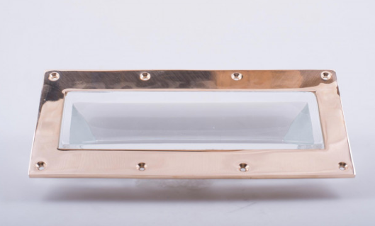

ditchcrawler Posted Friday at 13:51 Report Posted Friday at 13:51 14 hours ago, uncle nick said: I’m not sure exactly what a roof prism is, I’ll have to have a Google. Not sure a little extra light would be worth more drafts No drafts its fully sealed just like a bullseye Davey and Co. Deck Prism/Light Rabetted | Captain Watts Chandlery
uncle nick Posted Friday at 19:55 Author Report Posted Friday at 19:55 6 hours ago, ditchcrawler said: No drafts its fully sealed just like a bullseye Davey and Co. Deck Prism/Light Rabetted | Captain Watts Chandlery Thanks for that. I’m guessing it points upwards? It’s definitely looking like I’m going to need a plate to cover the existing holes, then find something to fit into the new plates.

uncle nick Posted Friday at 20:23 Author Report Posted Friday at 20:23 Thanks for the link. I’m not sure how that would look on a narrowboat. That’s what I meant by yacht fittings, though that is clearly disrespectful to yachties! 🙄
Covfefe Posted Friday at 20:33 Report Posted Friday at 20:33 6 hours ago, ditchcrawler said: No drafts its fully sealed just like a bullseye Davey and Co. Deck Prism/Light Rabetted | Captain Watts Chandlery This looks very much like what I had, and there was no thermal break so it’s used to suffer from lots of condensation in winter.
