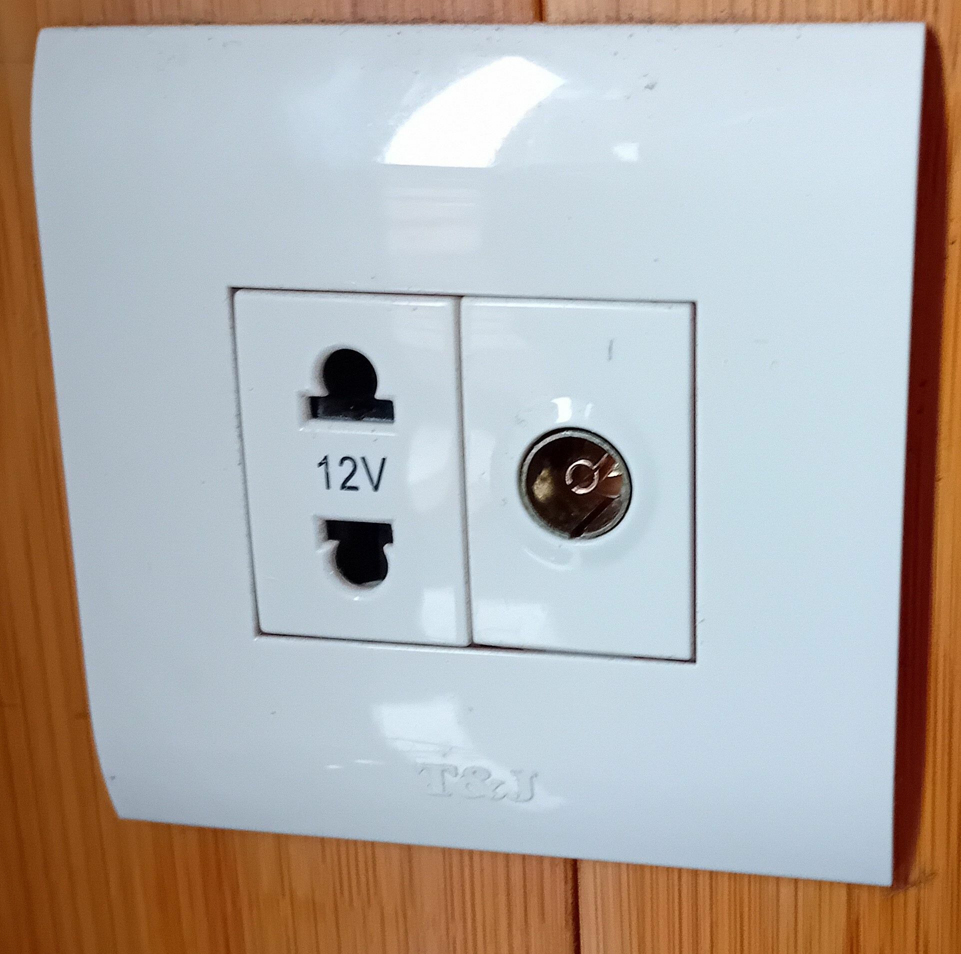

Hi,
I've just purchased a 2007 narrowboat that has 2 round pin 2v sockets. Has anyone come across these before and can point me to corresponding plugs. Also, what type of 12v socket is now standard?
Thanks
Stu

Very common on caravans at one time. I've fitted them in the past. That one is obviously to supply a 12v TV.
You may still be able to get the correct plug from a caravan accessory place or eBay.

There is no standard. The car accessory style plug/socket is common, though they are limited in current carrying capacity without melting. Various two and three pin mains styles are repurposed by some. Important that a 12V plug cannot fit in any mains socket on the boat and visa versa.

depends @truckcab79 most 'boat stuff' like fridges  or pumps come with bare wires or connectors for your bare ended wires. most 'Car accessory' stuff like laptop chargers will most times have 'cigarette lighter' type plugs which you can either use (not very reliable) or cut off and fit your own.  of course a lot of stuff comes with USB charging these days so having some USB charging points is probably increasingly worthwhile.
if i was starting from scratch i would use round pin mains plugs and sockets (2A/5A) for anything 'portable' (and 12V) as they are readily available, properly designed and economically priced.

2 pin BS546 plug
Are they not only three not two pin though??

Another one worth considering if building from scratch is Hella plugs and sockets. They are quite good, very low profile and impossible to mistake for something else.
I once had a narrow boat where the 12v cabin accessory sockets were Square pin 13a domestic type. On the 12v circuit! Nuts !
5A looks quite nice in boats. 2A is a bit fiddly.

Unless I'm missing something a plug to fit that socket can go in either of 2 ways around.
If you are connecting something where polarity is important it looks like you could easily end up with positive connected to negative, and negative connected to positive.
If polarity is the wrong way around then you could end up destroying the equipment involved, unless it has circuitry to guard against wrong polarity.

True. But still very common in older 12v systems in caravans which looks like where that originates. I can't recall us ever having an issue as we used them a lot 'back in the day' for our telly's.
You don't see them any longer as modern caravans tend to use the cigarette lighter type sockets for 12v, unless an owner has carried out a mod to fit or add one.
The pin spacing is different between the 3 and the 2 pin BS546 plugs, the 2 pins are slightly closer together.
I have a technique for using 13A plugs for low voltage that works and is fail save, I picked it up from a serious old boater, perhaps he built your boat?
3 hours ago, Tracy D'arth said:
That socket will accept a 2 pin BS546 plug, a european Schuko plug or an American style 2 pin flat blade plug.
The blades are not the same size on the caravan sockets so USA plugs may not fit properly.
You are🤔 The flat blades on the caravan plug are different widths so cannot be reversed
Edited by GUMPY
Of course if one did want to use square pin 13A plugs and sockets you could just use the earth pin for the negative.

27 minutes ago, M_JG said:
Ah yes. That takes me back 40 years!
Not that long, my 2001 Sterling Europa had Clipsal sockets as standard fitment.

I understand that the present US recommendation is for one pin to be larger than the other to provide their 2 pin plugs with  polarisation, but all of the ones I have come across fitted to imported equipment manufactured in the Far East,  have had two identical pins.
Yes, there's no standard and most of the options have problems.
Mine came with a couple of cigarette lighter sockets and a fair fitout of W4 sockets.
The cig lighter is IMO a horrible plug. It has minimal wiggle-out protection and so it's prone to come loose, then it can just switch off or worse overheat at the slack contact. We don't use the hot element (actual cig lighter) part any more, so why use the rest of the form factor?

The W4 isn't bad, and can carry more current. Mine claim to be rated for 10A, and when new they're probably good for that. The springs can get loose over time and then maybe they'll overheat at 10A also? I would rather not find out because nothing in the design prevents an overheat running away to fire. Also I didn't want to set out out with a whole new kit of four-ways and extension cables in a new standard.
Anyway is it practical to draw more than 5A on a 12V socket. a) I have very few devices that would try, and b) unless the cable was chosen with that in mind then voltage drop stop a heavy-current device working properly.
Therefore I concluded that the assortment of lower power 12V devices I have can run off 2.1mm barrel connectors, for which the CCTV industry provides cheap connectors. Be sure to have a insulated tip on the inner positive, and if buying pigtail connectors check the cable size - some are really thin cheap junk.
