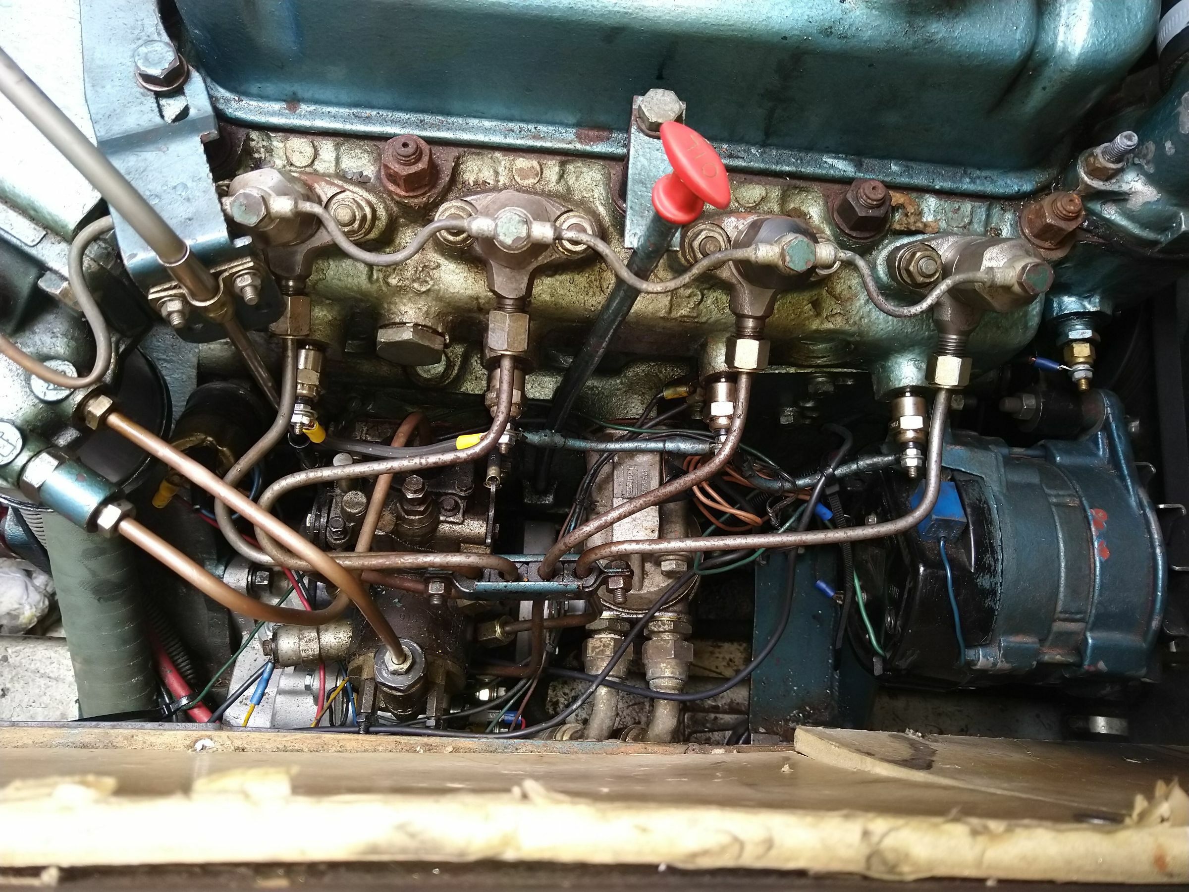

Picture of engine attached for what it's worth.
I notice that the injectors are a motly crew. One and two appear to be identical, three looks aftermarket and four has a longer thread on the fuel supply neck so obviously different again.

It's not just the injectors. Look at the nuts on the delivery pipes. They vary in depth too. One and two are the same but three and four are different It's not as though the engine is an old nail. It hasn't done a lot of hours.

I had a brainwave at this point and decided to feel the injectors. The engine wasn't anywhere near normal running temperature but I am sure that the suspect cylinder is number 4. The injector body of number 4 was cooler than the other three.
I've looked at the high pressure pipes and can't see any evidence of diesel weeping. Annoyingly, number four's pipe comes out of the pump underneath the pump body so difficult to see even with a mirror.
I shall return with appropriate tools on Wednesday. I measured the crankshaft pulley nut as 1 1/4 AF. Is that correct? I have a suitable socket and bar breaker so should be able to turn the engine over OK.
The thread on the front injector does indeed look longer but it also looks like quite a coarse thread. Don't suppose it could be a different thread and thus giving rise to all sorts of problems could it?
