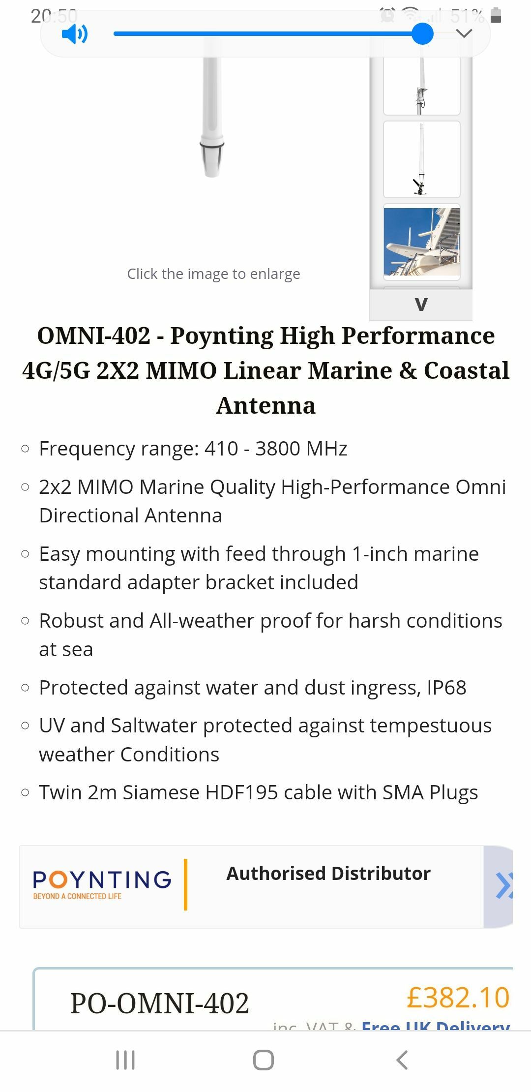

I on 3, have a Huawei 525, and use a Poynting aeriel, cant remember which model(and I'm not going outside to find out as its filthy again out there).
We have had faultless service for 3 years now, in lots of locations, it streams Netflix and Amazon with no buffering. It even worked up the Welford arm, which surprised me.

Be careful the 3  5g routers as they only have sockets for 5g aerials not 4g. So you will either have to add them or struggle when there is no 5g signal*. Also with new 3 contracts you don't own the router its only on loan from 3 and has to be sent back after use.

The Three 5G routers have 4 external antenna connectors -- which cover both 4G and 5G -- and they all need connecting. The routers can be bought secondhand off Ebay for £170, they're unlocked so you can use any SIM including Smarty and Scancom.

Interesting, my ex three 5g router only has two sockets and destructions say they are 5g. Hence my comment.
I guess they have changed the model they supply.

Yes they have, new one is a Zyxel NR5103E 🙂
