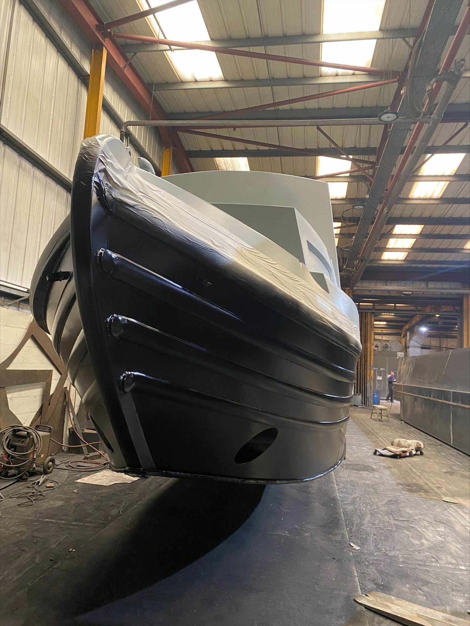

magnetman Posted February 22, 2023 Report Posted February 22, 2023 Not a narrow but this is one way of doing it (my country estate boat when I bought it 14 yars ago) Β 9ft beam so one can afford to have the chines. I expect it would take out too much internal space on a narrow but it has been done I believe on certain craft.Β Β Does get a bit of water to the prop.Β Β Β
