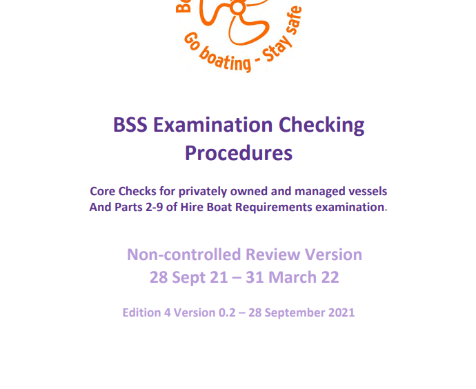

Moke Posted February 4, 2023 Report Posted February 4, 2023 A thought struck me this afternoon, so I thought I’d ask for advice here. I’m not entirely sure what a BSS examination is for, that is, what do they check? If I had an unpowered butty with no electrics (save a bilge pump) and no gas, water, anything really. Just an empty shell for carrying stuff would it need a BSS ?
Alan de Enfield Posted February 4, 2023 Report Posted February 4, 2023 1 minute ago, Moke said: A thought struck me this afternoon, so I thought I’d ask for advice here. I’m not entirely sure what a BSS examination is for, that is, what do they check? If I had an unpowered butty with no electrics (save a bilge pump) and no gas, water, anything really. Just an empty shell for carrying stuff would it need a BSS ? If it has an enclosed cabin - yes. Here is the check list : Sorry cxannot post it - it is too large for the forum. If you check on the BSS website everything is listed there. This is what it looks like :
alan_fincher Posted February 4, 2023 Report Posted February 4, 2023 10 minutes ago, Alan de Enfield said: If it has an enclosed cabin - yes. Here is the check list : Sorry cxannot post it - it is too large for the forum. If you check on the BSS website everything is listed there. This is what it looks like : If it is as described by OP, what could it actually fail on?
rusty69 Posted February 4, 2023 Report Posted February 4, 2023 (edited) No CO alarms. No fire extinguishers . Also, something would need to power the bilge pump, even if it was the sun. Edited February 4, 2023 by rusty69
Moke Posted February 4, 2023 Author Report Posted February 4, 2023 That what I was wondering. But now I’ve got something to entertain myself…..wading through the BSS paperwork Mr de Enfield has pointed me at
Alan de Enfield Posted February 4, 2023 Report Posted February 4, 2023 (edited) 12 minutes ago, alan_fincher said: If it is as described by OP, what could it actually fail on? It is listed as one of the criteria that is required for a boat to be BSS exempt Edited February 4, 2023 by Alan de Enfield
Moke Posted February 4, 2023 Author Report Posted February 4, 2023 Nav lights!! It’ll need those (bugger)
Alan de Enfield Posted February 4, 2023 Report Posted February 4, 2023 (edited) From the BSS website ; Does this help : On most waterways, a BSS Examination is not required in respect of any privately owned, open vessel (i.e. a vessel in which all the accommodation is completely open to the elements) if it has no domestic cooking, heating, refrigerating or lighting appliances installed and it is propelled solely by an outboard engine. Please ask the navigation or harbour authority that will be licensing or registering your boat, as it sets the terms and conditions of that registration. The rules are likely to be different if the boat is in commercial, community or other public use, or is a workboat. Ask the navigation or harbour authority for more detail about the operating terms and conditions including BSS Certification. If you are 'carrying stuff' then are you commercial ? Edited February 4, 2023 by Alan de Enfield

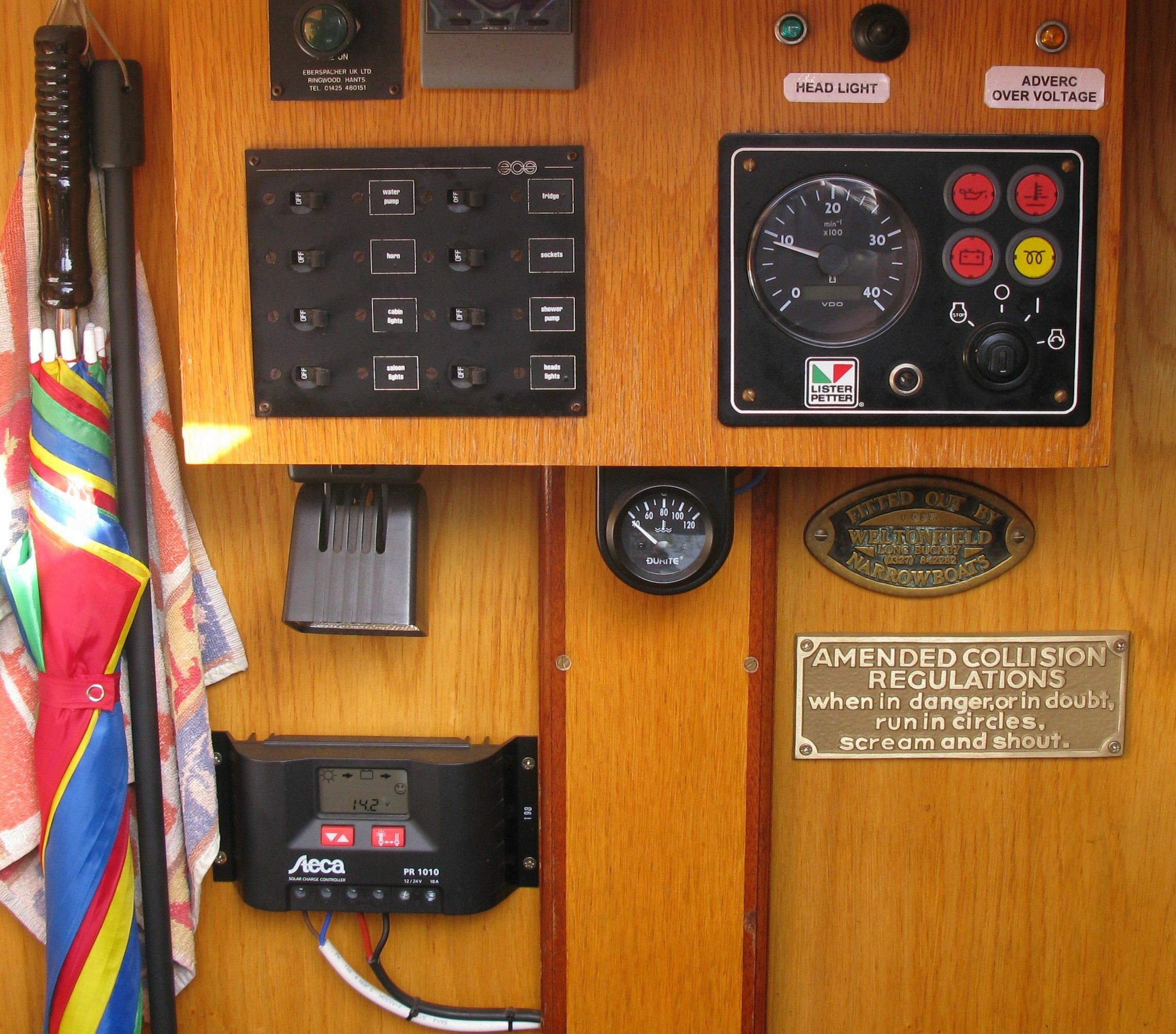

BEngo Posted February 4, 2023 Report Posted February 4, 2023 Ancient Rule of the Road (aka COLREGS) aphorisms: Green to green and red to red, perfect safety, go ahead If two lights you see ahead, turn to starboard, show your red. The naval version: If two lights you see in front, Full Ahead and ram the c... If in danger or in doubt, run in circles, scream and shout N 1
Alan de Enfield Posted February 4, 2023 Report Posted February 4, 2023 11 minutes ago, BEngo said: If in danger or in doubt, run in circles, scream and shout That was the instruction at the helm on one of my NBs
