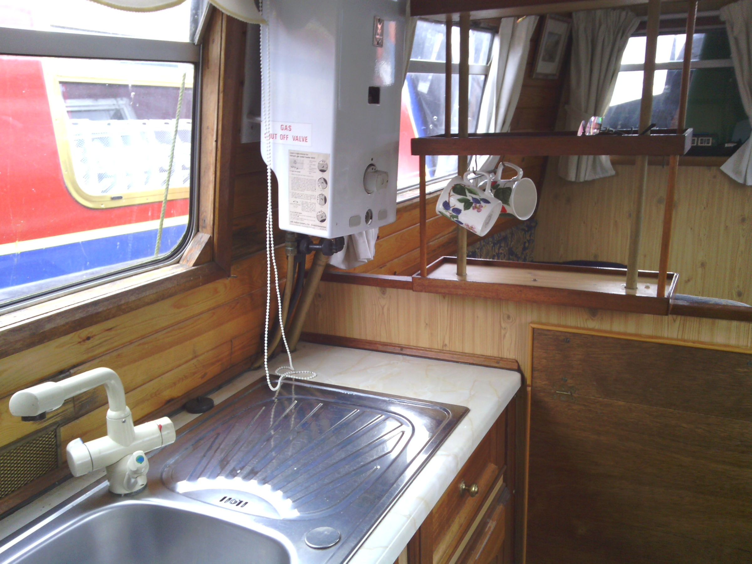

On one of our boats the shower was fed directly from the Vailant 'instanaeous gas water heater'
Worked fine.
