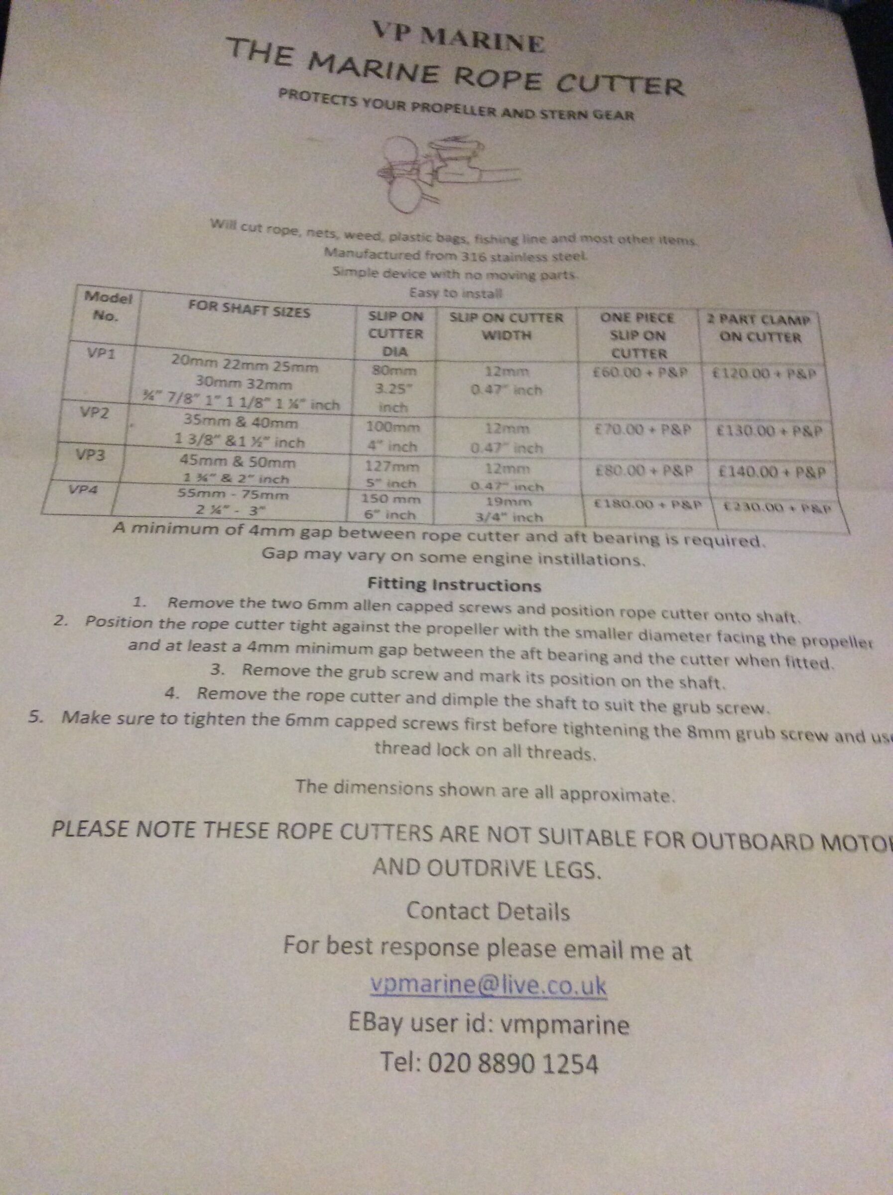

1 hour ago, cuthound said:
Yup that's the one. It came with my boat and at first I thought it was a gimmick, but 9 years later and only one prop foul that required me to intervene has changed my mind.
Just fitted a similar one this year. (eBay lot cheaper very similar spec) so far been a great improvement.
3 hours ago, tree monkey said:
I probably could tbh, never considered it
Never had a tyre on your propeller :(
Am considering some sort of device like this. Its not for ropes and general man made rubbish but the weed that is a real problem, we can struggle into a lock, clear the weed, move out of the lock and before we have done a couple of boats lengths the prop is a spinning ball of weed and the boat can barely move itself. The more weed there is the less boats, the less boats the clearer the water, the clearer the water the more light = more weed and the warmer the water the more weed. This is a real problem on the smaller French canals but could well be the same on the UK system soon. It's terrible stuff.
That was my first thought. Quite happy removing rare tarps and coats myself, and at least you tend to know about it instantly.
Weed on the other hand builds up slowly on the prop (generally in areas where you're going slowly anyway so it's less noticeable) and in extreme cases (Middle Level in late summer) you can find yourself down there five times in a mile removing duckweed that keeps slowing you down. Something that shredded most of that would be very handy...
On a vaguely related note- whilst perusing the 'brolly-mate' device, I came across this from the same company:
https://www.miracleleisureproducts.co.uk/prop-mate-p717.html
I haven't yet got one but I'm going to, more for winter really.
My thinking is that you can use the 'prop-mate' device to cut up and loosen anything that's fouling the prop, and thus minimise the amount of time that your arm and hand must spend in the cold water.
Even with my full-length arm glove on, it got very uncomfortable after a few minutes of my hand in the freezing water, trying to pull away the rubbish from the prop after it was fouled last january.

I have one and guess what, never had to use it since purchase. A quick blip of reverse works for me.  Been lucky so far.
On a general note if you buy one they will need a good sharpening as they are delivered pretty blunt. Heath and Safety rears it's head again, can't trust an adult with a sharp object 😆🤣
Never found them any use at all on a canal boat.  Seen a couple and they had been knocked back by rubbish in the cut, now useless.
