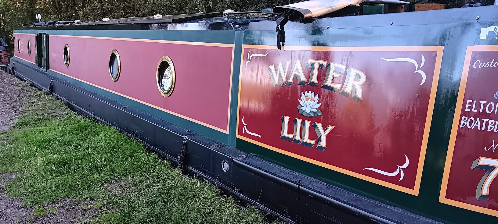

Have applied some Polytrol to one side of my boat. I have a mainly red coloured boat and the sun's UV has got to it since it was painted by the previous owners in 2017 and, although I have used polish on it previously, I thought it could look a bit better.
The pictures below are of the same area before applying the Polytrol and after application using a cloth. I did not use a cloth to rub it off after 15 or so minutes and was left slight streaks but nothing major. The weather was hot, my arms were aching and I could not be bothered to polish it off. No comments on my stance nor of the banana growing out of my hand!

Two more pictures showing areas pre and post use of Owatrol Polytrol.

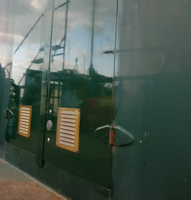

Polytrol tried out on a friend's wide beam, looks good, but he is going to repaint it after seven years of contact sport cc'ing in London.

1 hour ago, Mike Tee said:
^^^ and is this the result of a thin coating rubbed off almost immediately? Looks good.
Lots of products do that, some with more effort than others - how long it lasts is what counts.
Its done a year on mine with good results,  i am thinking of giving it another coat when it cools down a bit
Yes, they were given some to try, just a quick coat to see if it worked.  The boat has some battle scars, and they have decided to repaint.  It looks good but being lazy, I would patch the rusty bits and Polytrol the rest and see how it lasted. Maybe get another year before it needs repainting.  The cost of a lift out, comes into it, though. The Polytrol can be applied when in the water, so perhaps a maintenance coat, now and again, would work, as would the application of a wax polish.

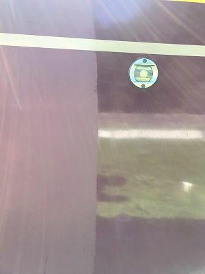

OK, didn't have too much time and learnt a few bits!  You can see how far i got. Its a little smeary as i discovered that that it absolutely must be wiped off before it goes tacky - about 10-15 mins (which i didn't do here). Whilst not 100% (yet!) you can see its better than nothing at all.... will continue!!
