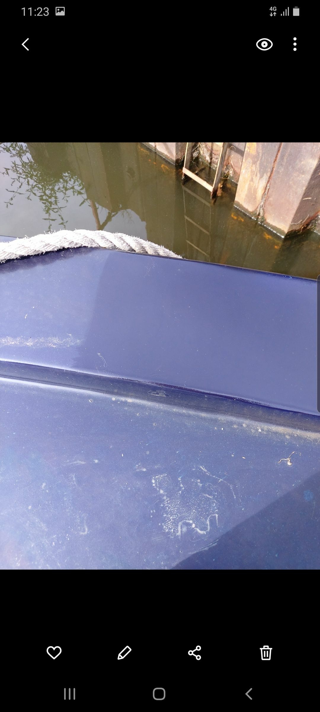

On 05/08/2022 at 11:12, peterboat said:
I have cream lines on my boat they look just the same, I honestly cant believe the difference in the paint, I would take a picture to show you but I dropped my phone off the wheelhouse roof yesterday and the screen is knackered, I still have the bow to do, so when Jayne brings my other fone I will wipe a section over to show you the difference
You need to tell Jayne to hurry up with that other phone...

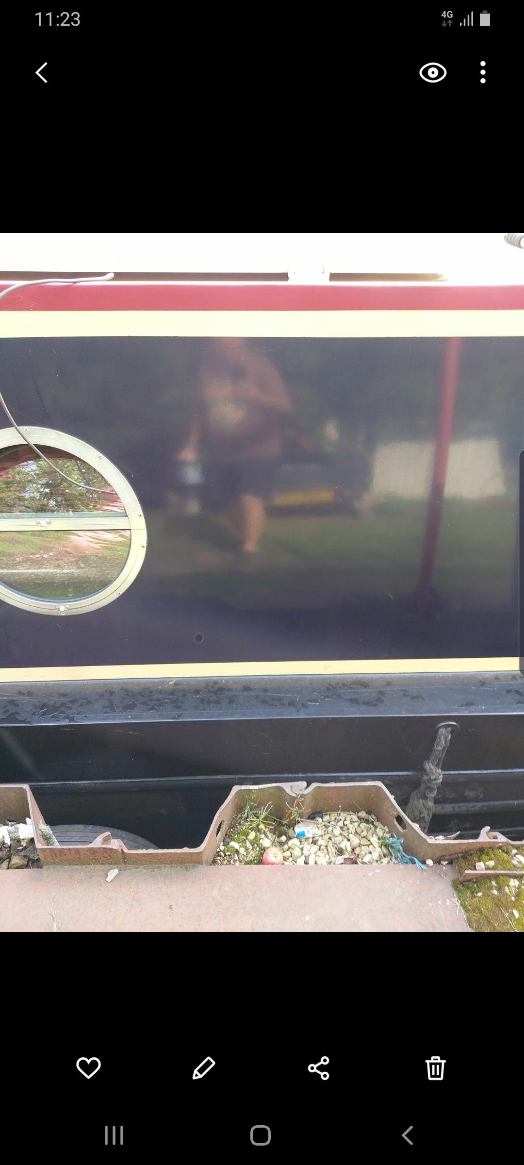

Hey, that looks pretty good! So the cabin side has been done over 3 months? That beats the 6 weeks I've had before my polish and waxing efforts are no longer in evidence, and the cream hasn't discoloured either.
Thanks for the update (and congrats on the new phone)! :D
Samsung Galaxy A90 lovely phone which can do things I don't want it to do!
I think I did the owatrol in late June and its been hot and sunny since then!
