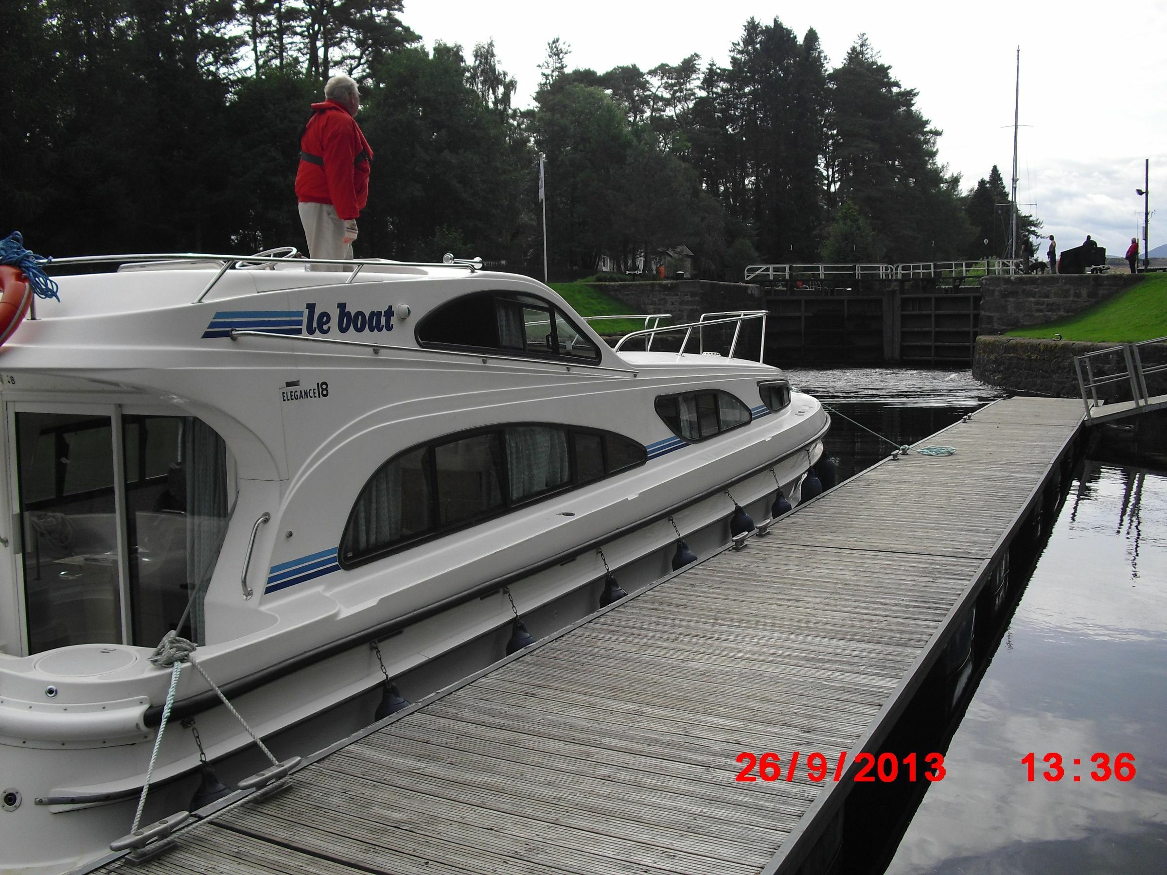

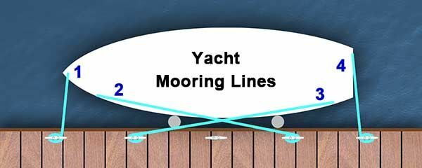

Moor your cruiser with the bow into the current and pull the stern in - add spring lines (2 & 3 in the picture) and nothing will move the boat.
Using this method we are quite safe where we have a difference between high water and low water of up to 10 feet without having to adjust the lines.
The best way to get to the bank is to have a person in the bow, approach the bank at about 45 degrees, once within a couple of feet of the bank the person in the bow lasso's the bollard or hooks thru the mooring ring, brings the line back to the forward cleat and loosely ties it off.
The helm then drives slowly forward against the bow line this brings the stern in and whilst the bow line is tight step off with the stern line (or lasso the bollard / ring) and bring it back and tie off onto the boat,
The boat we hired on the Caledonian canal did not have a centre cleat but just moor up as above.
Of all the cruisers we hired over the years there was only one had a centre cleat and that was Crapi in Brittany.
