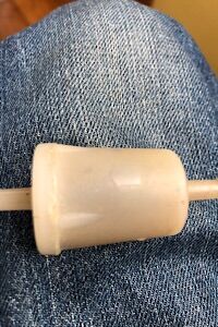

Are the little plastic Webasto filters allowed under BSS? I replaced mine with an alloy bodied fuel filter and I don’t think the pump has the guts to pull through it.
I still have the old one.
There would be a lot of air in that to pull out
