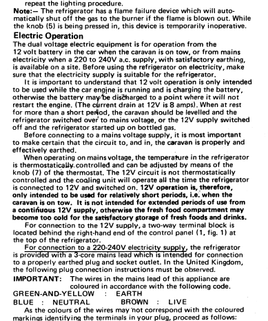

Generally the 3-way fridges are not thermostatically controlled (on the 12v side) and will have a continuous current draw. This is why the manufacturers (Electrolux) actually said in their owners manual to turn the fridge off if parking in the motorway services (obviously a caravan and not a boat)
Yes. That's why l don't run it directly from 12v.

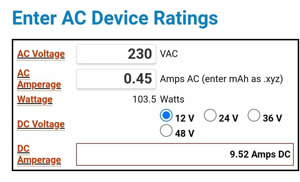

Most of the A rated mini tabletop fridges on Amazon are quoting AC rated current of around 0.45 amps.
If I convert that to DC I get the following result which isn't that different from what I'm getting from my "appalling" 3 way fridge run on mains through the inverter. What am I doing wrong? I don't want to get rid of my 3 way fridge and replace it with something that's only going to provide marginal benefits.
