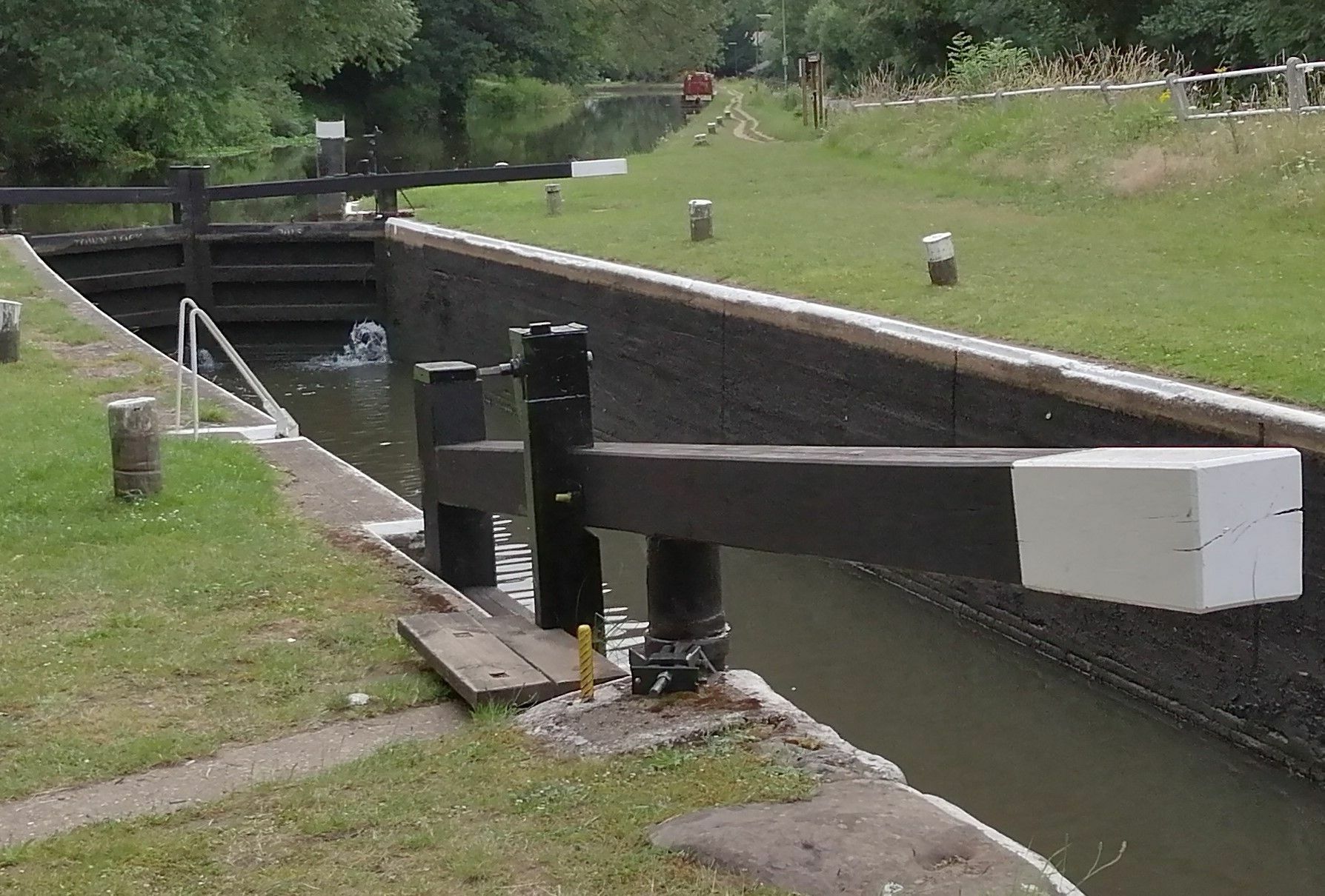

Ken X Posted October 20, 2023 Report Posted October 20, 2023 1 hour ago, system 4-50 said: As one of the un-initiated(?) can somebody supply a pic and provide a copy of the user manual? This is the best I could find. Weybridge lock on the Wey. The hold back pin is the yellow pin just by the gate top strap. 1
magnetman Posted October 21, 2023 Report Posted October 21, 2023 (edited) 10 hours ago, nicknorman said: Yes, but the forward suction is fierce and there is mostly just a gate paddle which you don’t want to get too close to! GU locks don’t have the same degree of forward suction. True. I have done the Wey several times and no I haven't used the pins. Boat kept further back and bow tied to a bollard. However I have not been on the Wey in a full length boat. One might use them if the boat filled the lock. 8 hours ago, Ken X said: This is the best I could find. Weybridge lock on the Wey. The hold back pin is the yellow pin just by the gate top strap. That is by the bottom gate. I was referring to the pins by the top gates on GU locks. The GU lock hold back pins were supposedly used to keep the butty back and prevent it going forwards into the closed gate presumably to help with single gate exiting of locks. The butty steerer could then flick the rope orf the pin when needed. I don't know if this is what they were for but they were by the top gate anchors. The yellow one on the river Wey by the bottom gate seems to be newer and possibly for the opposite use ie to stop barge going forwards in lock as it is filling. . Edited October 21, 2023 by magnetman
Ken X Posted October 21, 2023 Report Posted October 21, 2023 Its interesting looking at these things. The pins are fitted to most, if not all, locks on the Wey and definitely help by preventing the boat surging forward and then across the lock when filling by use in conjunction with a bow line. If the bow catches the flow from the top paddles it really chucks it sideways very quickly and thumps it into the far lock side. I have seen it catch a crew member in the bow of a boat dozing and and rip the bow line through their hands. I have no idea whether these new pins replaced older pins or bollards but they have been there several years and I was warned to use them when first on the Wey years ago.
magnetman Posted October 21, 2023 Report Posted October 21, 2023 (edited) It looks like the hold back pins on the GU (by the top gates) have mostly been removed. Scanning streetview I found this one at lock 66 which I think has been cut short. They were about 2 inches high and slightly angled so you could throw an eye over easily. This is by the top gates. The river Wey yellow pins seem to be made of rebar and set in cement. I wonder if these pins were put in because people tended to use the gates for the purpose of holding the boat which then caused damage to the gates. Marsworth flight seems to have some pins still. They seem shorter. I wonder if elfin safety said they were risky. Edited October 21, 2023 by magnetman
