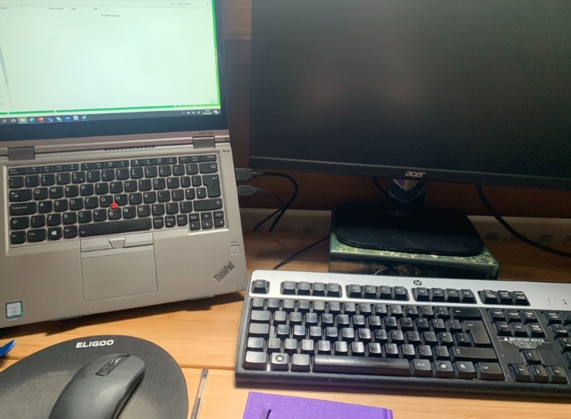

doratheexplorer Posted April 30, 2021 Report Posted April 30, 2021 It’s really not as scary and complicated as most here make out. Here’s my WFH set up. I have 3 110ah batteries and 525w of solar. This covers most of my power needs from March to October. Occasionally I run a genny in the morning to top up. In winter, Nov-Feb, genny running becomes about 2-3 hours each morning. Or go into a marina for a bit and hook up. On 29/04/2021 at 11:52, Tony Brooks said: One potential issue no one seems to have addressed is the fact there are black spots all over the canal system for mobile internet reception. To a degree this can be addressed by having a Receiver that can take two companies SIMs so if one has no signal the other may well do. As at example 3 reception around the Blue Lias (Stockton) I find iffy. It does not matter so much for leisure used but work may have a different view. This sort of thing is a non issue for continuous cruisers. When I'm about to moor up, i check my phone signal. If it's poor, I carry on a bit further. 2
