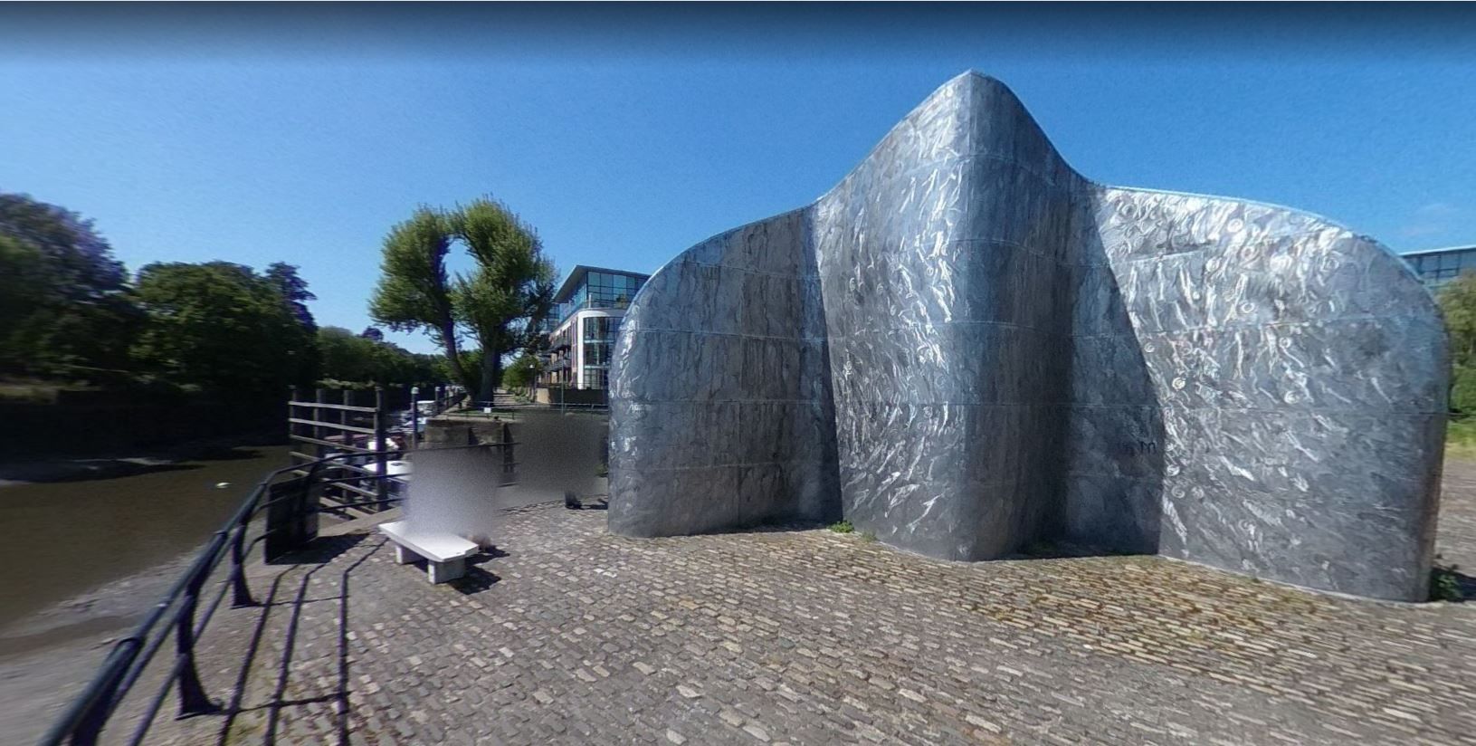

I always say this...... don't miss the 'effing turn at Brentford. It's not well defined. Luckily Google Earth or Street View covers that bit of Thames so you can do it virtually. Look for the stainless piece of art on the bank for the  handy "where to turn" marker.
Enjoy, lovely bit of river. Watch out for floating dead sheep, logs etc.

Yeah I've been looking at various sites and videos to scope out that turn. When would you recommend one starts turning, when level with the entrance to Brentford Dock Marina?
Many thanks for all the advice

That sounds about right for turning. It all depends on the strength of the outbound current. I would slow right down before you get to Brentford Dock marina, ideally just drift with the boat stationary in the water, so you can judge the speed of the current. Then apply power to make a 180 degree turn to the left so you are facing upstream, and then if necessary let the current carry you backwards a bit until you are level with the entrance to the creek. It's better to turn too early rather than too late - adjusting for the former is much easier than the latter.
Then apply a bit of power until you stop moving over the ground, and  you can steer slightly to the right (what is called a ferry glide) and you will then move sideways across the north half of the river. You don't want to cut the corner too tight just in case there is something coming out of the creek.
Hope that makes sense!
