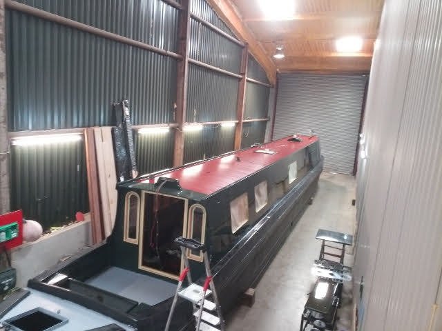

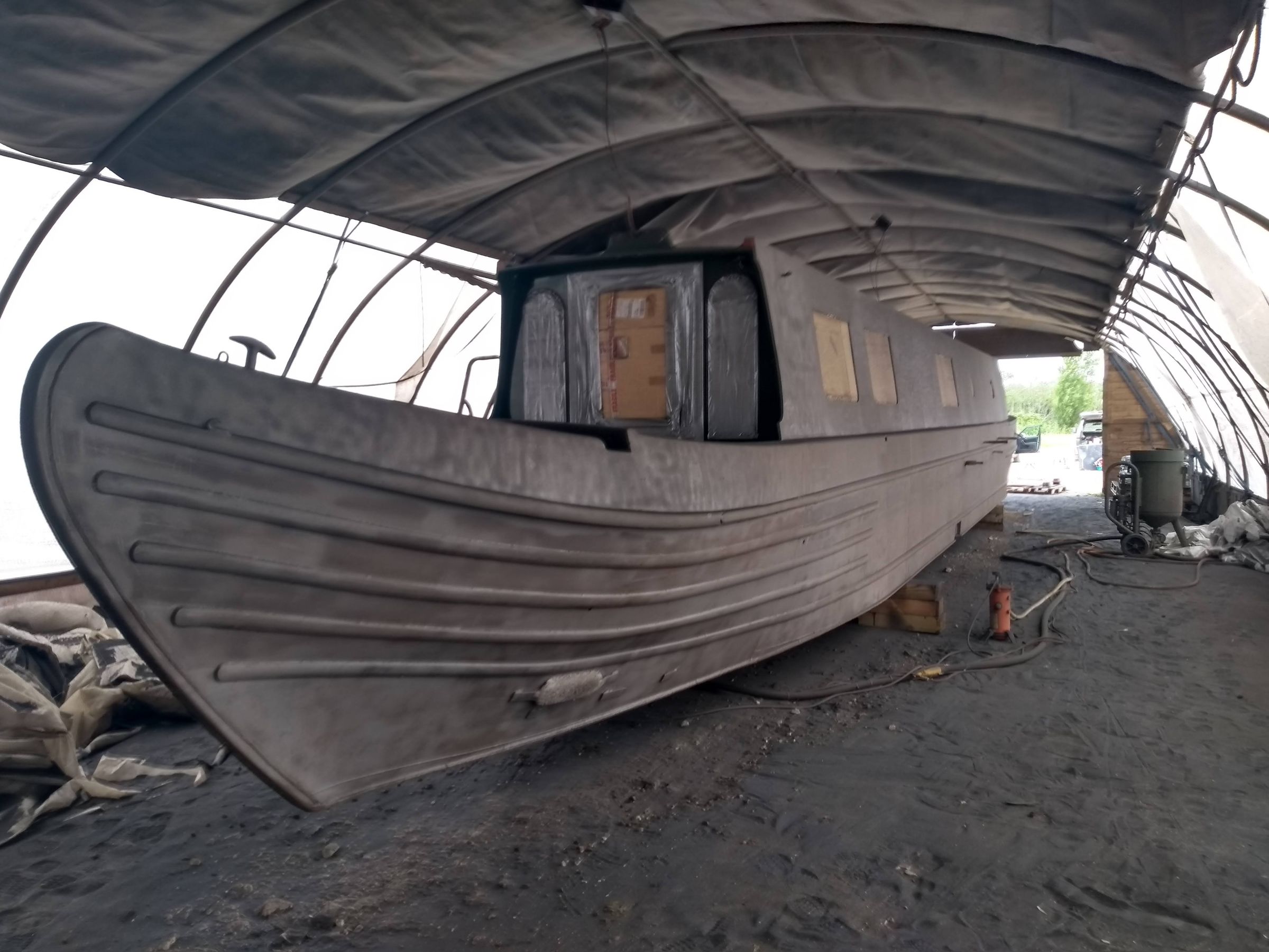

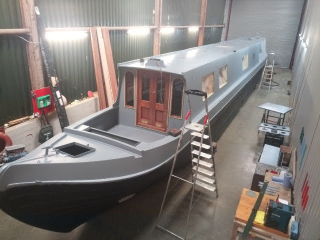

Some before, during and after pictures would be great too, if you get chance.
