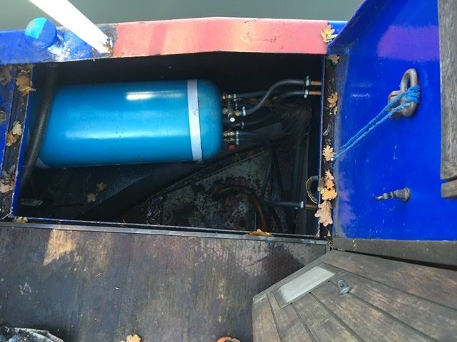

Strettonman Posted November 4, 2020 Report Posted November 4, 2020 My calorifier is in the engine bay and I’m considering how to add additional lagging. I’ve seen posts about adding jackets and wrapping in celotex sheets but was also considering creating some sort of cylindrical frame and using expanding insulation foam and wrapping the cylinder in aluminium foil. The foil would not only reflect back the heat but also enable me to get the foam off the cylinder if it all goes horribly wrong ?. any ideas on which gives the best insulation per inch of thickness as space is at a premium.

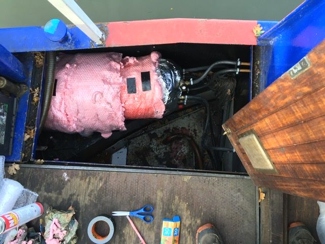

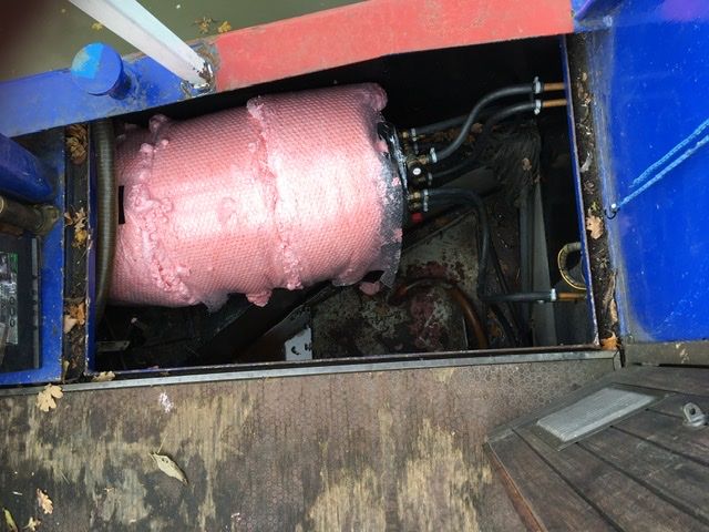

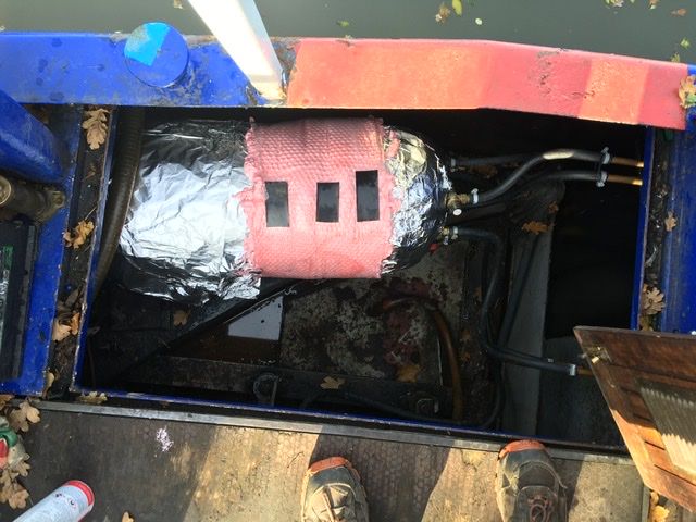

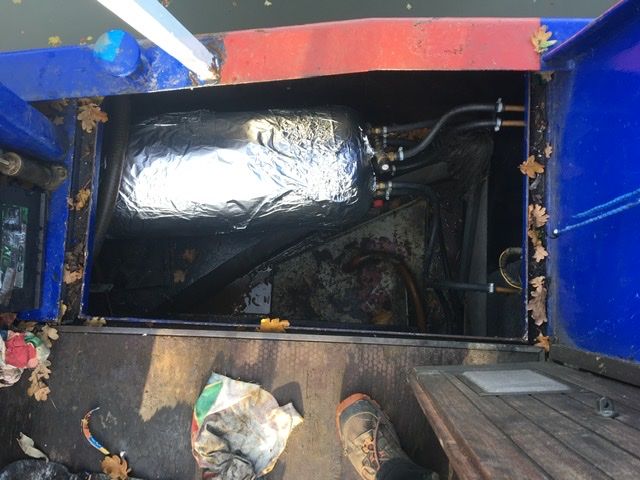

Strettonman Posted November 14, 2020 Author Report Posted November 14, 2020 Not sure anyone is really interested but here is my attempt so far. I lined the foam covered calorifier with tin foil and then built up 2 sections of slight loose bubble wrap and injected fire retardant foam to create about a 1” layer. Once (sort of) set I put on 3 sections of very loose bubble wrap to create a second layer another couple of inches thick. I’d ordered 1m wide bubble wrap but it was out of stock so they gave me several 30cm wide rolls. This was actually better for getting the foam in. the only problem is it is taking days for the foam to set as the air can’t get to it. next step will be cover it with foil backed laminate underlay and then sort the plumbing end and lag the inlet and outlet pipes. I’ll certainly be shutting off and opening taps as a matter of routine over the winter and may even do a partial drain down if i need to leave it when it is really cold.
