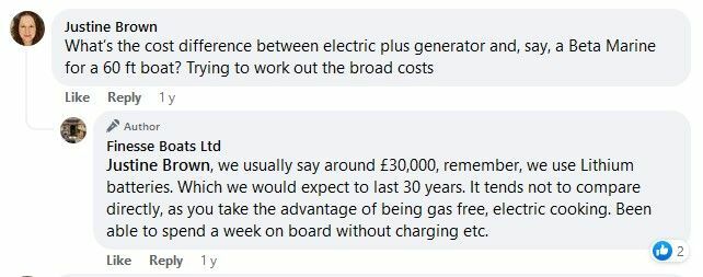

This has been discussed, and a Facebook page from Finesse about a year ago estimated that the cost adder at the time (probably bigger now...) was about £30k (15%?) -- but note that this is for a high-end state-of-the-art hybrid system, fitted to a high-end narrowboat. The post from jpcdriver above had half this figure (£15k) which seems small (and it was about 10% of the boat cost), but it all depends on the equipment fitted -- type and size of batteries, cost of motor and controller, size of inverter, amount of solar, size and cost of generator and installation, and so on.
Given that there is a much bigger difference than this between the cost of boats from different builders -- at least 50% between low-end and high-end, if not more -- this is just another choice to be made, like equipment levels and fit-out materials and cost. You could get an electric/hybrid boat from a low-end builder for less than a diesel boat from a high-end one if that's what you want.
I don't know how many new boats are sold each year, I expect it's no more than a thousand or so (maybe less) given the number of boats on the canals (~35000) and their typical lifespan (~35 years?), and I doubt that even 10% are electric or hybrid today, probably about half that. I know Finesse aren't making anything else and their order book is full for a couple of years, so the demand is obviously there and increasing, but the vast majority of new boats are still diesel -- and the reason is very probably cost.
