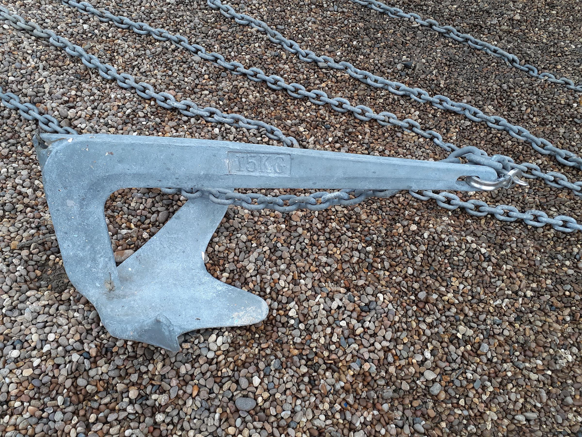

To combine the answers to several postings :
It takes 5 minutes maximum (a couple of bolts tightened with a spanner) to assemble the Mason / Mantus type anchors. They can be stored flat in a locker for the "99%" of the time you spend on a canal - you will never need an anchor, if you breakdown you can pole to the side, or even get off and 'walk'.
You don't just 'suddenly' find yourself on a River, you surely have plenty of time to plan and can spare 5 minutes as you empty the last canal lock.
Store the assembled anchor on the roof or in the well deck.
There is no use having an anchor that is unsuitable, it just gives a false sense of security. Surely it is better to have one that has a high percentage chance of doing what you want it to do and act as an emergency brake.
There is no earthly reason why you shouldn't / couldn't practice, LOWER the anchor over the side and as al little 'slack' develops in the chain engage reverse slowly feeding the chain out, when the anchor bites (sets) you will feel it jolt thru the boat, pay out a little more until you have 3 - 5 times depth and tie it off.
It is advisable not to rely on your T-Stud as this has been known to snap off due the high shock-load. Ideally mount a cleat / ring with a large, thick steel backing plate so as to spread the load.
I fell into the trap when I started using a NB on the River and bought a 15kg Danforth - being used to anchoring the 'lumpy water boats. with the likes of CQR and Bruce anchors I had no reservations about deploying or recovery.
It was an absolute waste of space. It did nothing but bounce along the bottom as I went in reverse. Nuff said
I still have a Bruce on the Cruiser, and the Kedge is also a Bruce.
