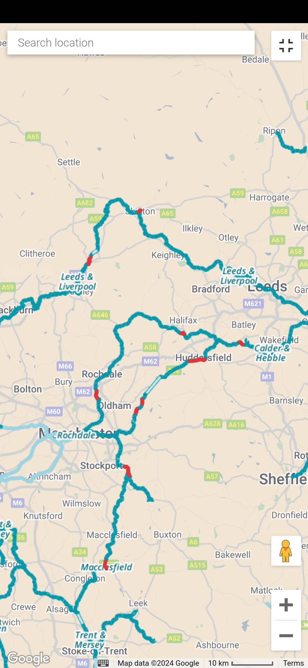

  12. Unfortunately the Rochdale is closed again, 3 days before I was hoping to get through this section. Do I divert to Huddersfield, which I've done before including Ashton twice, or Leeds and Liverpool for the scenic long way round, also done before... Navigation Closure: Lock 65 to Lock 80, Rochdale Canal Detail From Date: 13/06/2024 14:00 To Date: On-going Type: Navigation Closure Reason: Repair Is the towpath closed? No Location Closest waterway: Rochdale Canal Starts at: Lock 65 Alfred Street Ends at: Lock 80 Coal Pit Lower Description Please be advised that navigation is currently closed at Lock 73 on the Rochdale Canal due to a blown cill, which is preventing the lock being operated. Our team have carried out investigations and will begin repairs tomorrow, and while these take place, the canal will be closed between Lock 65 and Lock 80. A further update will be provided on Monday 17 June.
  13. Hi I thought I had yes, but think as others have said, maybe if you don't select only closures, you get other things such as the lock opening times in orange, overlaying the whole map... Yep that's it. You filter the map for only navigation closures. Then you can actually see them. That's not ideal, I would have missed that.
  14. Just checking on CRT website, there don't appear to be any closures on the L&L or Rochdale Canals presently. Must be something wrong with the colours on the map, as that appears to be contradicted by the notice at Barrowford.
