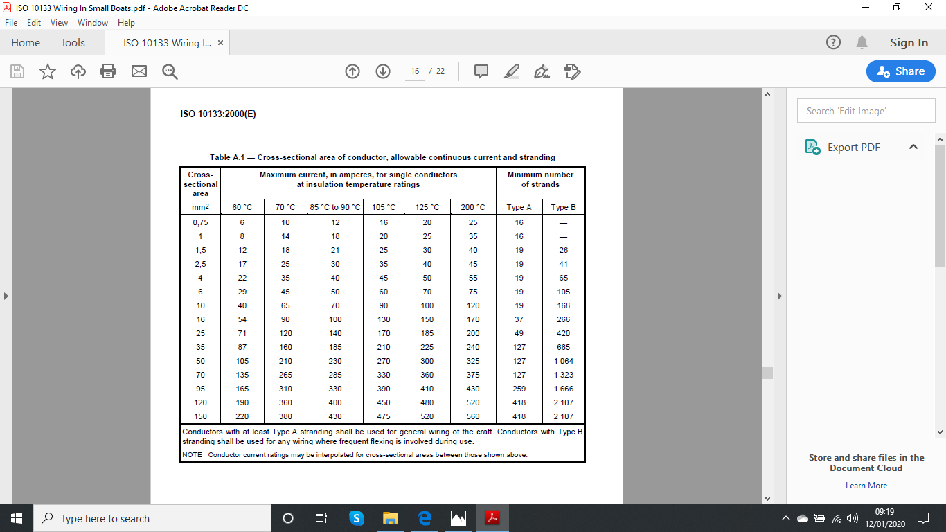

ISO 10133:2000 "Small Craft  Electrical systems  Extra-low-voltage d.c. installations"
Tells you all you need to know for the 12v wiring
7 Conductors
7.1 Electrical distribution shall use insulated stranded-copper conductors. See Table A.1. Conductor insulation

7.5 Conductors shall have minimum dimensions in accordance with Table A.1, or the conductor manufacturer's
rated current-carrying capacity, based on the load to be supplied and allowable voltage drop for the load to be
carried. Conductors in voltage-critical circuits, such as starter motor circuits, navigation-light circuits and ventilationblower
circuits, whose output may vary with system voltage, shall be sized in compliance with the component
manufacturer's requirements. See 4.5 and 4.6.

1 hour ago, Stephen Jeavons said:
I find Para 7.7 ambiguous.
Could that be because you didn’t appreciate that the sub-clauses were options?
Sure, they are options assuming you don't comply to the main requirement i.e.
7.7 A d.c circuit shall not be contained in the same wiring system as an a.c. circuit, unless.......
Back to my original query: What is meant by "same wiring system"? That was the bit I found ambiguous. How do you read it?
Maybe, ocean-going gin palaces have the space and layout to have separate channels, conduits and spaces to allow DC and AC separation but how many common or garden narrowboats, even built with the requirement in mind, have the space to comply?
Edited by Stephen Jeavons
Lumped together. In the same place. Following the same path. Co-located.
I’m sure you and others can think of more synonyms.
Basically if you have 12V and 230V both travelling under the gunwale then they musn’t be in the same trunking or tied together etc.
