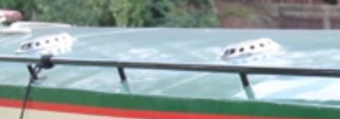

  11. Sorry, no decent photos of the vents, maybe you get a clue from this zoomed in image. yes, they have a flange around them with self tappers.
  12. We are currently refitting the boat, and have witnessed leaks through screw holes etc. Understand what you say about condensation, but this is noticeable when it rains. There has been minimal maintenance done to the vent covers over the last number of years, so to protect the new interior was looking to do some external maintenance, looking for suggestions on how best to create a waterproof seal.
  13. Hi all Any suggestions on the best way / product to seal the external roof mounted ventilation covers. They are about 10” diameter with 8-10 screws holding them down. Before anybody mentions it, I’m not looking to block the vents, just to seal around the edges as I believe rain is seeping underneath and getting inside. I had seen a ‘squeezy’ instant silicon gasket sealant, comes in a tube a bit like the sealant you would use around your shower. Thought was to remove the vent cover, run a ring of this around the outside, just outside the screw hole ring and then screw them back down. Thoughts? Darren
