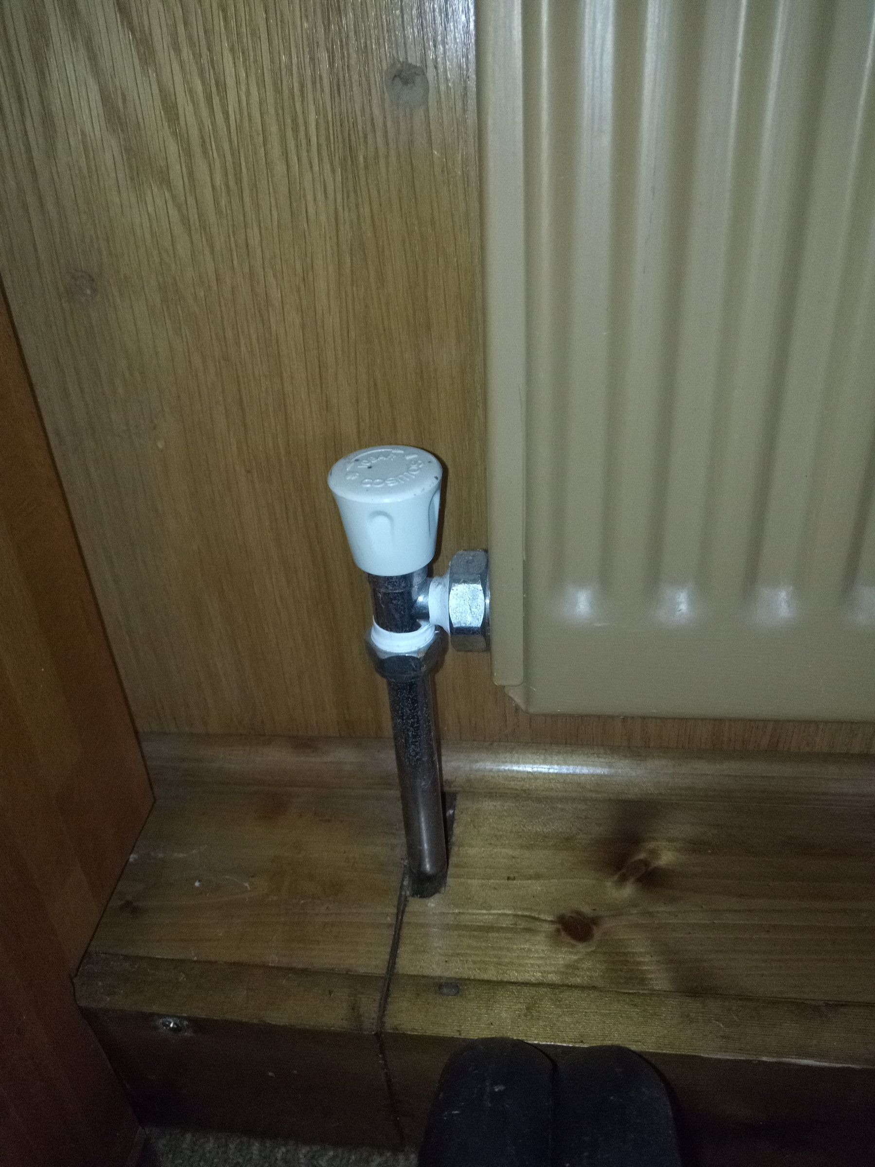

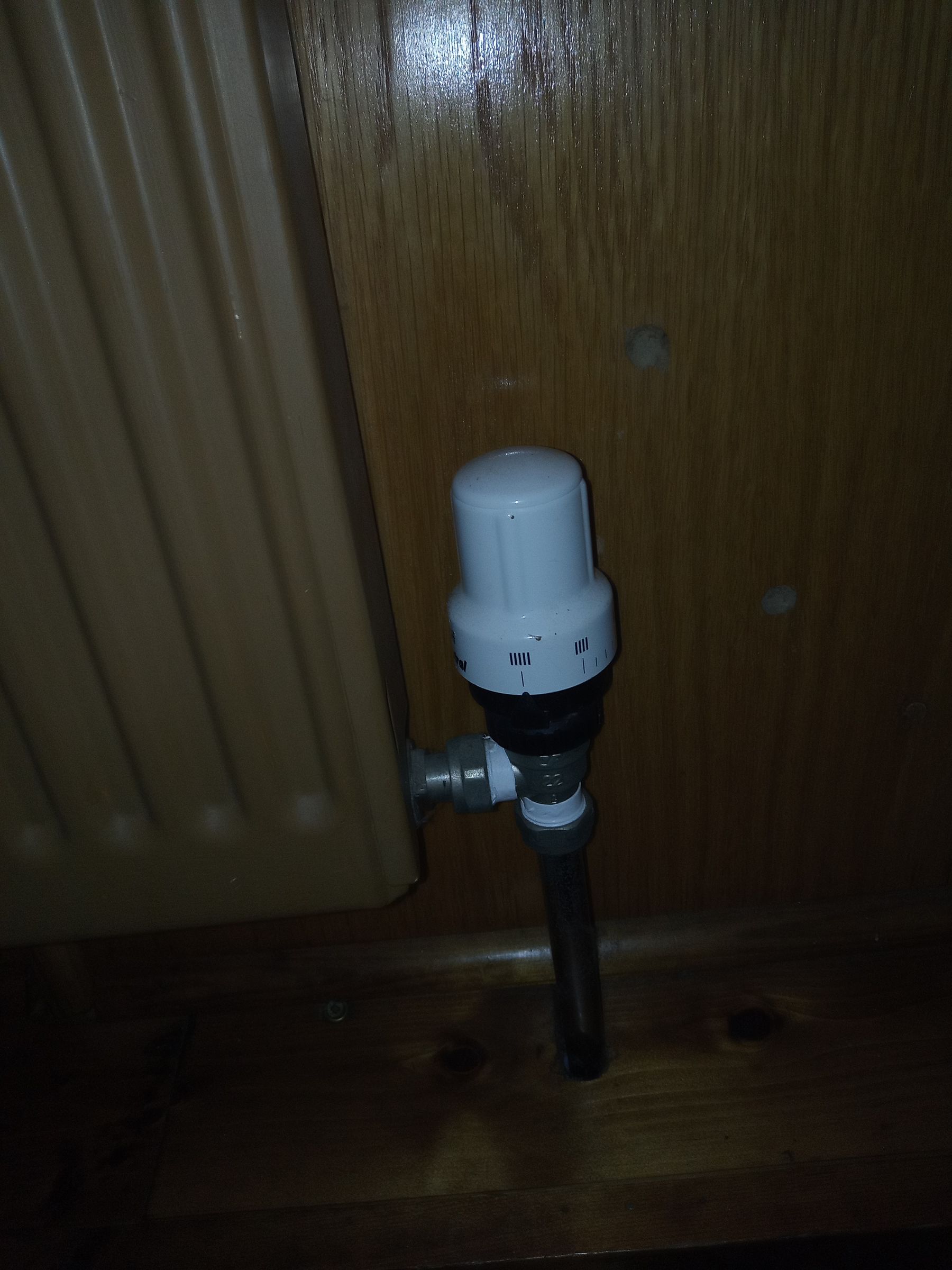

So yours are plumbed straight in with 90 degree elbows into the radiator tails?
Edited by blackrose
rad BSP straight to 15mm cu then 90degree rubber hose preformed bend from Car Builder Solutions (very expensive) down to 15mm cu to 22/15/22 cu Tee (Tectite Sprint (non-removable!!)) double pipe main, on both sides of the rad.  Tectite recommended by NMEA in an old post. Hoses for maximum flexibility since the main is 14M straight.  Can't get to the boat to take pics unfortunately.  Rads sized to fit local space ie smaller in bedroom.  Happy so far but not heavily tested.
Blimey, it sounds more complicated than just using a TRV!
I've used non valve solutions but with a push fit piped system and you can get rad fittings - some say balancing is important but you can achieve that with "hidden gate valves as I did and I never turned them down!.

When I said the tails needed to be changed over I meant take them out of the old rads and put them in the new?  People have been known to take the old rads out and ditch them ( to make space usually)  before removing the tails.....
The direction of flow is normally marked by an arrow on the side of the metal bit of the TRV.  Usually the flow is in through the TRV but if there are no markings you will have to consult the web to see what the makers says.
I don't think TRV are much of a benefit in a boat, though no experience of widebeams, but valves generally are the simplest connection solution and do allow you to take one rad out and still use the others.
N
If you do have TRVs on all the rads then presumably you should have a PRV between the main flow and return pipes in case someone makes the mistake of shutting all the TRVs and then later switches the heater on without realising?
