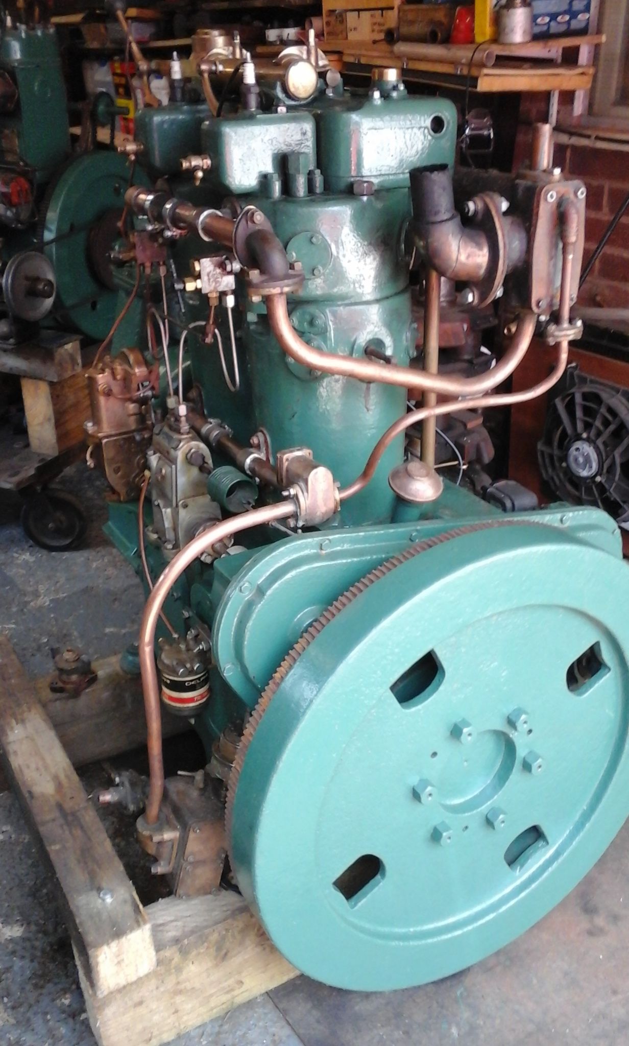

hughc Posted June 30, 2019 Report Posted June 30, 2019 Kelvin K2. Electric and petrol hand start. Full rebuild with photographs. £8500. No offers. Regards, HughC.

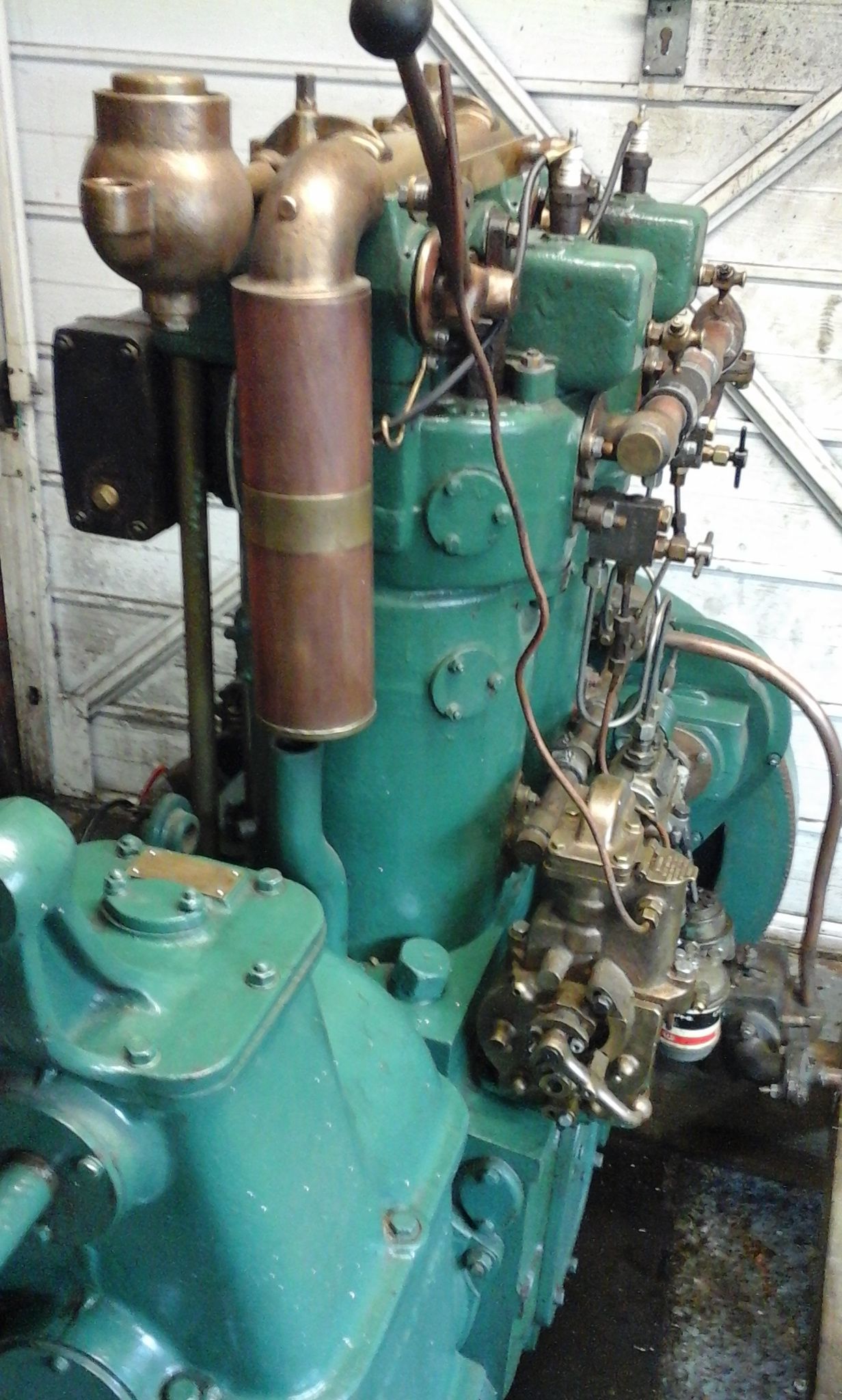

hughc Posted July 1, 2019 Author Report Posted July 1, 2019 Having managed to take some photographs I can expand the information a little. The engine no. is 33595 whic dates it to around 1967/68. I ws going to fit this in Judith Ann but then decided taht an AS2 would simplify cooling in a wooden boat. All bearings, including gearbox and water pump, either scraped and fitted to Kelvin limits or replaced with new. All ball races including gearbox thrusts replaced.New Flywheel bolts.. All gaskets including head and exhaust manifold. Piston liners and rings. Most fastenings. Starting valve spring. Injection pump. Refurbished injectors including spare.Injector pump coupling and spring. Petrol taps. Cam followers. Gear box lead inserts. Rear Mounting feet nuts. Starter U bolts.Injector pipes. Starter. Hand start and gearbox chain.Magneto impulse. This was a ground up rebuild starting with a bare crankcase.I completed the rebuild a couple of years ago and was going to fit it in Judith Ann but then decided to use an AS2 to avoid skin cooling on a wooden boat. The engine came via the previous owner and, I believe Kevin Whittle, from a Scottish fishing vessel.Engine no.33595 which puts it around 1967/68. Hugh

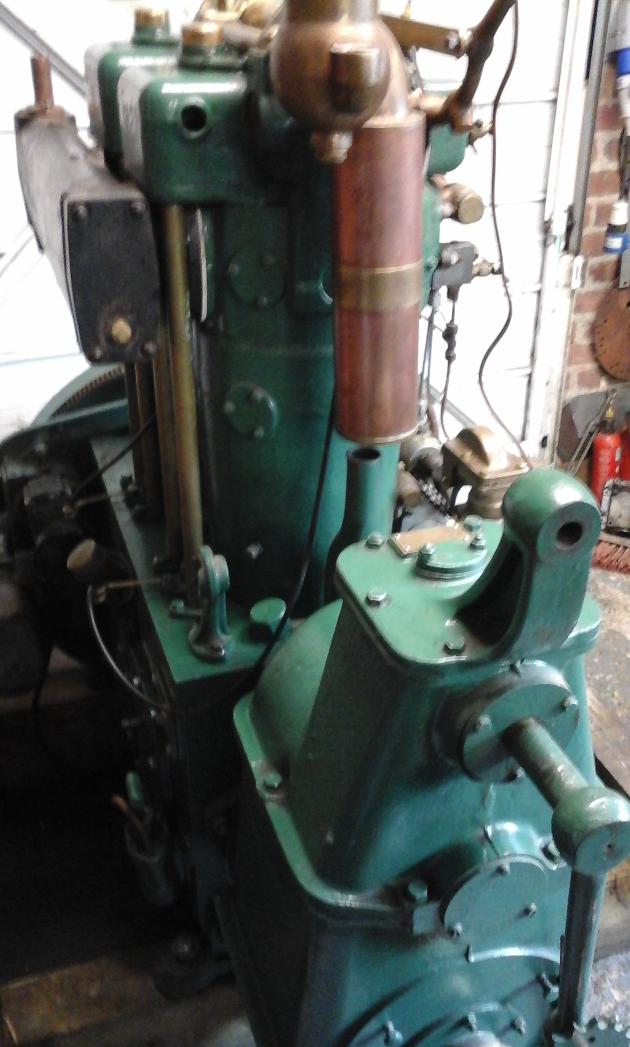

OldGoat Posted July 1, 2019 Report Posted July 1, 2019 Great pictures - but forgive me for my ignorance -but the engine design looks to me as of the 1920s? i had fun with 1930s motor cars and their motive plants never looked as old as that. Even the Lister stationary milking machine I 'used' in the fifties looked more modern. I ask because it's a shock to see how little progress lower volume engines had made. The above engine is a labour of love and huge credit is due to those who restore them - its the technology that boters me.
BEngo Posted July 1, 2019 Report Posted July 1, 2019 The model K was introduced in the early 1930's as the first diesel from a company with about 20 years of production of modular petrol marine engines for a demanding client base. (Scotsfishermen who well knew the value of a bawbee!) The basicmechanical design is therefrore from the 1920's. The company history, I think, leads to the architecture of the model K (and the model J which followed it); modular like the petrol engines, with generous bearings, easy access waterpipes, a simple lubrication system and an ability to change any single defective component, not 3 or 4 monobloc items. They design expected them to be able to be maintained by the inexpert, and they often were. The diesel engineering within is more advanced than the basic engine design. It is heavily dependent on the work of Harry Ricardo, and Bergius paid to use the Ricardo patents. It was state of the art for the time. The reason for the petrol starting system remains a mystery to me. The technology for cold starting was available, albeit fairly new, and adding a magneto to a diesel engine did not do much for simplicity, reliability in a salt laden North Sea environment, or for cost. Nonetheless it works and avoided either installation space for someone to wind up a diesel or the cost and complexity of a starter motor and battery ( another fairly new-fangled thing at the time). N

hughc Posted July 2, 2019 Author Report Posted July 2, 2019 Although the photographs show a modern fuel filter I do have the Kelvin fuel filters which will come with the engine. Regards, HughC.
