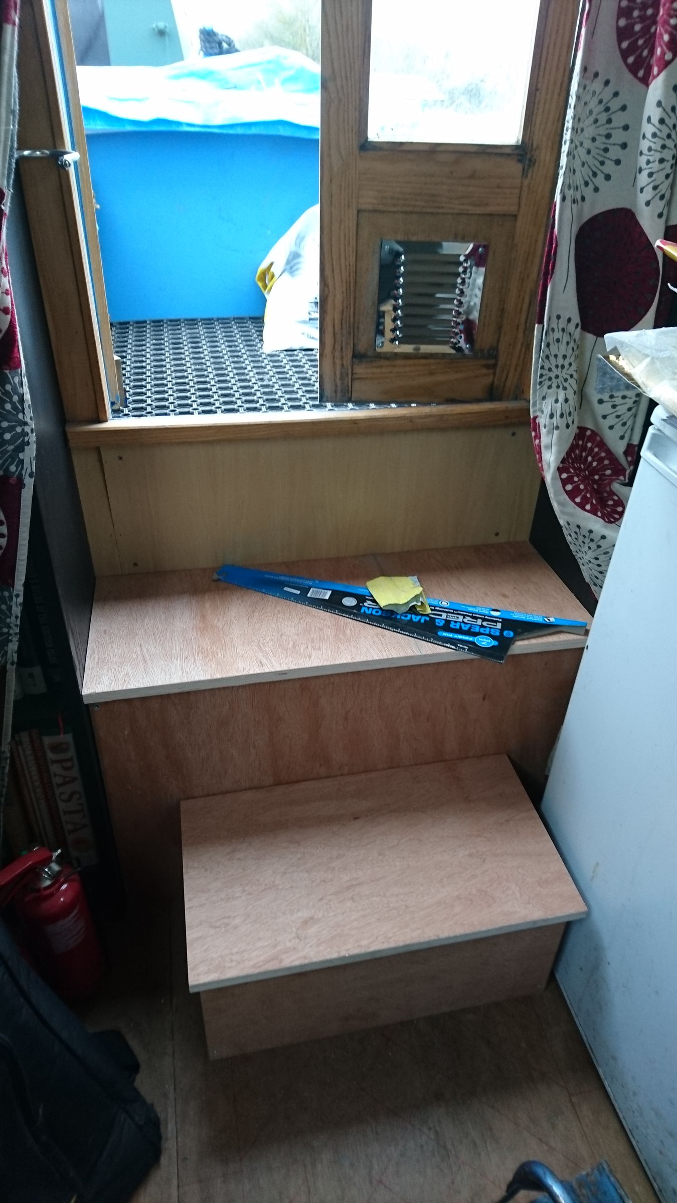

I'm building steps from the bow doors into the saloon. I have height to the door threshold 72cm, but outside the well deck sits 12cm lower.  I want two steps but unsure whether to include that 12cm difference in my calculations (ie 72 divided by 3 or 60 divided by three, to give the height to each step). I'm leaning towards a compromise, or going toward the 60cm and not counting the 12cm extra of the door threshold.
Just about to start cutting...
I'd incline to using the 60cm measusement, so that there is an upstand in the doorway that one steps over, rather than a (small) step up before steppng down.
Thanks. Infact I made a mock up with couple boxes etc and found that agree with what you say. I'm doing the tops of the steps at 24cm and 48cm, the top of the door ridge being 72cm. Now just figuring out depth and overhang! (Appros 24-26cm with 1 or 2cm overhang.)

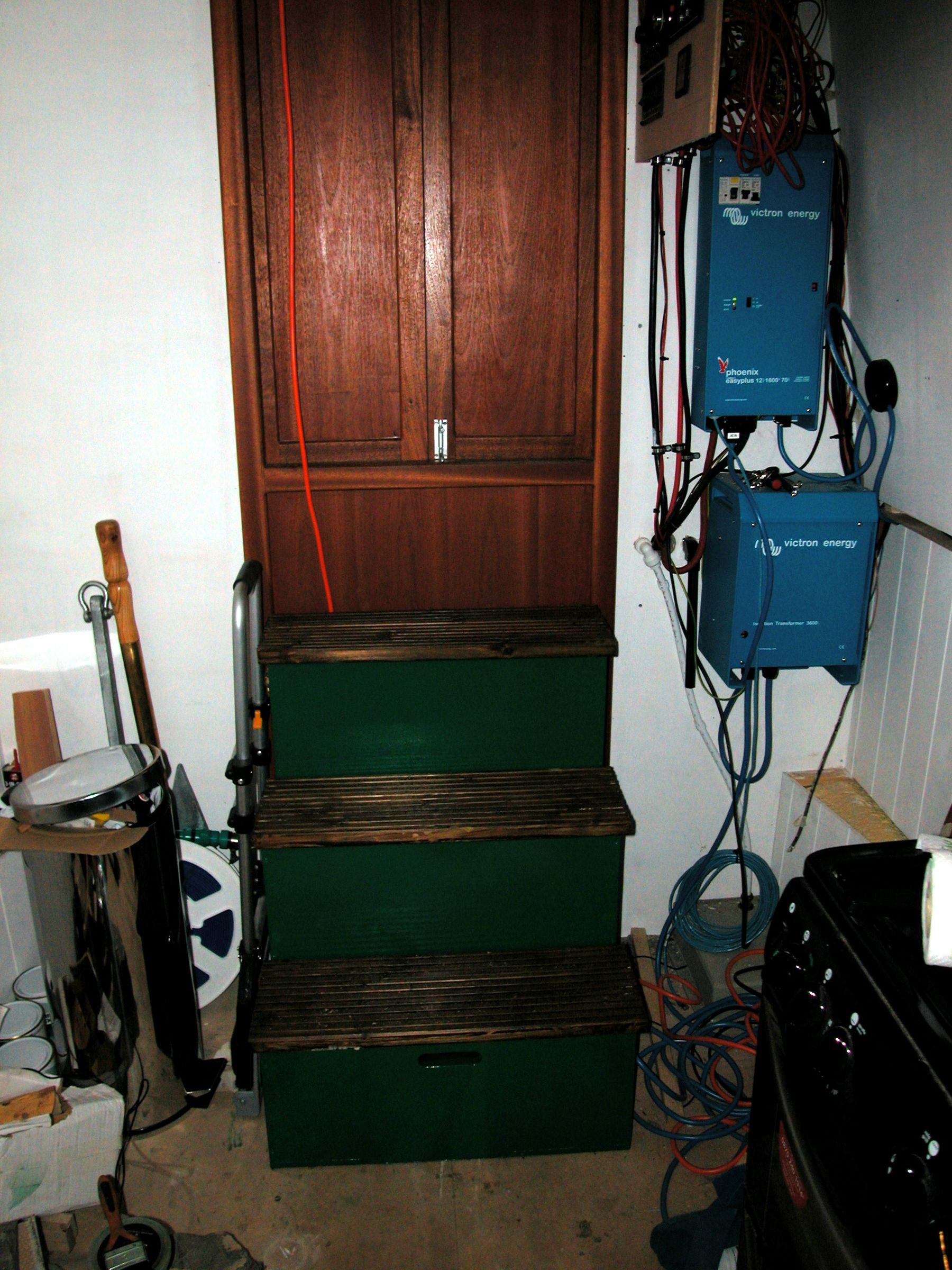

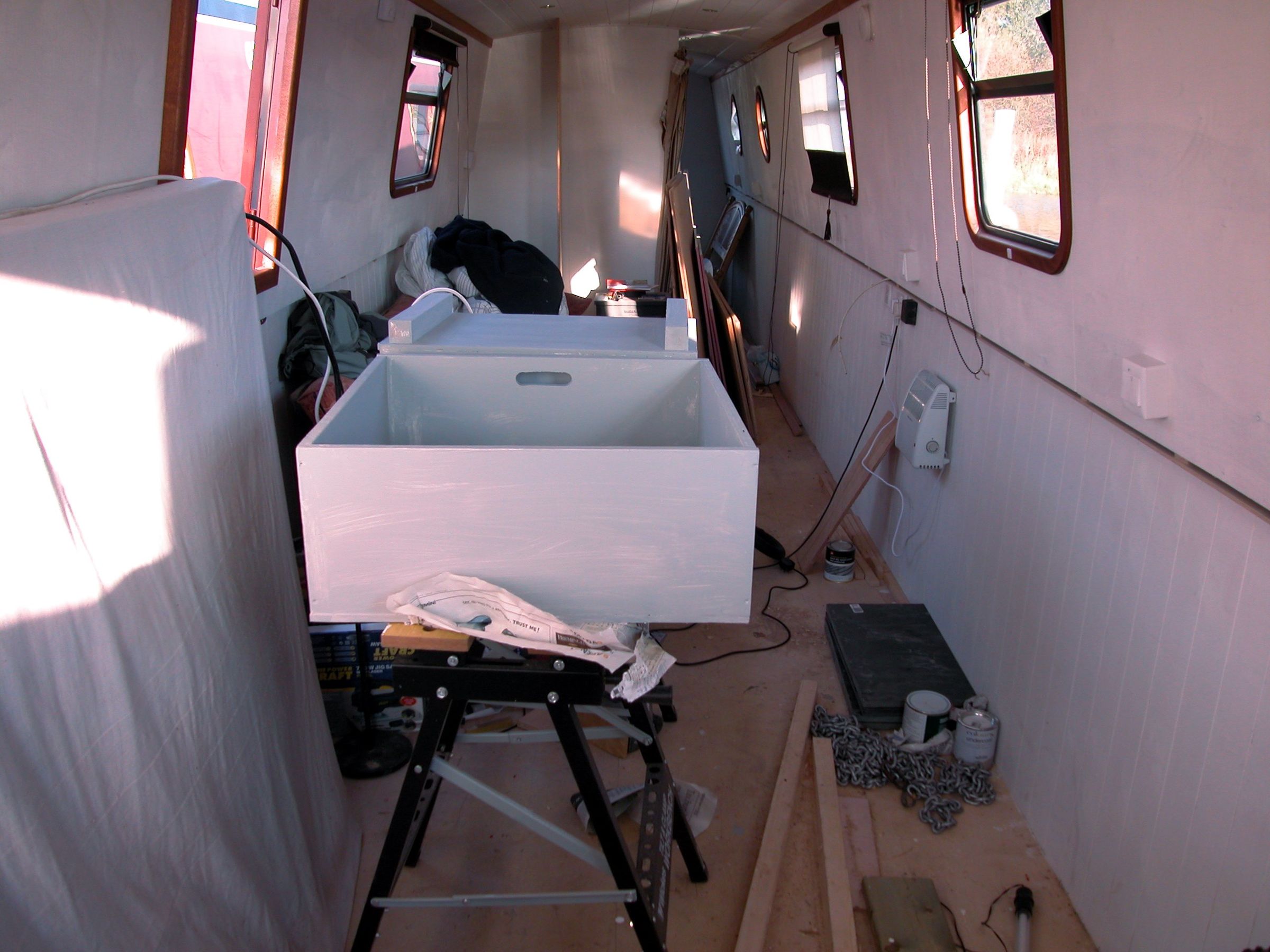

It can provide a useful storage space if you make the steps like stacked boxes but with removable treads.

Thank you for the pics - I love to see what other people are doing/have done and will be sure to get a couple of snaps of my efforts. I am indeed making them as boxes, but was planning on doing piano hinge lids. I like the handle holes on yours - I may do leds on mine :)
In the end I've gone for a fairly deep step - 26cm plus any over hang, might as well make life as easy as possible though of course it takes up floor space.
I think it's to do with having to kind of stoop through the doorway as you come in - makes being in good balance harder. When I was experimenting earlier with my boxes, the deeper the step the easier it all seemed. One box done, do another tomorrow, maybe even the tops then I can really test them - if necessary can make a bit smaller. No room for a banister though :(

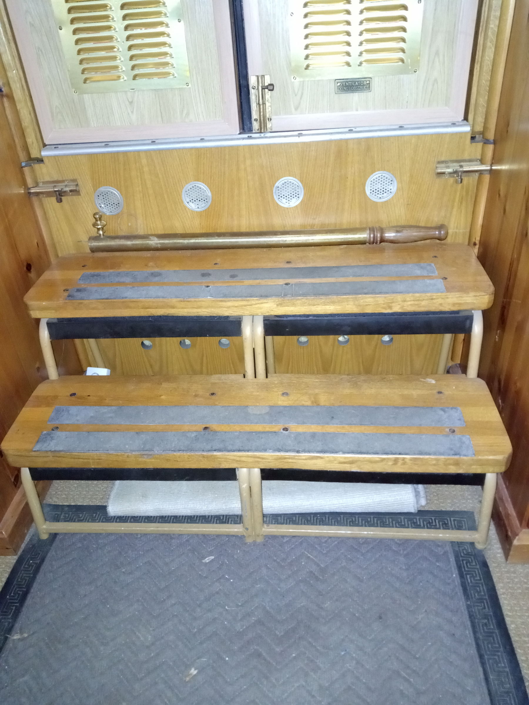

I'm on a widebeam and used two sets of caravan steps covered with some leftover oak worktop from my galley fittout. The steps are heavy but I can move them to get behind and into the space under the bow deck if I need to.

Steeper steps make it more like a ladder, which people will instinctively approach by coming down backwards. You stoop more easily in that direction to get under a closed hatch while staying balanced. Much safer. Another consideration is the depth of any sliding hatch above the steps. It is better to keep the steps within the profile of the hatch opening, or it is more likely that a tall person will hit their head on the ceiling, or the edge of the hatch going up with the hatch open. Again, this will make the steps steeper. The only limitation is having enough depth of tread to safely get a foot on.
Instead of a bannister I put vertical grab rails on the cupboard and control panel to each side of the stairs. Visitors often use them. Not yet fitted in the very old pics I posted earlier.
Just read your first post again and you are looking at bow, rather than stern doors. The rise from the floor to a well deck is generally less than to the stern, so more height is available for people without stooping so much, but then again, most (not all) boats don't have a sliding hatch at the front. Exceptions tend to be tugs with high front decks, rather than well decks. All other considerations still apply though.

I've finished the basic boxes and lids - though lids will need cutting near their rears to add piano hinges - will wait till I get the "penny coin" rubber flooring first so that I can put the hinge in the most appropriate place, aesthetically speaking.
The heights feel ok - obviously I was used to something else (there was just one box/step as a temporary measure). Looking at pictures of other boats, more than not seem to have divided the height equally to the top of the door ridge, as I have. Though I did see one that seemed to have the first step exactly level with the deck, then two more after, which I think would have been pretty good but then more steps means either making them shallower or encroaching into the floor space more. All a compromise.

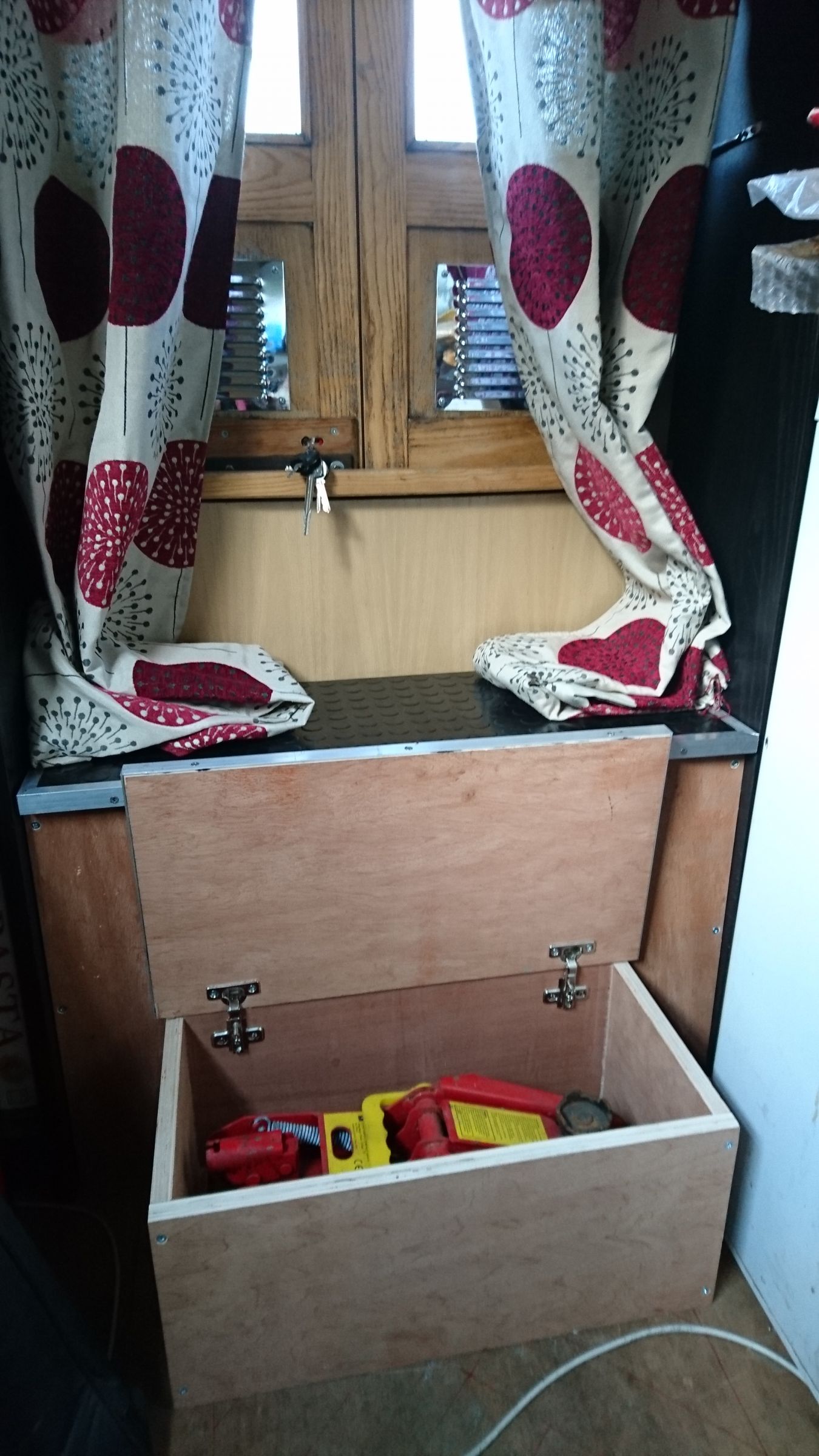

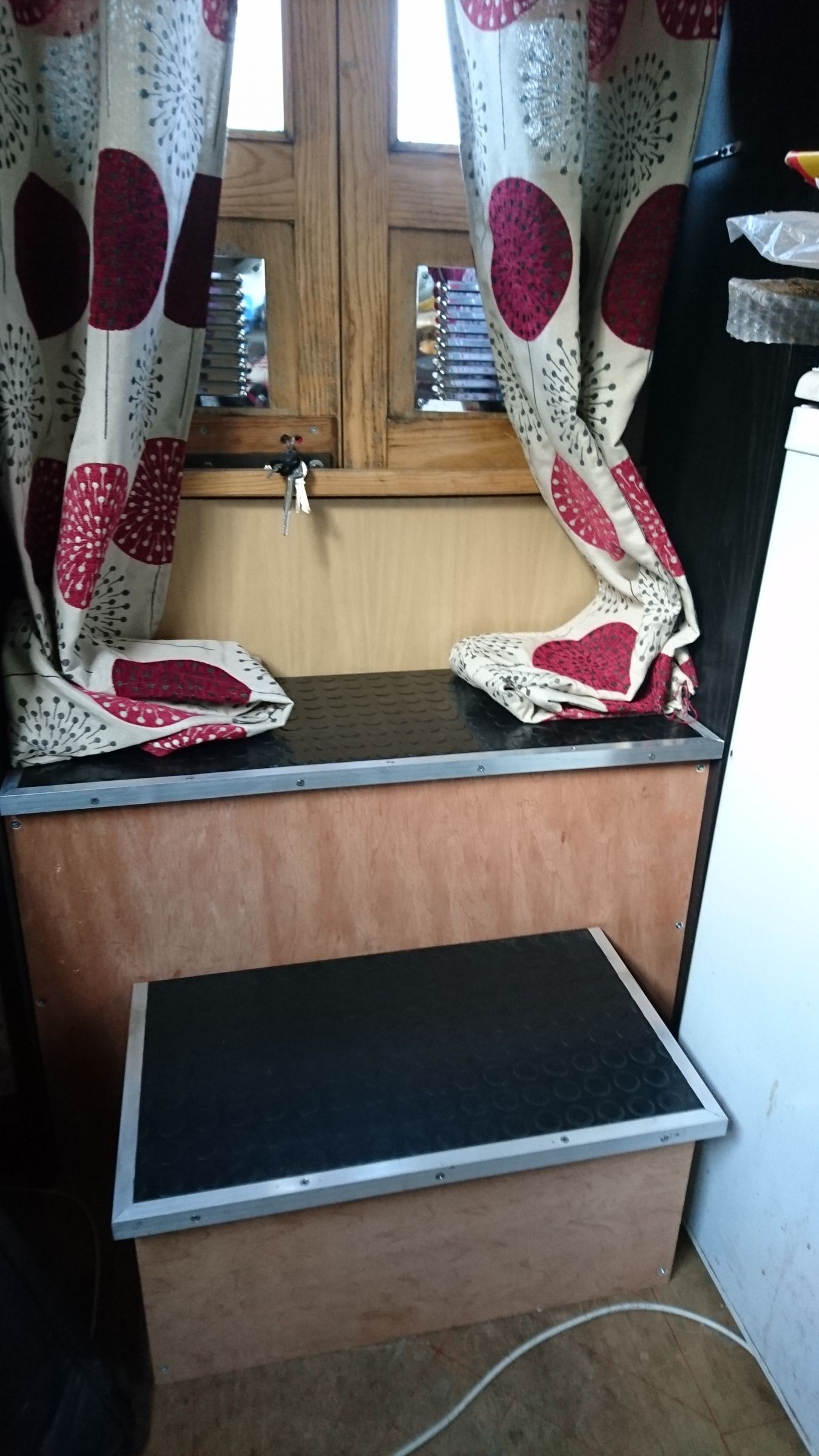

A bit more progress, steps now edged, covered and hinged. I should add some pegs to the backs so they lock together when in place without any risk of toppling, though they have my car jack and spanners in and are weighted down nicely...
Was very pleased with the look of the "penny coin" covering, and in the end I used kitchen cabinet hinges - the lids stay up unaided. Just to decide on a finish for the ply which will either be black or white.
