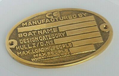

  14. Somewhere in your documentation (assuming you have some) or on a plate somewhere in the boat the builder should have listed the official figures for maximum number of people and weight of belongings. The posts about give some pragmatic approaches to working this out.
