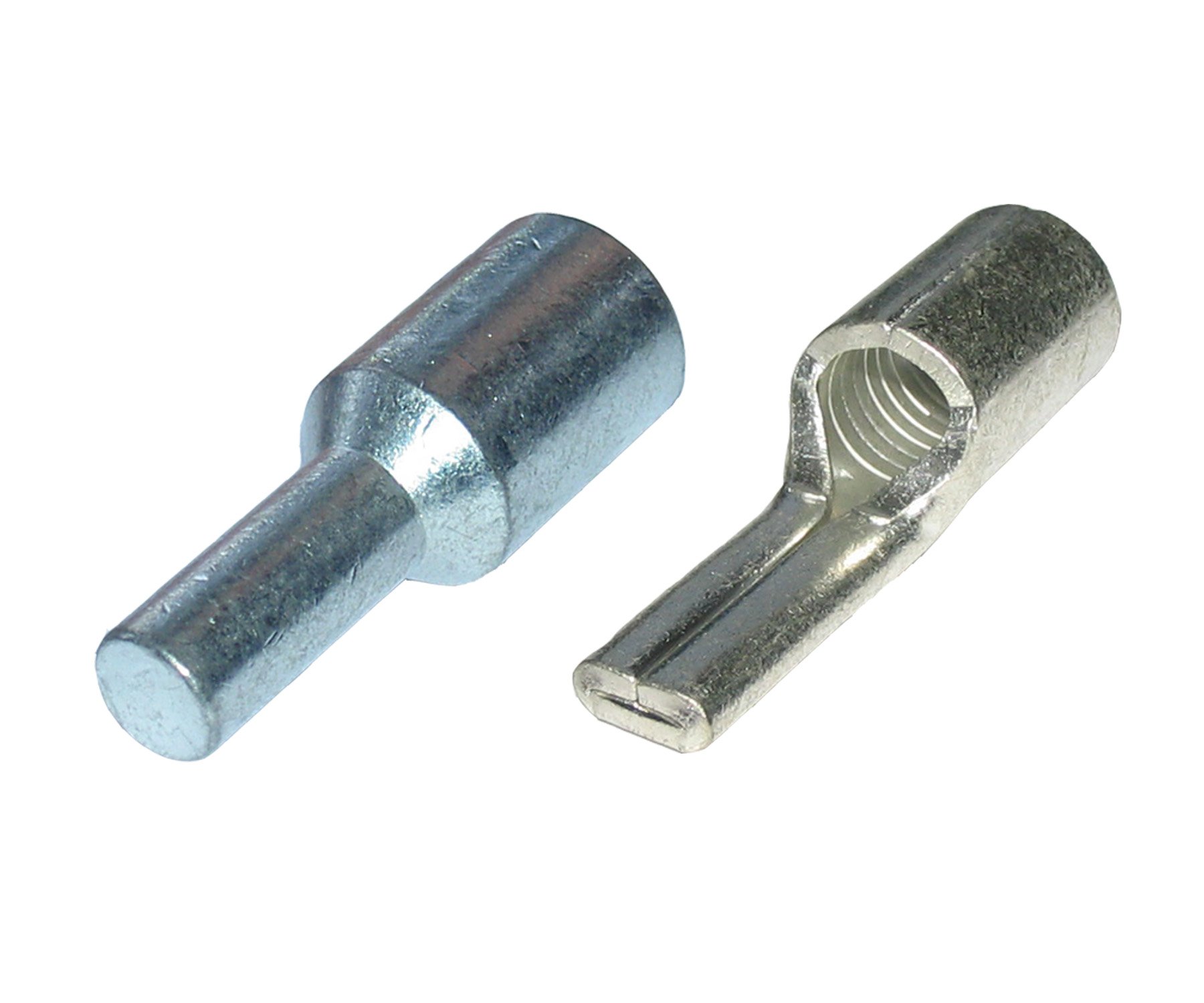

You could have used these to reduce the size of the termination,  so it would fit into the terminal block.
1 hour ago, Neil2 said:
I think I know what you mean there but would you care to elaborate?
The reason for the fat cable is to reduce the voltage drop down its length. However few strands connect at the end, the size of the cable over its run has succeeded in minimising the voltage drop as required. The number of strands used to make the connection were probably still more than sufficient to carry the rated current.
I’m not suggesting for one moment that it’s good practice, because it isn’t. It’s just not as bad as one might initially presume. Using the lugs linked to above by cuthound would be a far superior way of terminating it.
