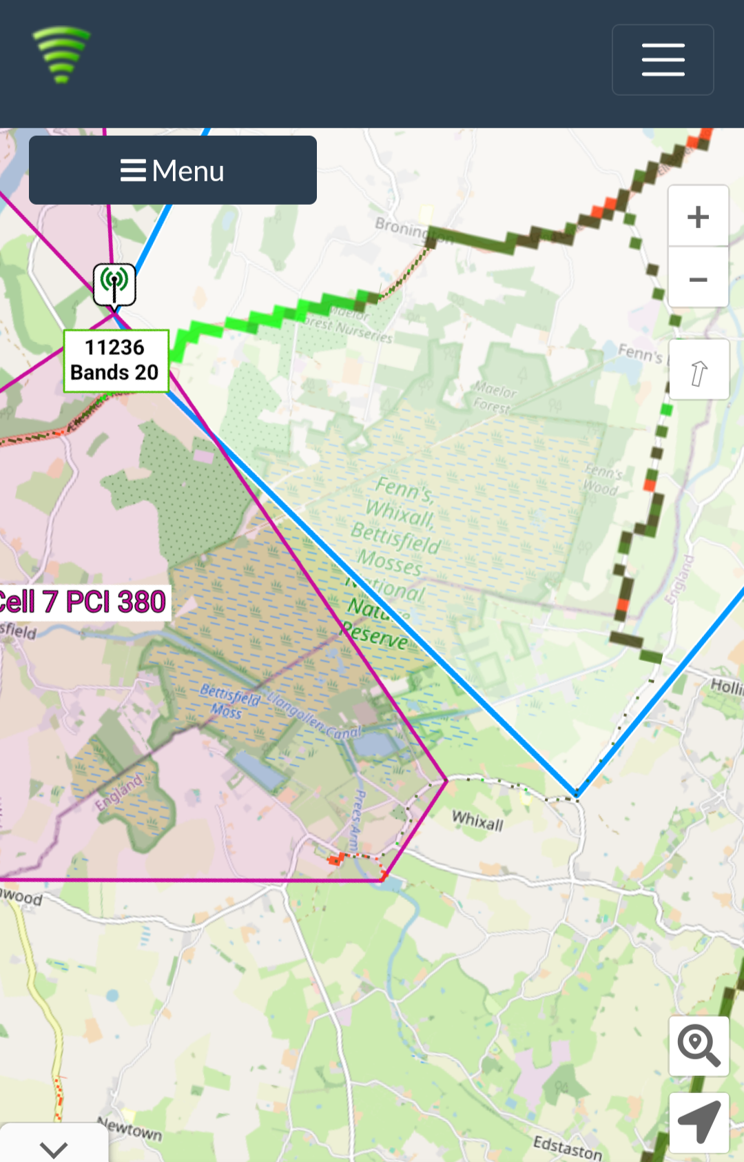

Looking at Cellmapoer for 3 coverage Whixall marina is on the edge of Cell 7 from  mast 11236 this unfortunately only uses band 20  so although there is coverage the data rates are unlikely to be high.
And Vodafone?

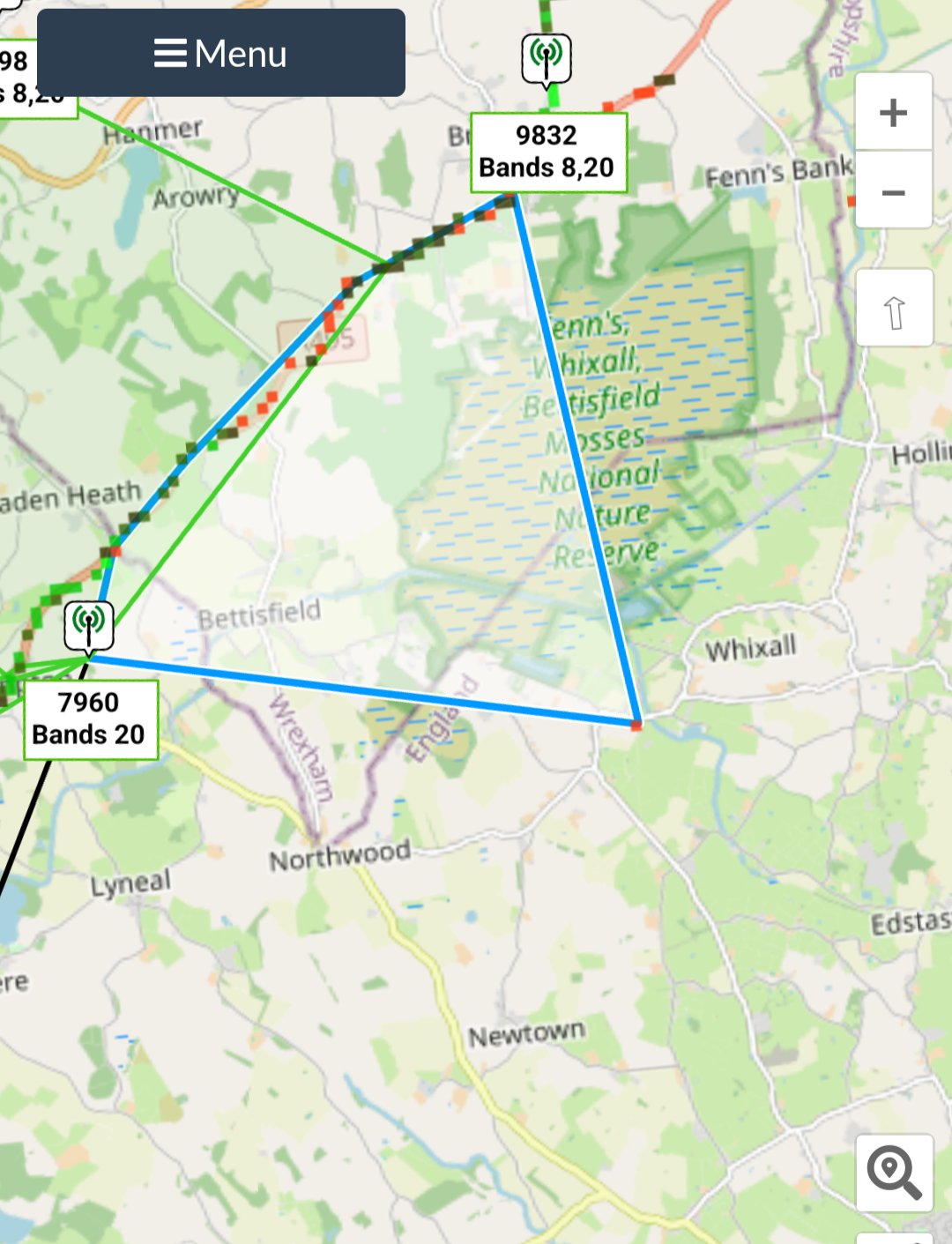

Just had a look on Cellmapper and it looks like *all* the networks are pretty useless there -- so maybe Starlink is the only usable option for WFB... 😞

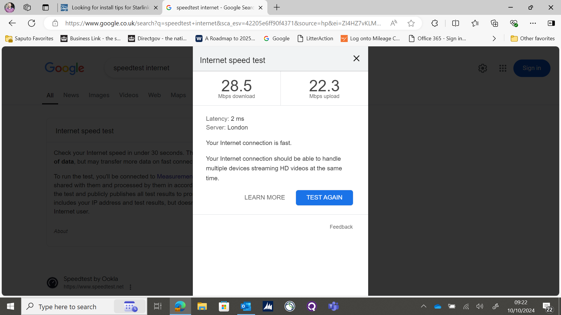

Where I'm moored on the R. Nene I think the only mobile signal is EE and a poor 3 signal. But the 3 data signal is ok so I use the standard Huawei B535 4G router and Poynting external wifi antenna. I work from the boat, join online Teams meetings and stream TV sometimes. It's not the fastest connection and Excel documents take a while to download and open, but it does the job and it's cheap. I bought one of those Three 500GB monthly data sims from Amazon so a one off payment instead of a monthly subscription. I have to set my phone to "WiFi calling" to use my phone for phone calls - that works inside the boat but not outside.
