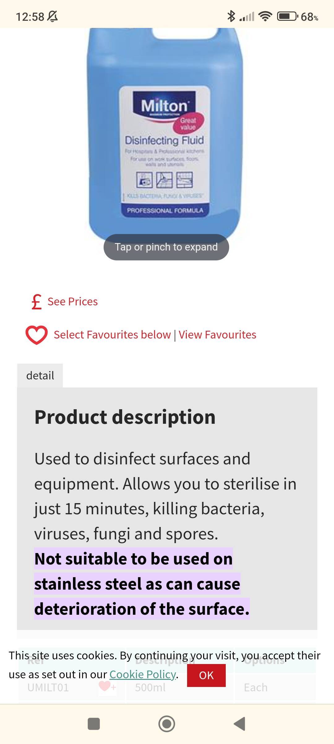

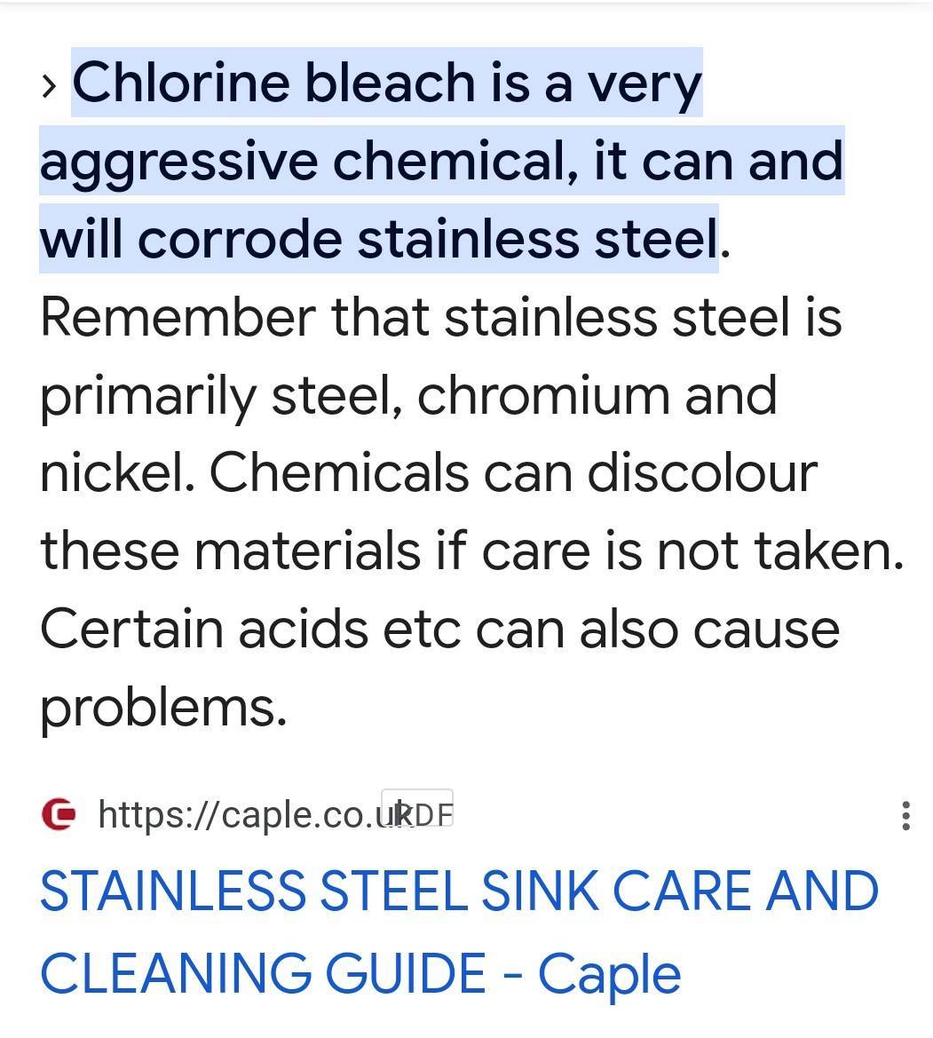

I thought Milton wasn't suitable for sterilising stainless steel? Doesn't chlorine react with chromium oxide?

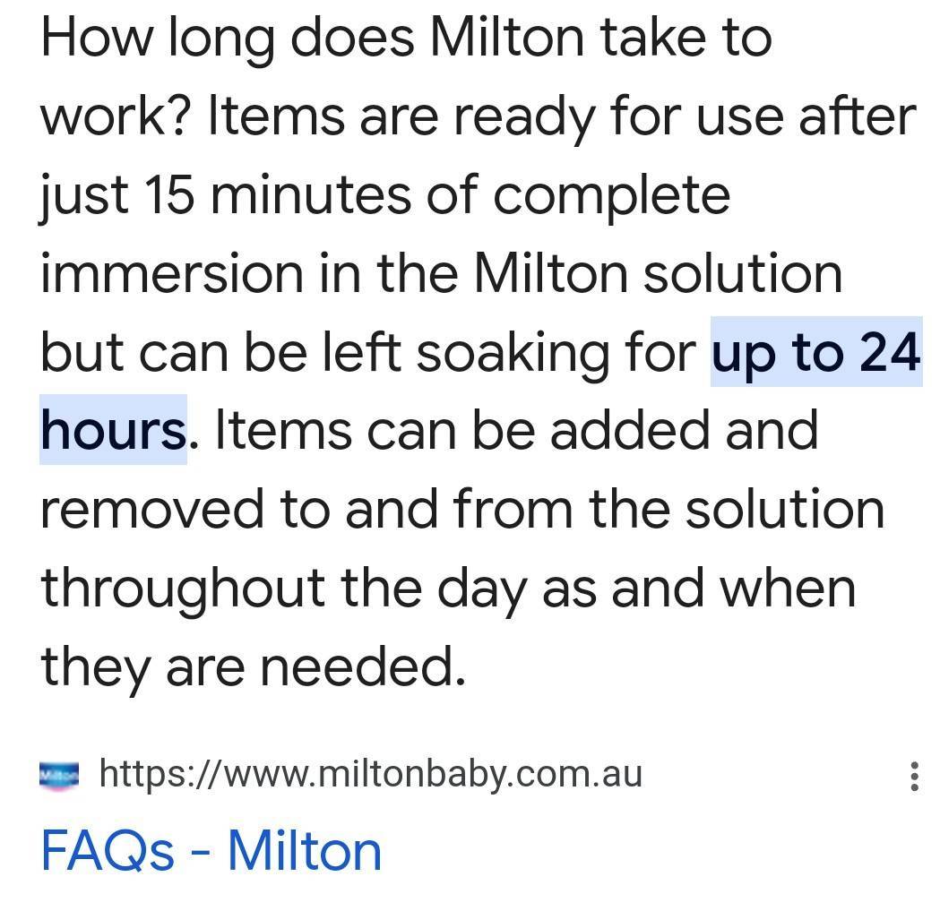

According to Milton 2 mins isn't long enough.
Unless you're also a metallurgist I don't think you can say they'll be no risk of corrosion. I also work in the dairy industry and the stainless steel used in food factories may be a more corrosion resistant grade than some canal boat water tanks from unknown suppliers.
Anyway, if Milton advise not to use it on stainless steel then personally I'd follow their advice, but of course everyone is free to do what they want on their own boat.
However, their instructions do say that 15 mins is long enough. I'm not a metallurgist either, but 30 years of using the stuff tells me that 15 mins contact of dilute Milton won't cause perceptible or measurable corrosion to stainless steel. A couple of weeks of contact with the undiluted product will, however, perforate thin SS.
