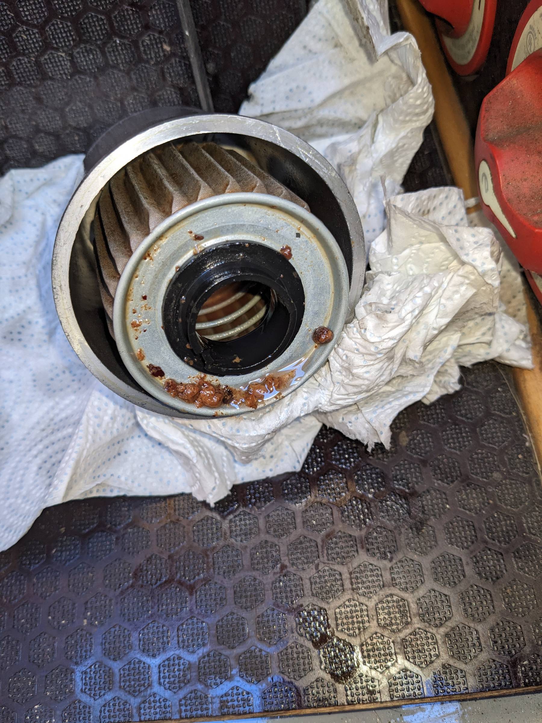

cuthound Posted June 27, 2024 Report Posted June 27, 2024 (edited) Twice on my current trip, the engine has stalled and refused to restart whilst I have been untying ready to let go in the morning. On both occasions my WASP filter has had this creamy contamination in it. See photo below. The diesel filter on the engine has been completely clean both times, although I replaced it with my onboard spare the first time and the engine starts and runs perfectly once the contaminant has been removed and the WASP filter cleaned. The diesel is only a couple of months old and is a healthy clear red colour. I vacuum the bottom of the tank to remove water every year. So, what is it and what can I do to prevent it from reoccurring? The handful of examples I saw when working, albeit on FAME free diesel, were much darker in colour and finer, almost like a slime. I'm thinking of treating the tank with a biocide and if the problem reoccurs then getting my virtually full tank of diesel polished. Any other recommendations, including recommended biocides? Edited June 27, 2024 by cuthound Clarification

LadyG Posted June 28, 2024 Report Posted June 28, 2024 (edited) I did not see the photo earlier, when OP described it as creamy I was thinking an emulsion of water and oil, but the photo is clearly a jelly, which I believe is diesel bug . So while polishing may clean the fuel which is in the tank, I m not convinced it will remove the bug from the tank. I'd still remove the fuel from the tank, it can take up to three days to settle, decant and filter I have heard of people using aquarium filters. There is no doubt a good pump, with copper pipe extention to suck stuff up, and a lot of messing about will be involved in flushing through the system. Removal of the bacteria, the jelly, and WATER from the fuel must be a priority. You might be able to get technical advice from the manufacturers of the additives. I think that some are bactericidal, ie kill the active bug, and some create an emulsion to remove the water, suggesting you would need both types. I am not a technical expert, just putting forward some things I have seen on the Internet. In Ye Olden Days we used to use a chamois leather filter lining a large conical filter funnel to prevent crud getting in to our tank, but we were buying from farmers and fishermen in those days. I dont think I've seen chamois for about twenty years, but I think any filter is better than no filter. Edited June 28, 2024 by LadyG
Tony Brooks Posted June 28, 2024 Report Posted June 28, 2024 Normally one expects fuel filter flow is into the outside, through the filter - so any crud caught on the filter can fall into the bowl, and then out of the centre of the element. looking at the photo (and this might be an imaging thing) the middle looks more reddish brown than the outside. So, although I doubt this will affect the problem, is the OP sure the flow is as it should be.

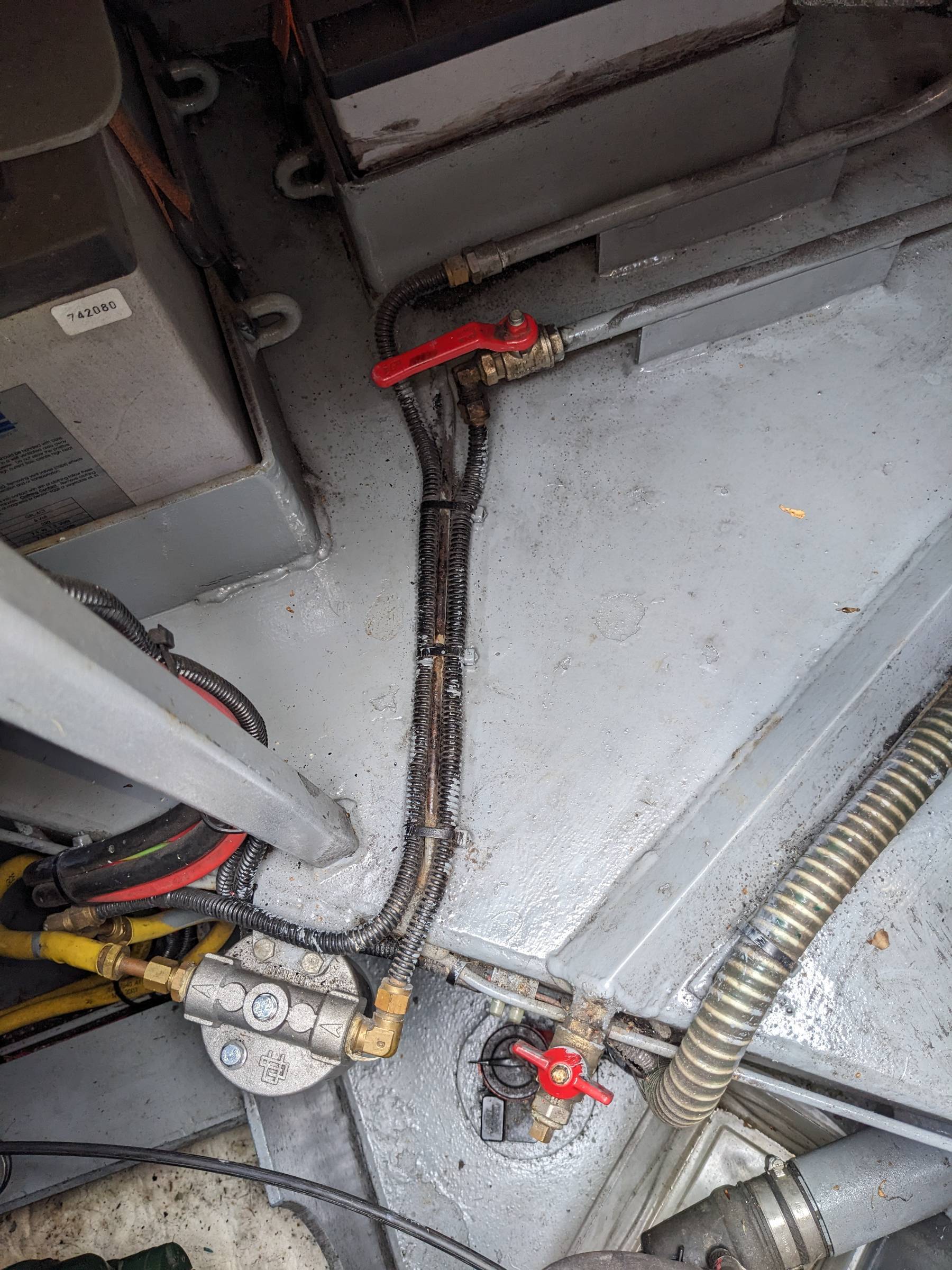

Alan de Enfield Posted June 28, 2024 Report Posted June 28, 2024 Is that corrugated hose between the stop-tap and the filter the actual fuel hose, or is the fuel hose inside and that is 'protection' ? It looks like the end fitting screw directly onto the stop tap and filter. If that is the fuel hose, is it correctly maked with the ISO number and the manufacturing date. Who installed it ? I have never seen a fuel hose like that used in a boat. 2.10.2 Are all fuel feed, return and on-engine hoses suitable for the fuel used and fire resistant? R Fuel feed, return and on-engine hoses must be marked, to denote both suitability for the fuel used and fire resistance, to BS EN ISO 7840 or an equivalent standard. Applicability – hoses marked to SAE J 1527, DIN 4798 or RINA DIP/66/96 are acceptable. Applicability – the presence of armoured or other external braiding is not evidence of hose suitability or fire resistance. Such hoses must be marked as above. Applicability – fuel-hose suitability may be supported by a written declaration from the hose manufacturer or supplier or, if appropriate, from the engine manufacturer/supplier or mariniser.
cuthound Posted June 28, 2024 Author Report Posted June 28, 2024 No it is a steel reinforced flexible conduit protecting the copper fuel pipe. The conduit stops just short of the connection to the filter. The copper pipe isn't marked with an ISO number, but the flexible yellow hose between filter and engine is. It was installed by the "boatbuilder" - Kingsground Narrowboat and has passed four BSS examinations by four different BSS examiners.
Tony Brooks Posted June 28, 2024 Report Posted June 28, 2024 52 minutes ago, Alan de Enfield said: Is that corrugated hose between the stop-tap and the filter the actual fuel hose, or is the fuel hose inside and that is 'protection' ? It looks like the end fitting screw directly onto the stop tap and filter. If that is the fuel hose, is it correctly maked with the ISO number and the manufacturing date. Who installed it ? I have never seen a fuel hose like that used in a boat. It looks like Spirwrap that is used for cable bundling, carefully installed with the split at the bottom where we cat, see it. I think I can see copper pipe at one end fitting. Cuthound, the Wasp looks as if it has been properly installed, you can see the little flow direction arrow heads cast into the top. The way the filter in the first photo seemed darker (more contaminated) on the inside must just be at rick of the light.
Alan de Enfield Posted June 28, 2024 Report Posted June 28, 2024 18 minutes ago, cuthound said: No it is a steel reinforced flexible conduit protecting the copper fuel pipe. The conduit stops just short of the connection to the filter. That is what I thought it looked like, but it looked to be terminated with compression glands. 19 minutes ago, cuthound said: The copper pipe isn't marked with an ISO number, It wouldn.t be.
cuthound Posted June 28, 2024 Author Report Posted June 28, 2024 23 minutes ago, Tony Brooks said: It looks like Spirwrap that is used for cable bundling, carefully installed with the split at the bottom where we cat, see it. I think I can see copper pipe at one end fitting. Cuthound, the Wasp looks as if it has been properly installed, you can see the little flow direction arrow heads cast into the top. The way the filter in the first photo seemed darker (more contaminated) on the inside must just be at rick of the light. The filter element is a reddish colour, presumably by the red diesel and the contaminant is a creamy beige colour with the consistency of yogurt.

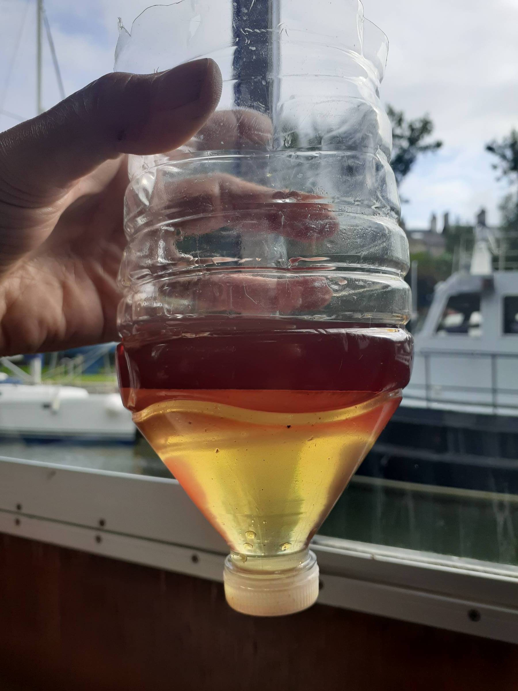

David Mack Posted July 2, 2024 Report Posted July 2, 2024 On 28/06/2024 at 13:21, cuthound said: Today I pumped some fuel from the bottom of the tank and let it settle. It is a clear red colour. There is some light brown sediment that usually isn't there which hopefully I have removed but I was surprised to find no trace of water. See photo. Are you sure? That looks very much like half an inch of water at the bottom of that container to me. 1
cuthound Posted July 2, 2024 Author Report Posted July 2, 2024 (edited) 7 minutes ago, David Mack said: Are you sure? That looks very much like half an inch of water at the bottom of that container to me. No that's the bug. Four days on it still looks the same. I treated it with Marine 16 Diesel Bug Treatment 4 days ago, and will draw some more off the bottom of the tank today to see what is happening. Edited July 2, 2024 by cuthound Clarification
Alan de Enfield Posted July 2, 2024 Report Posted July 2, 2024 (edited) 46 minutes ago, David Mack said: Are you sure? That looks very much like half an inch of water at the bottom of that container to me. And to me (+ some bug) Edited July 2, 2024 by Alan de Enfield

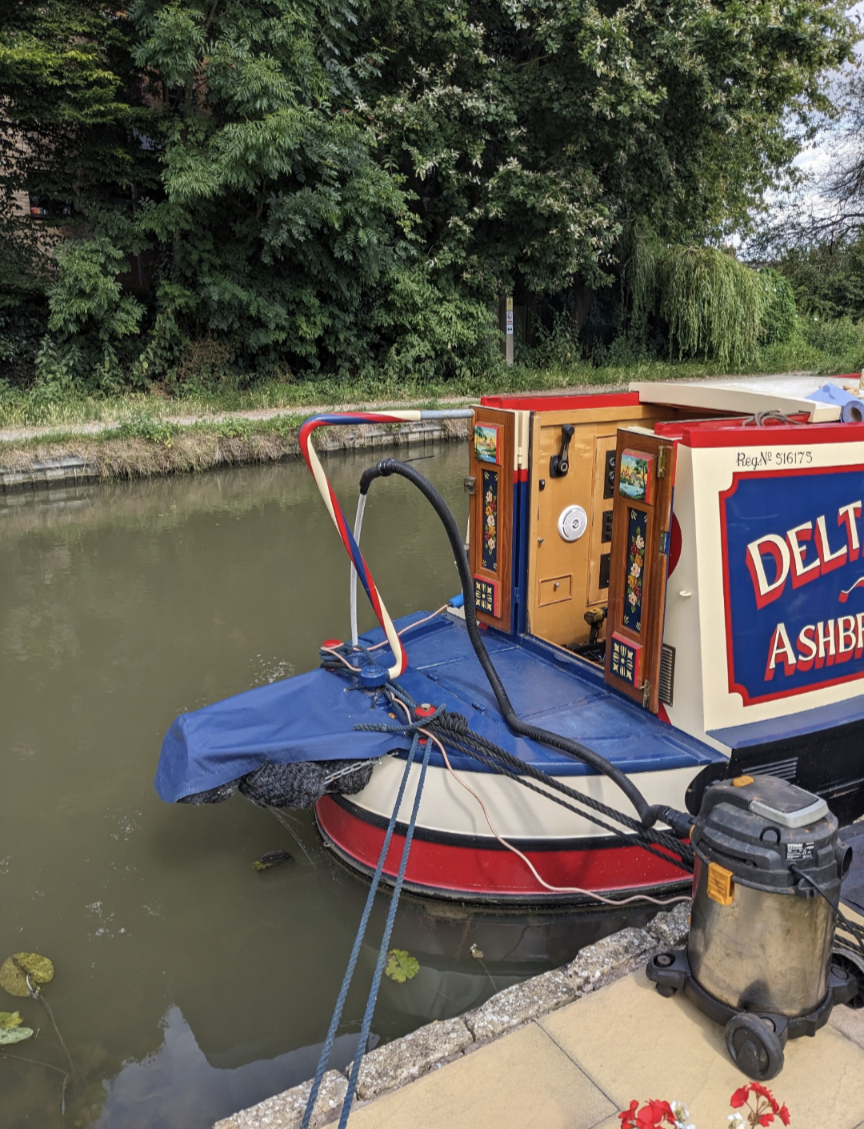

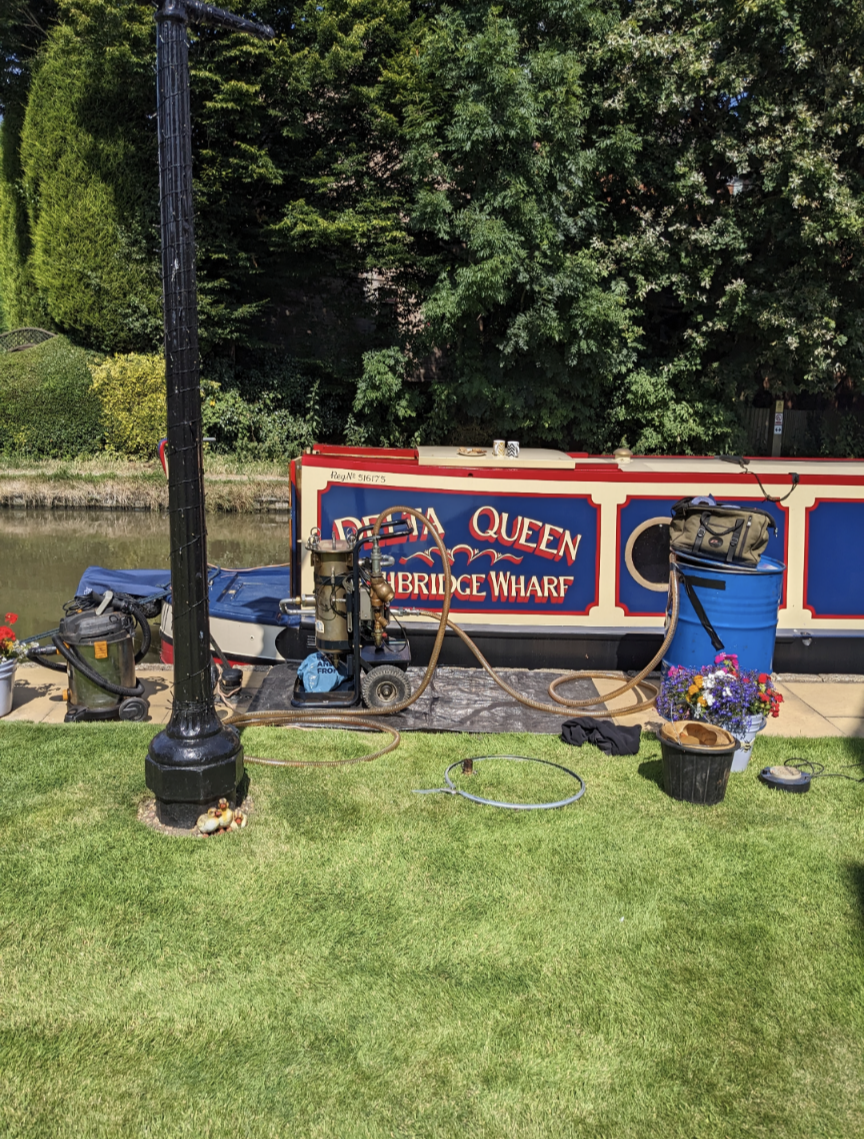

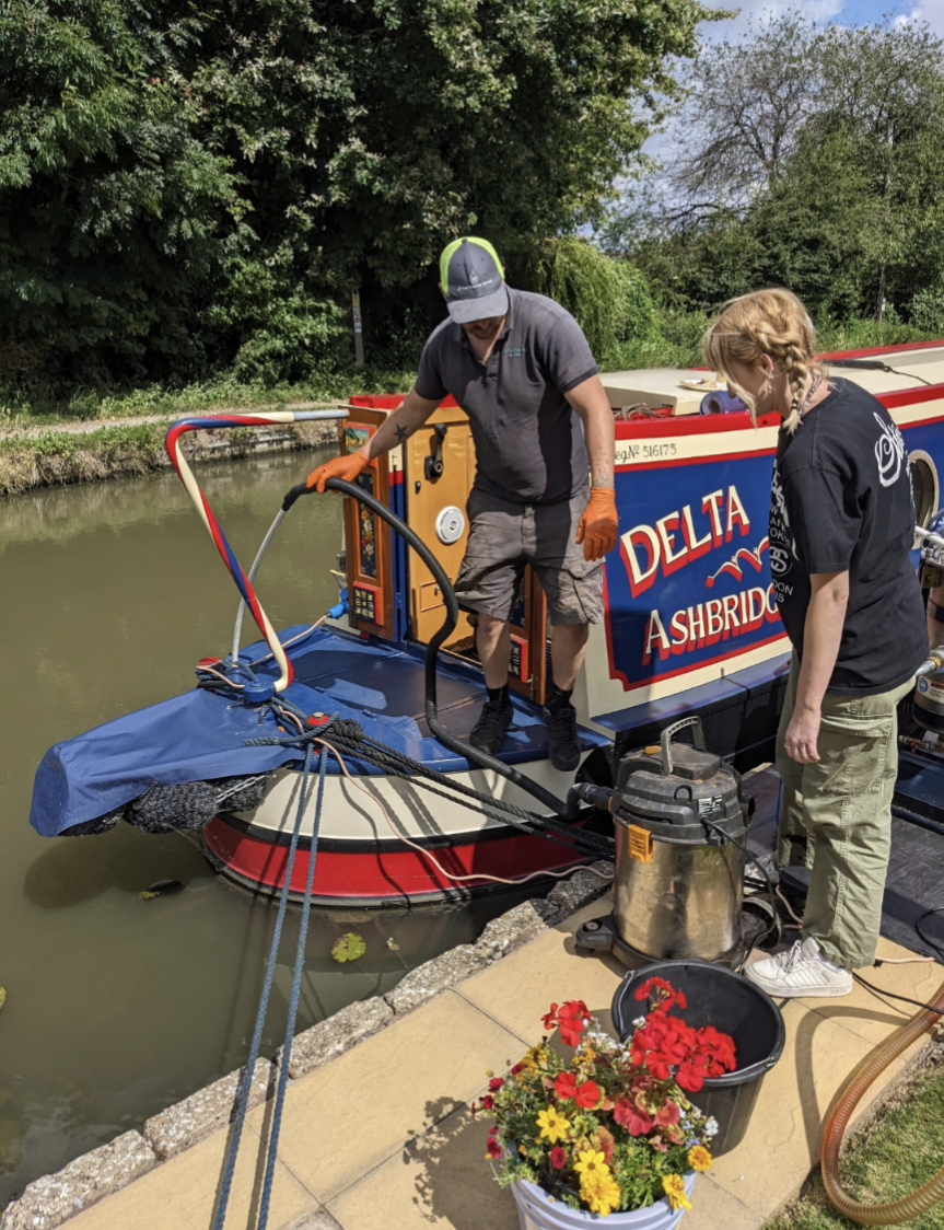

cuthound Posted July 27, 2024 Author Report Posted July 27, 2024 (edited) So today I had the tank cleaned and the fuel polished by JC Fuel Polishing Services, 07757 661307, who came from Bath, had great reviews and was very reasonably priced. His arrival was delayed by the local council choosing today to close my road so they could resurface it. Joe removed the fuel filler fitting to improve access, then pumped the "good" diesel (that above the contamination at the bottom of the tank) into a 205 litre drum. He then used a wet vac to remove the sediment, water and heavily contaminated diesel from the bottom of the tank before inspecting the bottom of the tank and removing any sediment left behind in the corners. This process found the remains of the steel disc that had been cut out to form the hole for the fuel filler fitting when the boat was built! The saved, but contaminated fuel was then pumped back into the tank and passed through the filters to remove all remaining contaminants and any emulsified water. The whole process took about two and a half hours and Joe left my mooring and boat immaculately clean, despite fuel polishing potentially being a very messy process. The photos below show the process and contamination removed. Edited July 27, 2024 by cuthound To add spaces between photos 1
