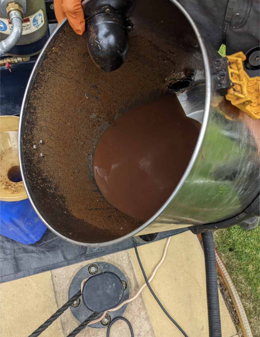

Tony Brooks Posted July 27, 2024 Report Posted July 27, 2024 Did he add a biocide to the fuel after polishing? There have been cases where the bug has resurfaced after just polishing, probably from surface contamination in pipes etc. A member here had a hell of a job with that and eventually needed a specialist biocide if I recall correctly

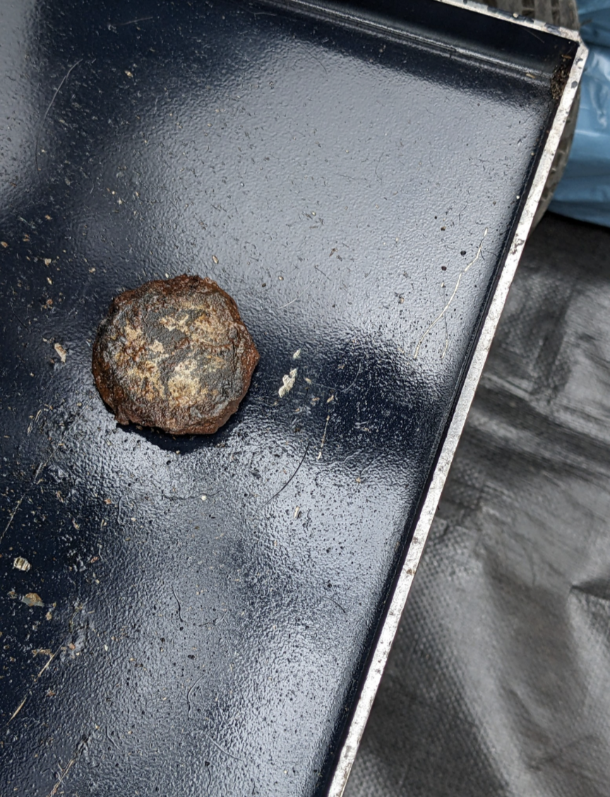

cuthound Posted July 27, 2024 Author Report Posted July 27, 2024 (edited) This was the contamination removed. The round piece of metal is from the hole the boatbuilder cut to accommodate the fuel filler fitting! 31 minutes ago, Tony Brooks said: Did he add a biocide to the fuel after polishing? There have been cases where the bug has resurfaced after just polishing, probably from surface contamination in pipes etc. A member here had a hell of a job with that and eventually needed a specialist biocide if I recall correctly No, I had already added 200ml of Marine 16 (the "shock" dose rather than the "maintenance" dose) as soon as I found I had a problem. I also ran the engine for an hour after polishing to ensure the biocide passed through the system and the recleaned the WASP filter and changed the engine fuel filter, so hopefully all of the fuel system has now been flushed with biocide treated fuel. Edited July 27, 2024 by cuthound Clarification and to add spaces between merged posts

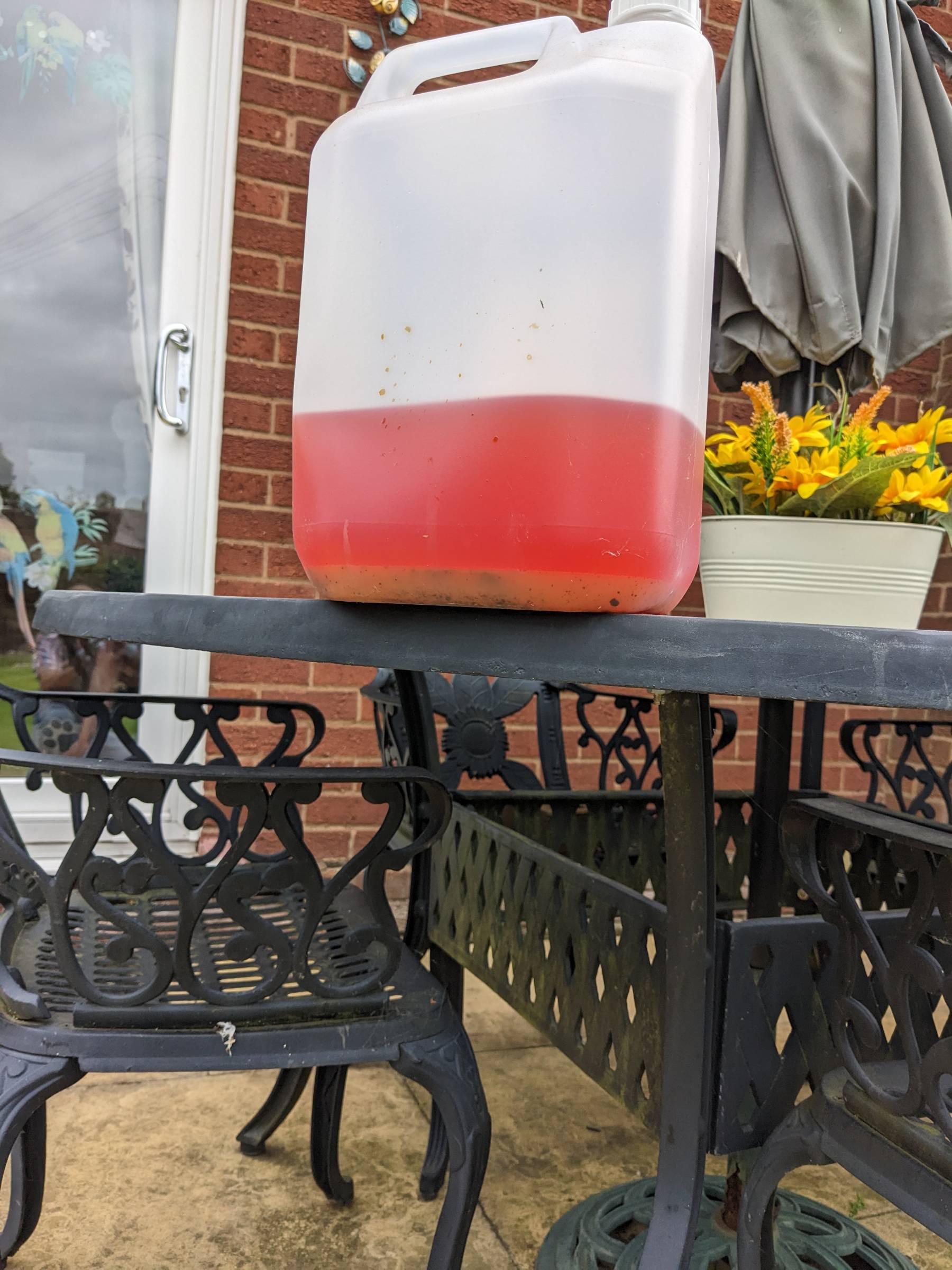

DandV Posted July 28, 2024 Report Posted July 28, 2024 On 29/06/2024 at 00:21, cuthound said: The engine is a Beta 43. The WASP filter is between the tank and the lift pump which in turn is before the filter mounted on the engine. I don't think the lift pump has a strainer fitted. Today I pumped some fuel from the bottom of the tank and let it settle. It is a clear red colour. There is some light brown sediment that usually isn't there which hopefully I have removed but I was surprised to find no trace of water. See photo. I have added a shock dose of Marine 16 Diesel Bug Treatment and will leave it a few days before trying to pump out any further sediment from the bottom of the tank and then taking the boat for a trip. If the problems persist then I will get the fuel polished, which hopefully will remove any remaining traces of sediment. The bottom is water. Which is a remarkably high proportion of the shown sample. That indicates either several years of accumulation of condensation from make up air as fuel is removed from the tank in normal operation or water ingress from a leaky fuel input, or excessive water input through through the tank vent. Too close to those leaking top gates on descent? Water plus diesel is what grows bug. Using a surfactant will only entrain the water in the fuel thus enlarging the water fuel interfaces in which bug grows. You must get rid of that water, which is easiest done before you add any additives, as they suppress the simple mechanism of using the differing densities of fuel and water to separate the two. Dosing without doing this is just adding snake oil. Aviation tanks are checked daily for free water. I removed about 50mils of water on my first water check on a seven year old boat, and then only traces, a few drops, every 250 hours of engine running. But a little more after having the aft deck flooded descending the Leeds and Liverpool. Presume it came through the vent. 8 hours ago, Bargebuilder said: The consequences of diesel bug for lumpy water boaters can be life threatening, depending on where the engine decides to stop. Amongst such people, it is becoming more common for the fuel take off to be at the lowest point of the diesel tank; the sump if it has one. The reason for this practice is to remove all water from the tank, plus any sludge, before it has a chance to build up. Regular use of the engine keeps the tank clean and the tiny amount of water and sludge is collected by the primary fuel filter/water separator. Diesel bug can multiply at incredible speed, so the annual removal of water and sludge is probably not going to be sufficient. Also use Marine 16 or similar of course. Automotive fuel tanks have their take off point on the bottom of the tank so any water is entrained and dealt with by filtration/seperation or just a bit of water injection with combustion. Where the take off is above the bottom of the tank, then the tank becomes the primary settling chamber. This is fine as long as you have a process in place to routinely check and drain this chamber, and if excessive water is encountered to in investigate why. Aviation fuel bulk storage is managed this way. But without routinely removing water from the tank bottom it will continue to accumulate. And will provide a breeding ground for diesel bug that will grow from the yeast spores normally present in the air that enters as fuel is extracted. An accumulation of water will eventually rise to the tank take off level, if not extracted. Any disturbance will then result in slugs of water and crud , instead of fuel heading off to the engine. Lumpy water provides the disturbances that guarantees that tank bottoms will on occasions reach the tank outlet. Hence it is imperative to routinely extract the non combustible, and filter blocking crud from the tank bottom
cuthound Posted July 28, 2024 Author Report Posted July 28, 2024 2 hours ago, DandV said: The bottom is water. Which is a remarkably high proportion of the shown sample. That indicates either several years of accumulation of condensation from make up air as fuel is removed from the tank in normal operation or water ingress from a leaky fuel input, or excessive water input through through the tank vent. Too close to those leaking top gates on descent? Water plus diesel is what grows bug. Using a surfactant will only entrain the water in the fuel thus enlarging the water fuel interfaces in which bug grows. You must get rid of that water, which is easiest done before you add any additives, as they suppress the simple mechanism of using the differing densities of fuel and water to separate the two. Dosing without doing this is just adding snake oil. Aviation tanks are checked daily for free water. I removed about 50mils of water on my first water check on a seven year old boat, and then only traces, a few drops, every 250 hours of engine running. But a little more after having the aft deck flooded descending the Leeds and Liverpool. Presume it came through the vent. Automotive fuel tanks have their take off point on the bottom of the tank so any water is entrained and dealt with by filtration/seperation or just a bit of water injection with combustion. Where the take off is above the bottom of the tank, then the tank becomes the primary settling chamber. This is fine as long as you have a process in place to routinely check and drain this chamber, and if excessive water is encountered to in investigate why. Aviation fuel bulk storage is managed this way. But without routinely removing water from the tank bottom it will continue to accumulate. And will provide a breeding ground for diesel bug that will grow from the yeast spores normally present in the air that enters as fuel is extracted. An accumulation of water will eventually rise to the tank take off level, if not extracted. Any disturbance will then result in slugs of water and crud , instead of fuel heading off to the engine. Lumpy water provides the disturbances that guarantees that tank bottoms will on occasions reach the tank outlet. Hence it is imperative to routinely extract the non combustible, and filter blocking crud from the tank bottom For the last few years I have used a syphon pump to remove water from the bottom of the tank annually as recommended by @Tony Brooks. I suspect I picked up the water and possibly the bug when I last filled up. I usually use a fuel boat but my regular one sadly died and no one had replaced him on a regular basis. Last time I filled up at a boatyard with an above ground tank. Interestingly my near neighbour also filled up there around the same time and has the same problem as have several boats that moor there.
DandV Posted July 28, 2024 Report Posted July 28, 2024 2 minutes ago, cuthound said: For the last few years I have used a syphon pump to remove water from the bottom of the tank annually as recommended by @Tony Brooks. I suspect I picked up the water and possibly the bug when I last filled up. I usually use a fuel boat but my regular one sadly died and no one had replaced him on a regular basis. Last time I filled up at a boatyard with an above ground tank. Interestingly my near neighbour also filled up there around the same time and has the same problem as have several boats that moor there. If several boats fuelled at the same source ended up with water, then that is very likely the source of your problem. I would recommend temporarily increasing the frequency of your tank bottom scavenging until the residual water is drops rather then mils. When I was an oil company engineer the thing I dreaded most was dealing with the aftermath of a trail of dead cars leading back to single site. With underground tanks a leak in any of the connected underground pipes, or a loose fill or dip cap could result in water ingress and justifiably upset customers. The advent of monitored double skinned tanks and pipework, and more aboveground secondary contained storage eliminated most problems.
