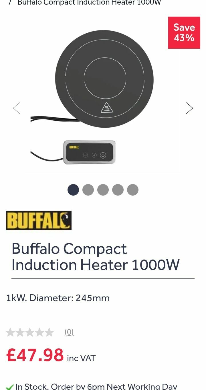

magnetman Posted November 30, 2023 Report Posted November 30, 2023 The Sterling piqued my interest. I like this one.. https://www.nisbets.co.uk/buffalo-compact-induction-heater-1000w/fd059 has got the remote control but a nicer item. I don't think these can be recessed into a worktop because the intake for the cooling fan seems to be on the side of the round part. I believe the idea is one would mount it into a ring of some sort with the hole in the worktop being larger.

magnetman Posted November 30, 2023 Report Posted November 30, 2023 This one is only a heater. You can use the 'I am only heating the Buffalo' exclusion clause and cook to your hearts content. I think this is why it is deliberately not advertised as a cooker. Clever.

magnetman Posted November 30, 2023 Report Posted November 30, 2023 Similar issue with my fire. It is a heater so I can cook pasta on it without the Pasta Protection League targeting me for online abuse and death threats. Just now, rusty69 said: Sterling do a similar thing. Not sure I would want to cut a hole in my work surface though https://sterling-power.com/pages/induction-hobs I wouldn't buy a Sterling product they are too expensive and no good. No need to have the digital display. Its a gimmick. The Buffalo controller is a far better design. 1 1

magnetman Posted November 30, 2023 Report Posted November 30, 2023 The little ones can be set as low as 2 or 3 hundred watts. They do work but it depends what you call cooking! The 1kw Buffalo induction hob has ten power settings for warm or cook. I think provided it was installed properly and you have a durable electrical system this could be a very nice addition to the Boat. I would not be without bottled gas as it is so useful but one of these hobs for when there is too much solar is actually not a bad plan.
