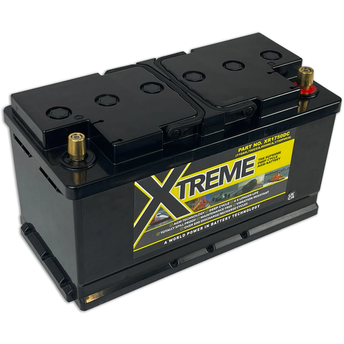

According to the OP in an earlier post in this thread his batts are Leoch "12V 110AH Xtreme AGM Leisure Battery (XR1750) NCC Class A
12V 110Ah fit-and-forget AGM lead-acid battery for multiple applications (LOW-FIT). "
These are, according to the listing he gives, "maintenance free" but he reckons there are removable caps which expose the glass mat. The mat seemed dry so he squirted some water in. Here is a pic of it:
One would imagine having removed those caps the batts are no longer sealed, and having added water to the gel they are probably totally goosed.
image.png.a66ee9fa309cc41cd6d31130f19e901c.pngsee

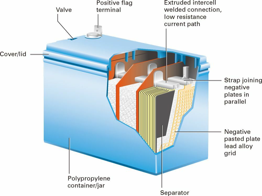

I've never seen an AGM battery with removable caps. As the electrolyte is not a free liquid (it is recombined from the oxygen and hydrogen evolved during charging) what would be the point?
I think @Tony Brooks has sussed it. Although the case says AGM they are not and it is marketing bolleax.
Or do they just use the same enlosure as their wet cell batteries?
Out of interest, what do the valves look like on these things? Do they look anything like a removable cap?
They look like the one on this image  nothing like a removable cap.

At the very cheap end of the market some manufacturers have always used screw in caps on VRLA batteries, it allows them to get away with using standard lids and boxes. That said it does allow for the vent pressure to be pre tested before fitting. As for adding water to AGM, it can be done but you need a vacuum pump and a swap over filling head otherwise the water just sits on the top of the element.
Without taking the whole battery apart and squeezing a sep between my fingers even I can't tell if the sep is too dry or not.
Back in the early 1980's Exide tried to get into the AGM telecoms market without really knowing what they were doing and got the alloys all wrong. The cells gassed too much and dried out in less than a year, they had teams going round to all the AT &  T sites adding water. Cost them a fortune and gave us (Chloride) an open market.
These days everyone knows how to make AGM, but I have still seen the odd Chinese company get it wrong.
