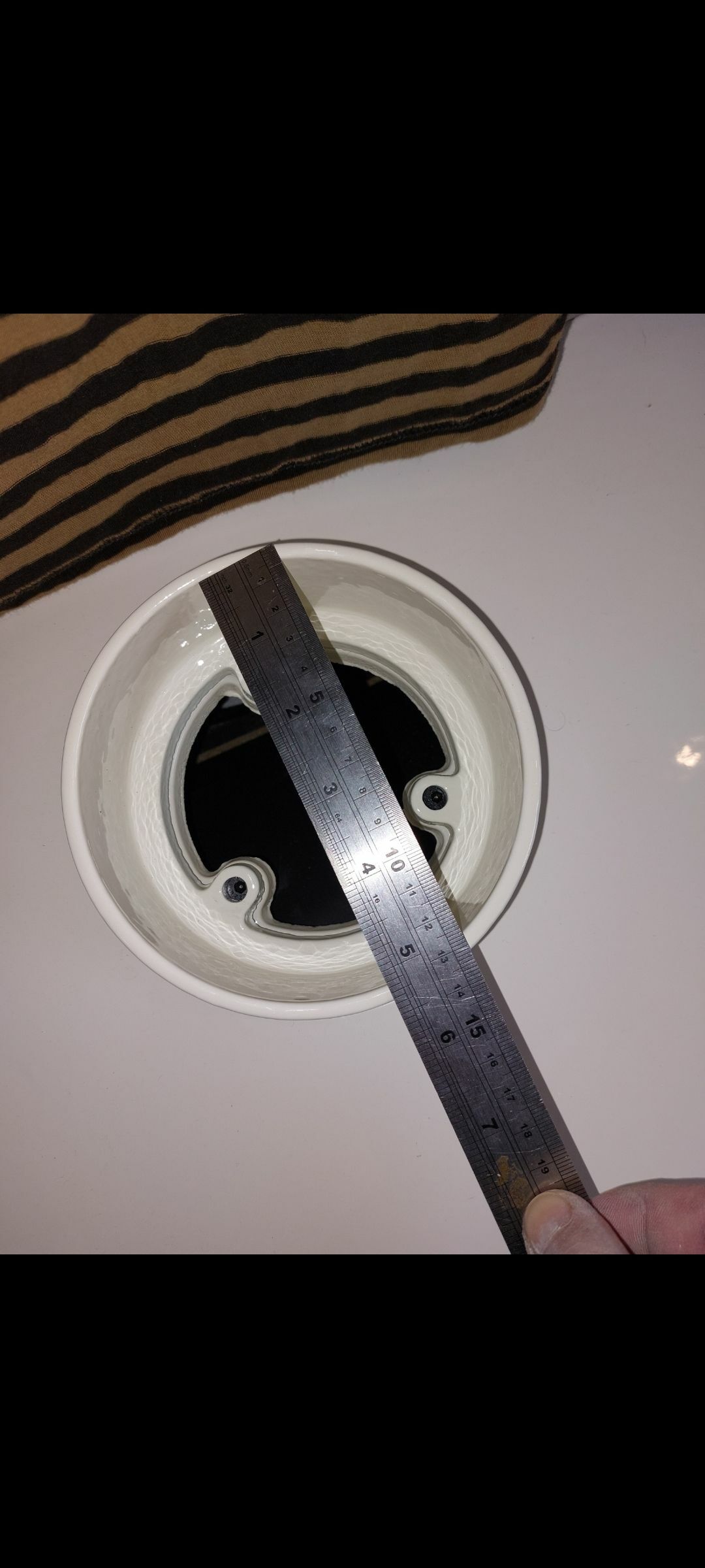

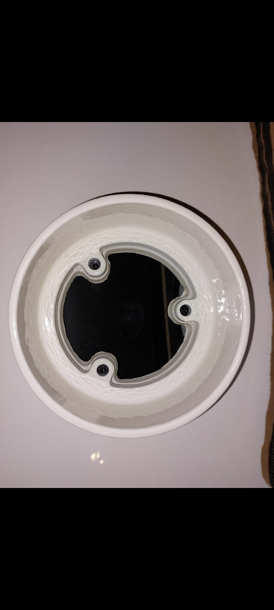

Just took delivery of the new stove. It is designed for a 5 inch flue, and my plan was to install a 4.5 inch single wall flue with silicone and fire rope.

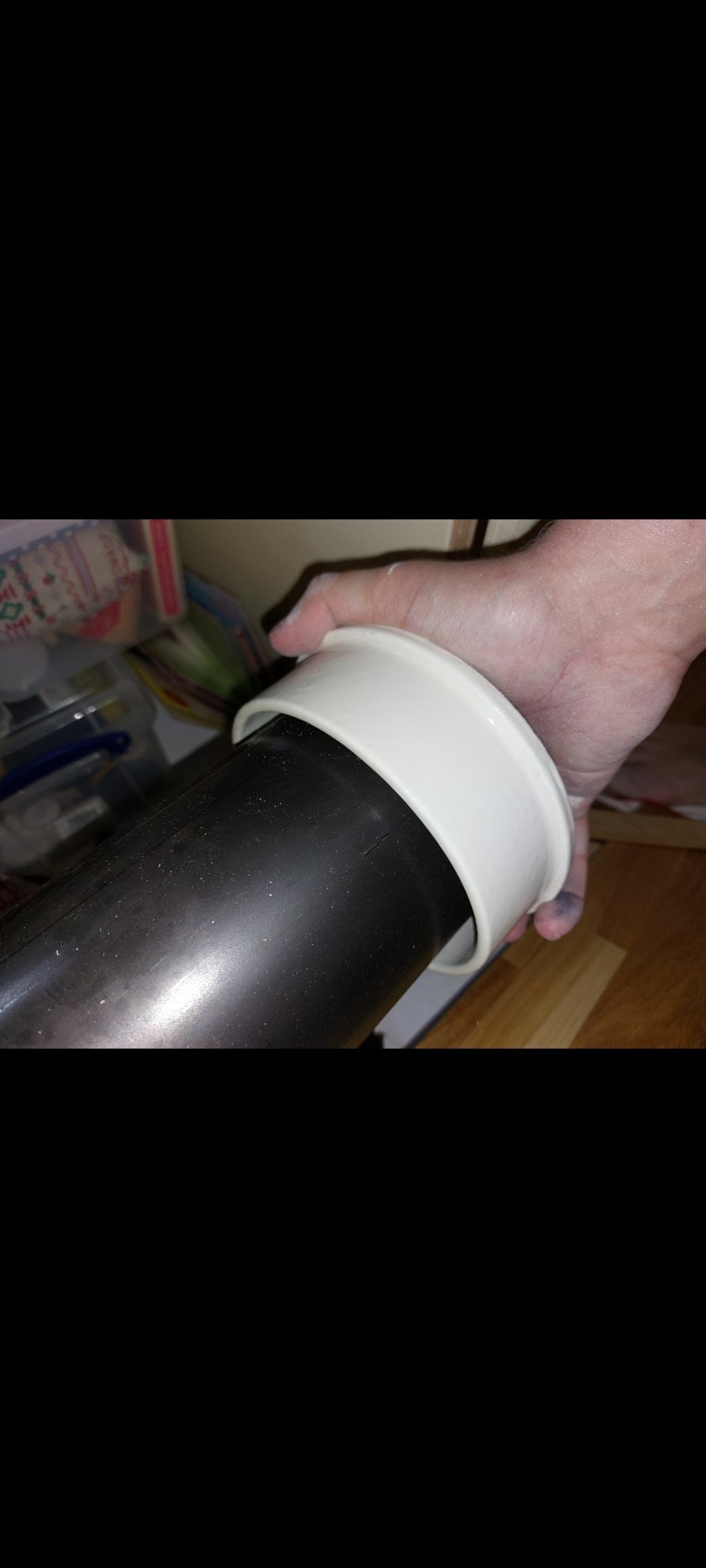

As you can see from the pictures attached, the flue collar is a little larger than expected. The 4.5 inch flue will still fit and surround the internal hole of the stove, but the gap to fill all the way around is about 10mm.
Will it still be acceptable to seal this with envirograf silicone and fire rope? If so, what order and procedure would you recommend? If not, would you recommend a reducer like this:

Just had a look at mine and the gap is almost as big as yours. I used fire-rope, its available in some quite big sizes, and then high temperature silicone.
I have found that fire cement cracks after a short time.
The silicone on mine is coming a bit unstuck so will likely need redoing before this winter, but its been on there for several years without problems.
As others have said, fire rope and Envirograf, which will withstand up to 1200c. However, do make sure your fire rope seals all possibility of flame contact first before sealing the remaining gap with Envirograf. The instructions specifically mention that, if exposed to flame, Envirograf will burn with a barely noticeable flame.
Incidentally, Envirograf smooths very nicely to give an excellent finish to the top of the collar. I used clear, which blends perfectly with my flue once dressed with Stovax stove blacking.

Yes, stuff the gap with plenty of rope first so that it's reasonably solid, then seal with Envirograf. Don't put the silicone in first as someone suggested as it will burn so pointless.

Thanks so much everyone! Would you use the same combination of rope followed by sealent for the gap between flue and roof collar?
Yes. You need to seal the gap above the rope so that water vapour and combustion gases condensing on the inside of the chimney and dripping down can't penetrate and leak through the gap.
Your flue will expand as it gets hot so the rope and sealant create a flexible seal that can accommodate the expansion. Check the sealant in summer once you stop using the stove and reseal if required.
