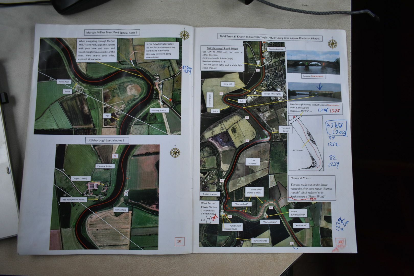

Here's a sample from the standard Trent chart (not a normal Admiralty style chart).  Pretty easy to follow, and especially if you buy it before you arrive at Cromwell lock (where the tidal section starts).
It is handy to have one person who is reading the chart and giving you advance warning of what to do next, enabling you to keep your head up and spot eg any floating rubbish, or ducks that appear to be standing up (never a good sign!).  Good luck!

The Sissons charts are dead easy to follow. The aren't like a sea chart, but a google earth style view of sections of river, with the safe line drawn on, along with photos of bridges and descriptions to flesh it all out. Having it in front of you as you steer, it helps you pick the optimum route, bridge arch and so on.

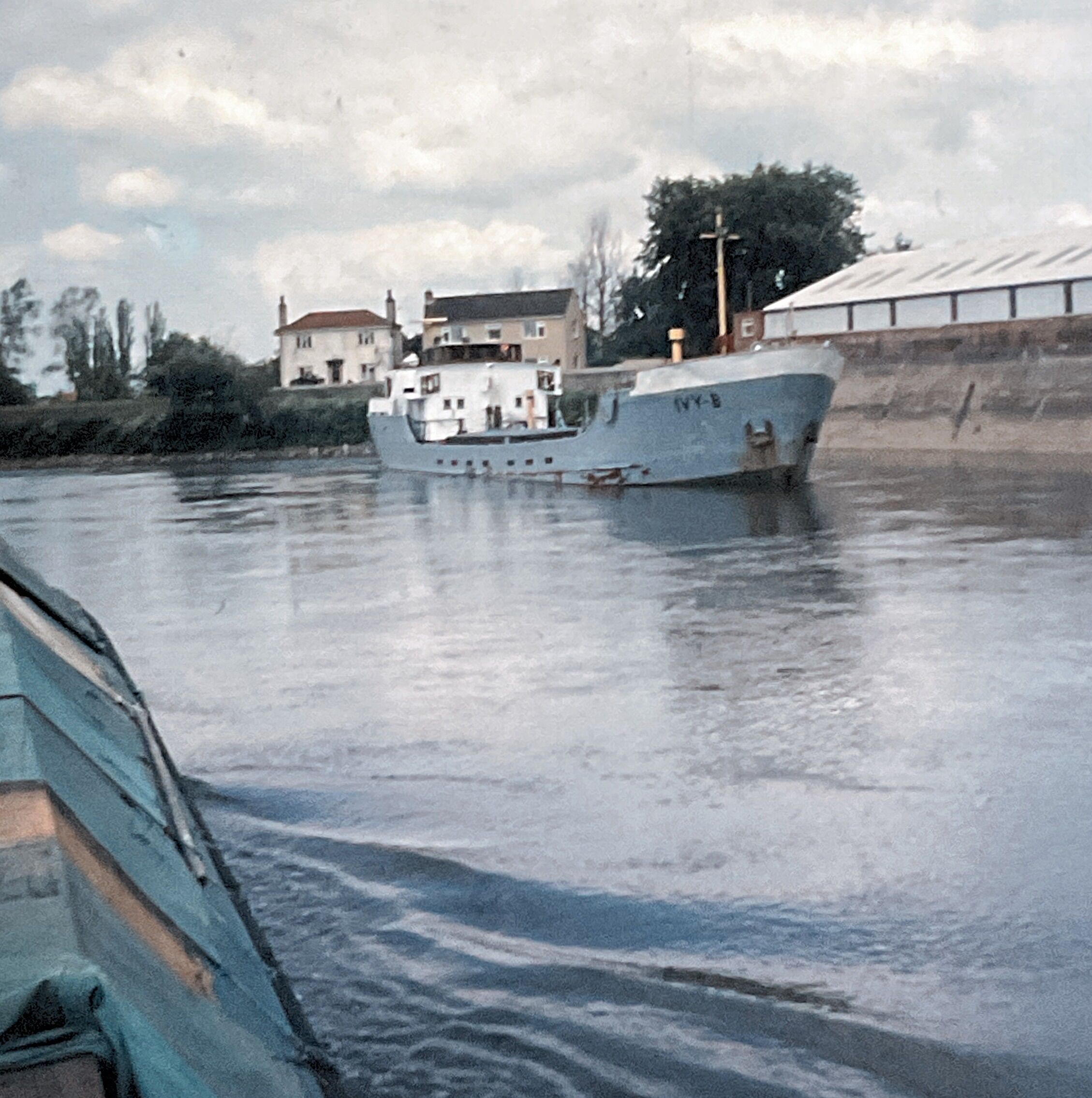

Done the tidal Trent a few times and a couple of times stopped alongside a coaster at Gainsborough to wait for the tide due to low water. The pilot told us about 2 coasters coming up on the tide  and we met one where he said we would. I believe that nothing comes up to Gainsborough now
I would be interested to know when ships did stop coming up to Gainsborough. I would say nothing has been up there more than gravel barges  since I have been boating on the Trent in 2008. And for a few years now now there are no gravel barges operating (as far as I  know).
