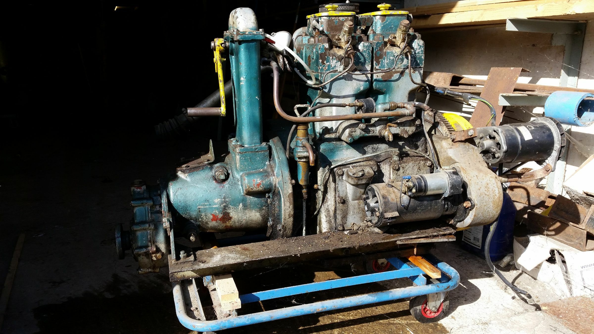

Hi all, my friend has a Lister Petter AVA2 engine in her narrowboat but no gearbox. She doesn't know what type of gearbox it was as it was taken for repair but basically stolen along with a her money. Can anybody help with some info on the type of gearbox used with AVA2 engines or even better have a servicable one for sale?
I think most AVA's had a Parsons box, but it should not be hard to adapt things so that a small PRM will fit.  Worth a chat with Richard of Primrose Engineering.

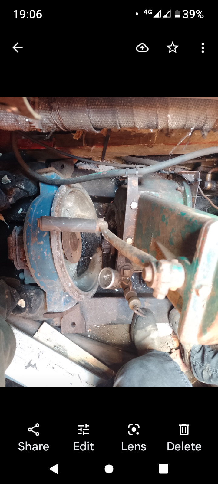

Something odd here. The engine has the raised had start and a small adapter for a gearbox with the centre of the reverse cluster - painted green
On the left is a Hurth gearbox, which looks too small for the job, on an adapter which is too big for this engine - painted blue

The OP did say "ignore the gearbox", I suspect the one in the photo was obtained to replace the original, and then it was found not to fit.

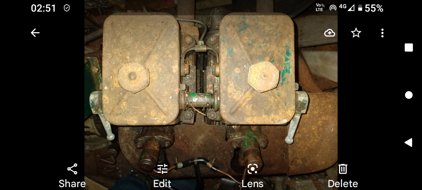

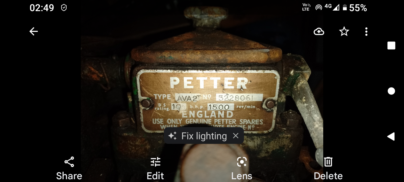

I've just spotted, this AVA might be a PH2. If so, we may have a gearbox
Richard

Hi Richard, sounds promising, how would I be able to confirm this is a PH2?

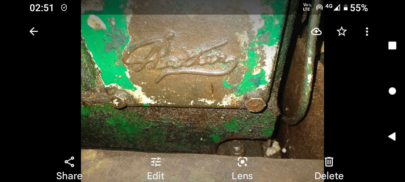

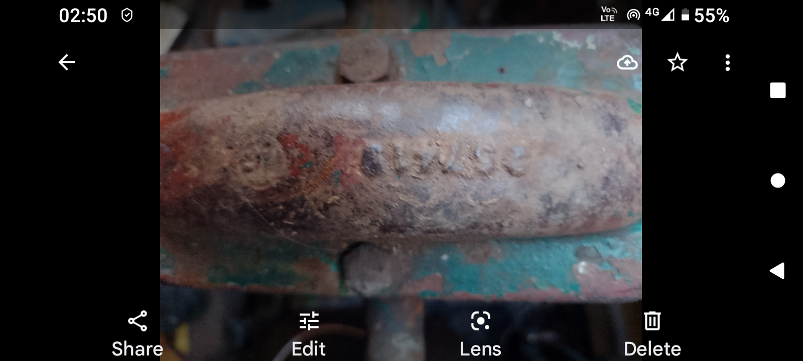

It looks like the rocker boxes on the top of the engine still have their labels attached. One of them should tell you what the engine is
Richard

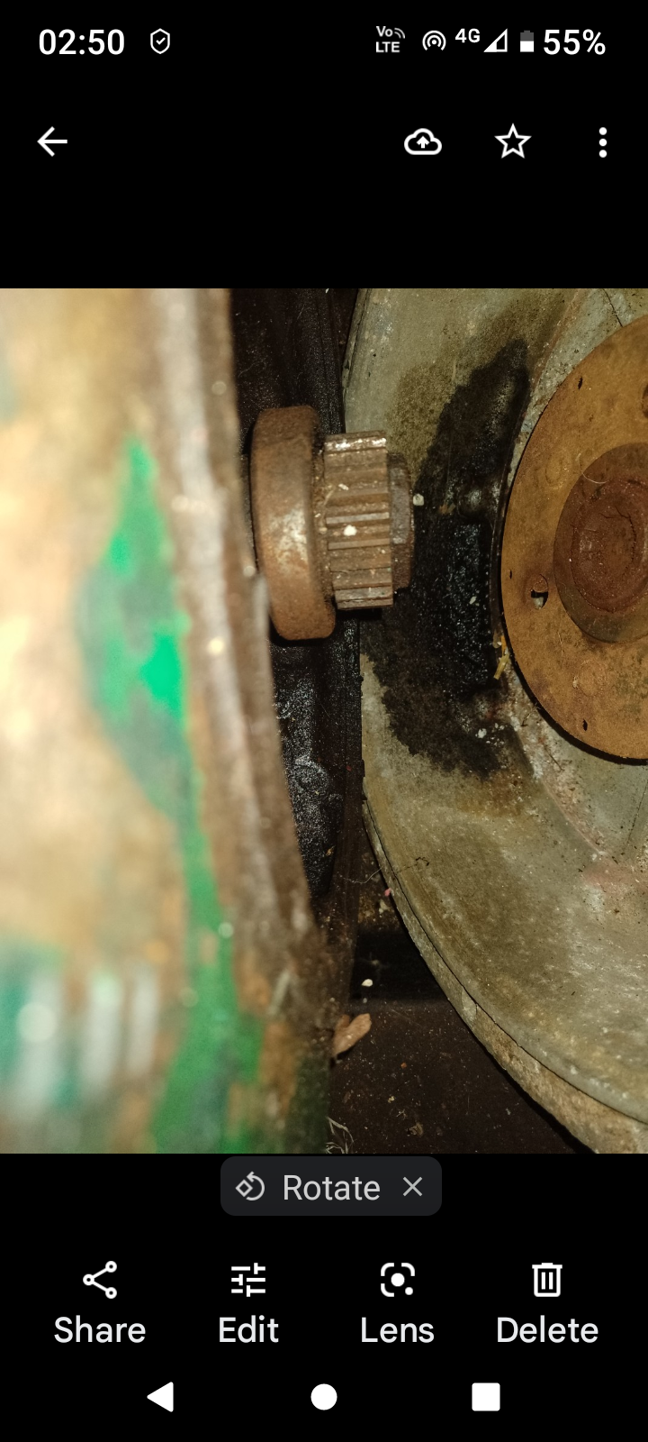

I am sorry, but it was nearly 60 years ago when I was dealing with the B Type BMC boxes, and I don't have a manual. I know Richard has had dealings with them much more recently, so he may well be your best hope of help.
It is the gear sticking out that made me think Parsons or B type but the gear does not look quite right for the B type and I THINK there was a cam on that gear shaft that worked a plunge type oil pump to squirt oil into the planet gears. I can't see that. This pump was carried on an intermediate plate that fitted between the gearbox and flywheel housing, there is no sigs of that in the photo and Paul's photo of an AV2 has the flywheel on the other end of the engine. Your photo seems to show what looks very like a flywheel housing on the gearbox end of the engine that also houses what I take to be a raised hand start mechanism.
Paul's photo has the raised start on the gearbox casting, unlike any B type I have ever seen, but the reduction box, reverse brake band adjuster, real mounting intermediate plate between gearbox and reduction box, plus the tapered shape are all very reminiscent of the B type. However, based on what I found on the Mathy-parsons website I suspect it is a Parsons B type box, possibly with some Petter additional castings involved for the raised start and flywheel housing.
I very much fear it will be all too easy to get the wrong box. Maybe it will be cheaper and less time-consuming to fit a complete second hand engine and gearbox.

What I can see all looks pretty standard for a PH, Tony
Richard

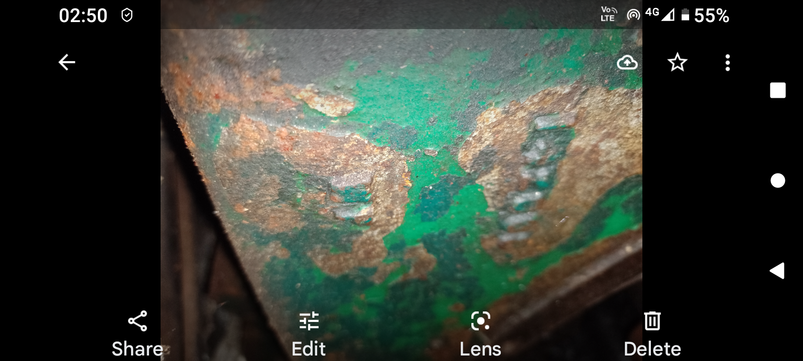

It's took a while to get more pics due to it not being my boat but here they are.
There's an offer of a Isuzu engine with gearbox but I thought I'd check out getting right gearbox first as this seemed easier to me on paper. The reality seems anything but atm.

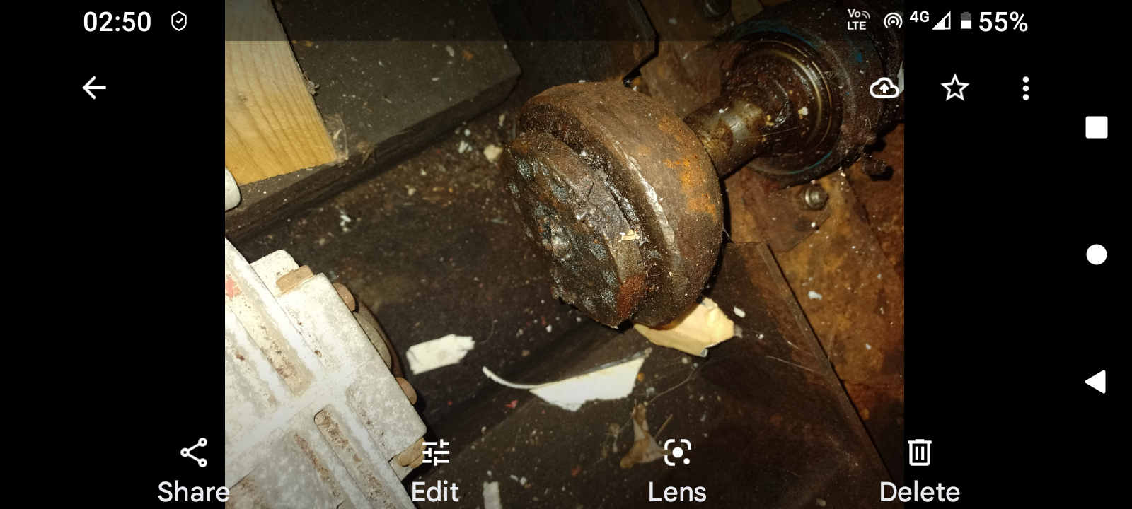

More pics that might help
