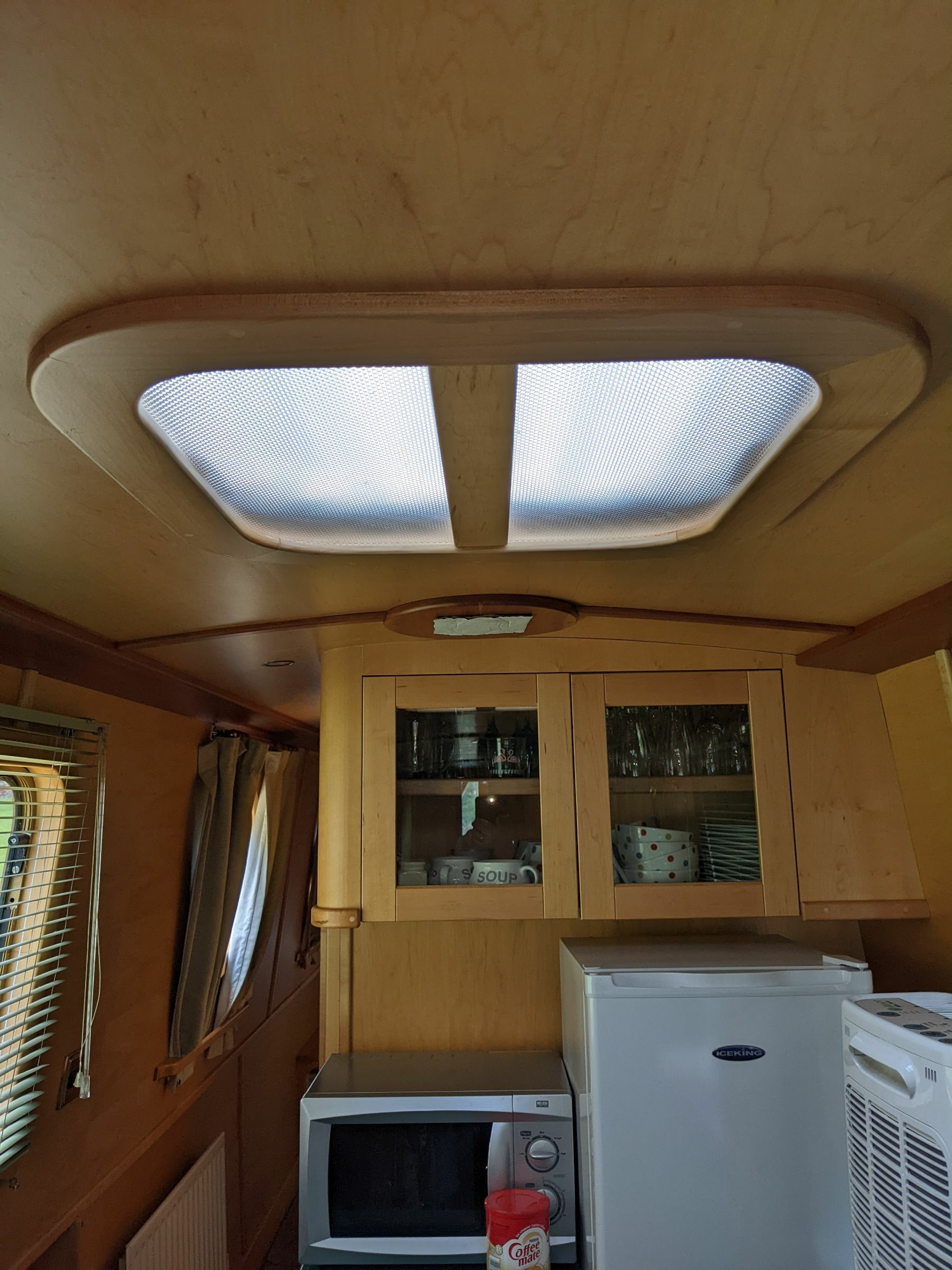

1 minute ago, cuthound said:
I've got two Houdini Hatches. Neither drip but they have removeable  plastic diffusers underneath them.
You got an image for reference by any chance?
There you go.
The centre piece of wood and plastic diffusers panels simply rest against the surround and are removeable.

I have a pigeon box in the galley and it doesn't drip condensation, I designed it that way with the glass overshooting the upright sides, so any condensation goes outside the boat.
Just now, Slow and Steady said:
I like that, did you make them yourself?
No, they came with the boat. There is one in the galley (the one in the photo) and one in the bathroom.
The boat will be 15 years this year and I have owned it for 8. To date no drips, leaks or condensation issues with the Houdini Hatches.
I want some! Mine do drip like buggery in the winter with cooking condensation, though we do have shaped cushions to stuff in the holes which works but obviously no light then so we put them in in the evening. I will google and see what I come up with. Thanks for the info, it seems like very little trouble for the results.

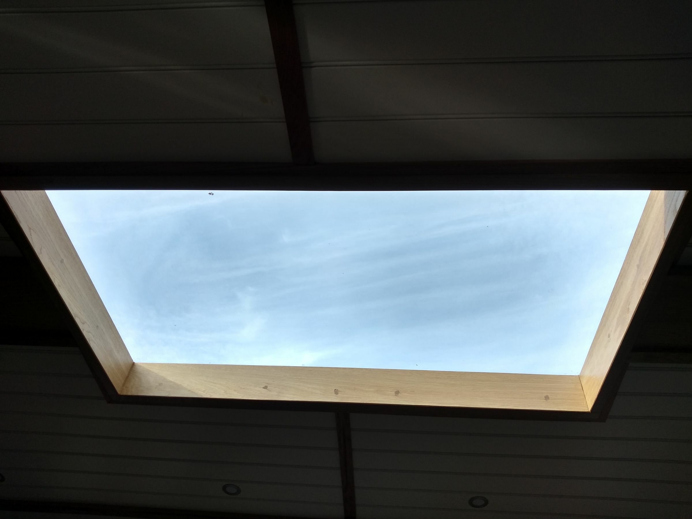

We had 3 in our narrowboat. No condensation as we fitted a perspex panel underneath attached by magnetic tape.
This is the skylight on our widebeam. Triple glazed, not that I would walk on it. No condensation.
