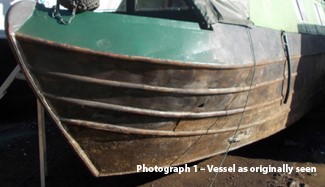

Overplating Photograph 1 Overplating Photograph 1
These factors made me put pen to paper when I was recently asked to look at a narrow boat which had been purchased without a survey that being the first mistake. The owner had the vessel out of the water for blacking and had decided to have the hull thickness determination for future maintenance.
The vessel had a doubling plate close welded between the whisker harpins on the port bow. I was suspicious of the area around and behind the doubling plate due to the poor quality of the welding and suspected the latter to be porous to water ingress as the plate was below the water line.
The upper whisker harpins were found to be suffering from jacking corrosion which had been instigated from the D bar only being stitch welded along the top and bottom of the bar which is also a common defect found on such vessels as the builder can save time and money by not seam welding such bars.

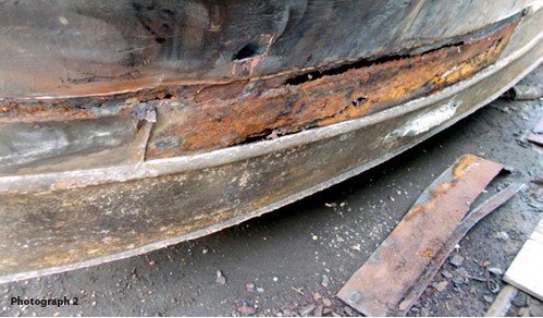

Overplating Photograph 2 Overplating Photograph 2
However, the defect in this case was compounded when the shell plate was found to be holed above the harpin. The hole can clearly be seen in Photograph 1 which shows the area of the vessel as first seen. It was also noted that a poor repair had been carried out below the lower harpin forward and the shell plate was also found to have excessive pitting just aft of the stem.
The upper harpin and doubling plate were cut off while I was on site by grinding off the welds and Photographs 2 and 3 show clearly the heavily corroded inner repair plate and appalling condition of the underlying shell plate.

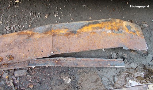

Photograph 4 shows the faying surface of the doubling plate that was removed and which can be clearly seen to be corroding from the inside outward. It can also be seen in this photograph the doubling plate had been welded to the harpin in places making the doubling plates seam weld porous to water to entering between the doubling plate via the gaps created when the D sections harpins were originally stitch welded in manufacture. The fault would have been compounded by crevice corrosion and a poor maintenance programme though out the vessel’s life.

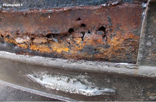

Overplating Photograph 3 Overplating Photograph 3
The only possible repair to that damage is a complete crop out of derogated steel work and new steel close welded in to the aperture and new D section bar fitted to the shell side and which should be seam welded fully along the top and bottom of the bar.

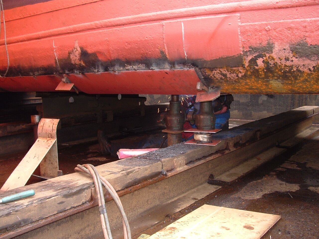

Overplating Photograph 4 Overplating Photograph 4
Patrick Keating, who regularly lifts narrow boats at South Dock, has stated that he has seen a number of such vessels where the bottom plating was sagging because the whole area had been doubled and where the doubling plates were unattached to the frames or even the remains of the original bottom plate.
He stated that, on one vessel, the welder, who was about to work on it, started to cut out a section of plate and, as soon as the plate was broached, water started pouring out. The bilges were immediately checked and found to be dry and it was estimated that at least 500 litres of water had been trapped between the doubled bottom and the original shell with the water getting between them from the bilge through holes in the original bottom plate.
I have also seen water pouring out from doubling plates on the shell plate sides through pin holes found in the seam weld whilst carrying out survey’s and try to make a point of viewing the vessel being lifted from the water.
The obvious problem with this practice was that the doubled shell plating can corrode from the inside out with no external evidence of the problem is not usually seen and can often go undetected until too late. In recommending the fitting of doubling plates the marine surveyor must take even more into account than the increase in draught and loss of freeboard due to the added weight. For example, a forty foot long narrow boat will have a tons per inch immersion value of about 0.55. If her bottom is fitted with a 6 mm thick doubling plate over about 30 feet of her bottom by the full width she will sink by about 1½ inches with an equal loss of freeboard plus a deleterious change in her metacentric stability and down flooding angles.
