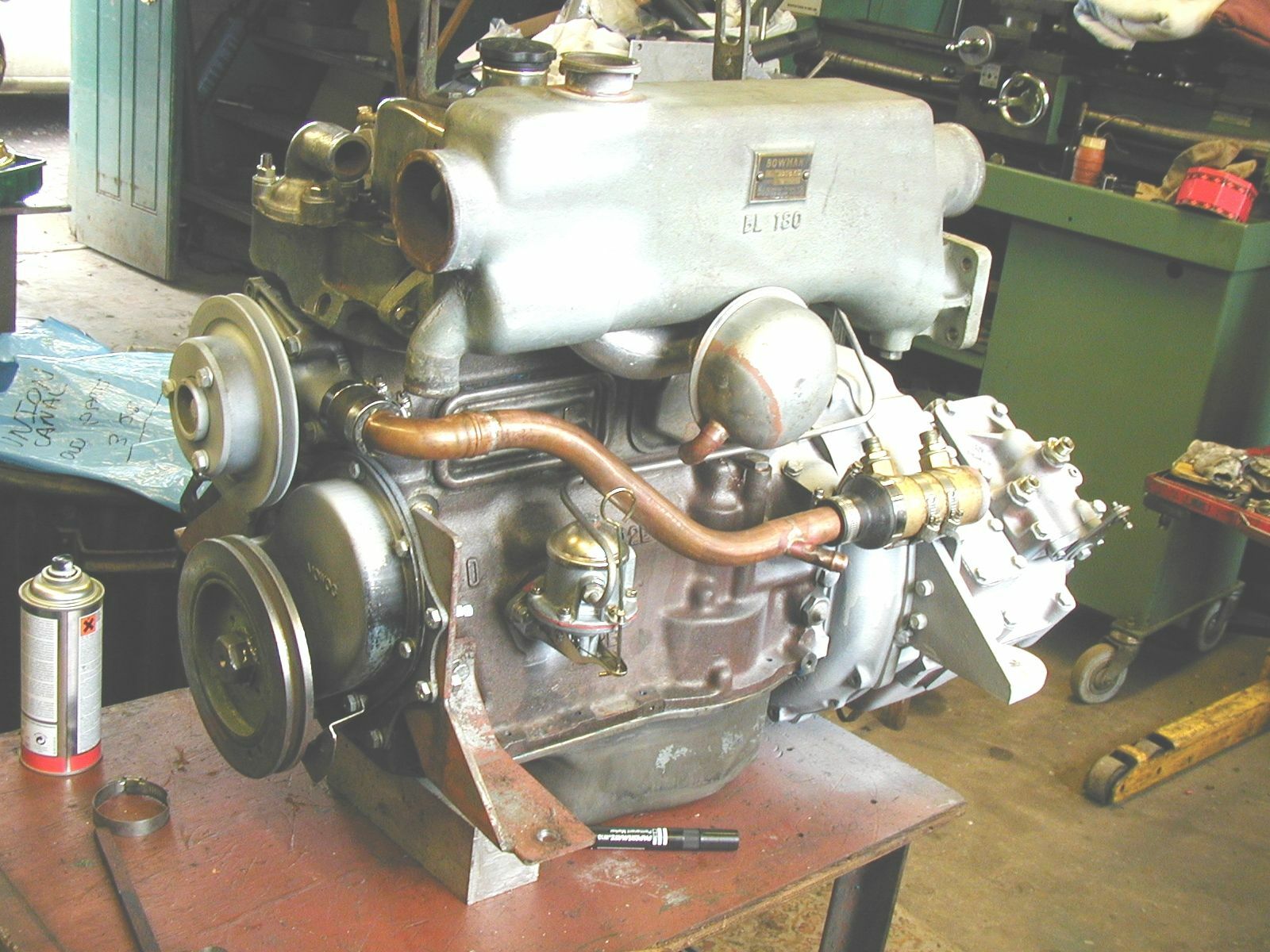

One thing that hs occured to me, a 1005 alternator belt is quite short for a BMC1.5, unless you have misquoted the size in your original post. A larger crankshaft pulley wheel would increase the revs of the alternater at a slower engine speed. (or a smaller alternator pulley - not illusrated) Does yours look this size ?
Edited by David Schweizer
9 minutes ago, David Schweizer said:
One thing that hs occured to me, a 1005 alternator belt is quite short for a BMC1.5, unless you have misquoted the size in your original post. A larger crankshaft pulley wheel would increase the revs of the alternater at a slower engine speed. Does yours look this size ?
I would guess that it's about that size.  There is the added pully on the crankshaft.  It's a small one and is used for the pelt drive to the raw water pump.
Edited to add:  An extension to the maths will show that the force on the drive belt to the alternator does not change as the pulley size on the alternator changes.  I find that quite interesting.
