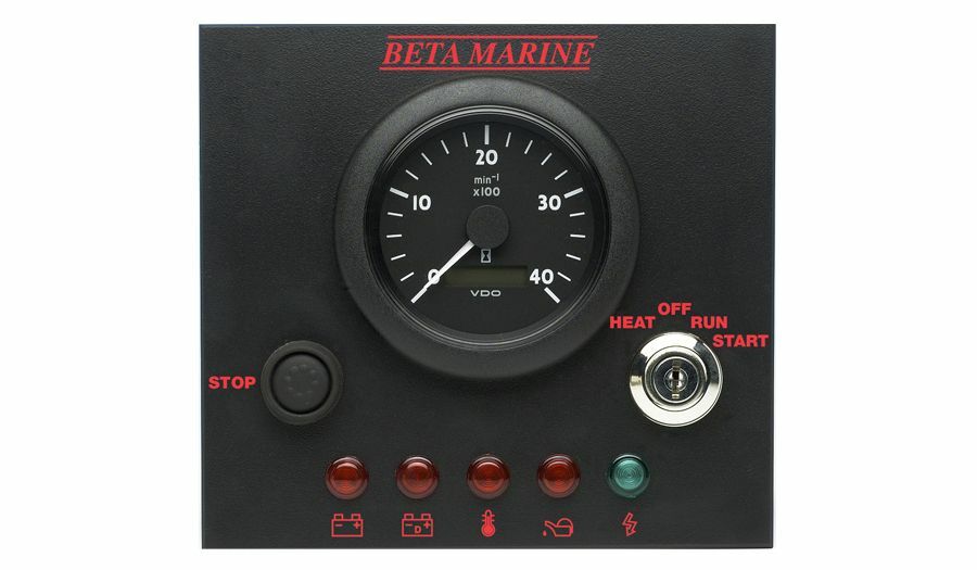

Hi folks could anyone tell me how to wire in a stand alone engine hour meter from a AB control panel. The built in VDO is dead.

My AB panel is 20 years plus old and the rev meter and counter still works perfic - soo could it be a wiring problem if both are dead??
I bet its not, I also bet your hour counter is a mechanical one like an old car's mileage indicator. I think it the dreaded LCD screen failure that seem to be an ongoing thing with LCD hour counters,  especially when outside.
It is indeed a LCD screen, rev counter works fine. Damp has killed the LCD. I will be tackling the water ingress from the hatch first. Replacing the whole unit would be expensive compared to a new counter, I don't consider it a bodge solution just a sensible one seeing as the rev counter works.

I tried my best guys, I went on the Beta Marine site to get the correct panel, which is the same as in the picture, I'm sure it was an AB code, I'll post pics up next time, people like pictures. I basically want to know what engine hours are on this engine as its new to me. I've been back in forum search history and read up as much as I can too.
If you dry it out it may light up and tell you, they often keep counting but not displaying I am told

When the one on my first shareboat went blank I took the rev counter out and out it in the airing cupboard next to the calorifier for a week. When I put it back into the instrument panel it was working again and had even remembered the number of engine hours it had already counted.
Got to be worth a try before buying a new one.

And somewhere on the forum  think there are instructions on how to remove, clan and refit the display ribbon cable who's connection seems to cause the problem, at least in some cases.
Mine does that. It is still possible to read it in some light. The OP might try getting up close and personal with a torch.

I replaced my VDO gauge lcd as it was displaying nonsense but still counting. Found a company online, AK speedo, and they supplied the replacement. It was a fiddly but simple operation to remove and replace following their videos.

Our Beta hour counter stopped reading about 6 or 7 years ago - but I keep a log. Three weeks ago it suddenly came back to life and in the sun I could make out the reading. I was 61 hours out over all that time, which I thought was pretty good.
I was told by an RCR engineer that damp kills these things - and that if it was mounted in the insulated bulkhead forward of the helm position, it would continue to work.
