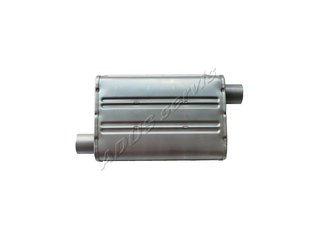

blackrose Posted September 22, 2021 Author Report Posted September 22, 2021 This is the silencer I have.
matty40s Posted September 22, 2021 Report Posted September 22, 2021 30 minutes ago, blackrose said: This is the silencer I have. Ah, with that one, it needs to go in one end and out of the other.
blackrose Posted September 22, 2021 Author Report Posted September 22, 2021 10 minutes ago, matty40s said: Ah, with that one, it needs to go in one end and out of the other. In any particular orientation?
TheBiscuits Posted September 22, 2021 Report Posted September 22, 2021 The webasto marine silencer is a cylinder. Please check that one doesn't have a condensation drain hole on one side that will allow exhaust fumes to collect inside your boat!
Cas446 Posted September 22, 2021 Report Posted September 22, 2021 31 minutes ago, blackrose said: In any particular orientation? It doesn't matter, however that one does have a mounting hole, so put something in the hole. Better still buy a proper exhaust from here https://mvheating.co.uk/product/22mm-exhaust-system/
PeterF Posted September 22, 2021 Report Posted September 22, 2021 1 hour ago, blackrose said: This is the silencer I have. Is that one fully sealed, the end caps only look like they are spot welded on not seal welded. OK for under a car or truck but not sure about a boat. Check to make sure.
blackrose Posted September 24, 2021 Author Report Posted September 24, 2021 (edited) On 22/09/2021 at 22:24, Cas446 said: It doesn't matter, however that one does have a mounting hole, so put something in the hole. Better still buy a proper exhaust from here https://mvheating.co.uk/product/22mm-exhaust-system/ Thanks, I'll screw a short bolt into it. On 22/09/2021 at 22:53, PeterF said: Is that one fully sealed, the end caps only look like they are spot welded on not seal welded. OK for under a car or truck but not sure about a boat. Check to make sure. Thanks, the ports look fully sealed to me. I'll pressure test it. Edited September 24, 2021 by blackrose
