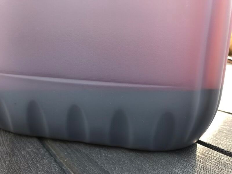

Filter porn as promised… Top is the original filter, a Beta branded one, after approx 150hrs. Bottom is the one I subsequently swapped after about 40hrs (a Baldwin). Some of the dust will be from the Dremel cutting disks. I’ve never opened up a diesel filter before: Is the amount of crud on the top filter really enough to stop an engine, or should I be looking elsewhere as well? Note that this is the only filter on the engine, there has never been any pre-filter.
Sorting out the bits to try to clean up the bottom of the tank.
Is that a fried egg with black-pepper in the bottom of the lower filter ?
Ha! no, it’s a trick of the light, a bit of diesel, and some dust from the cutting disk.
