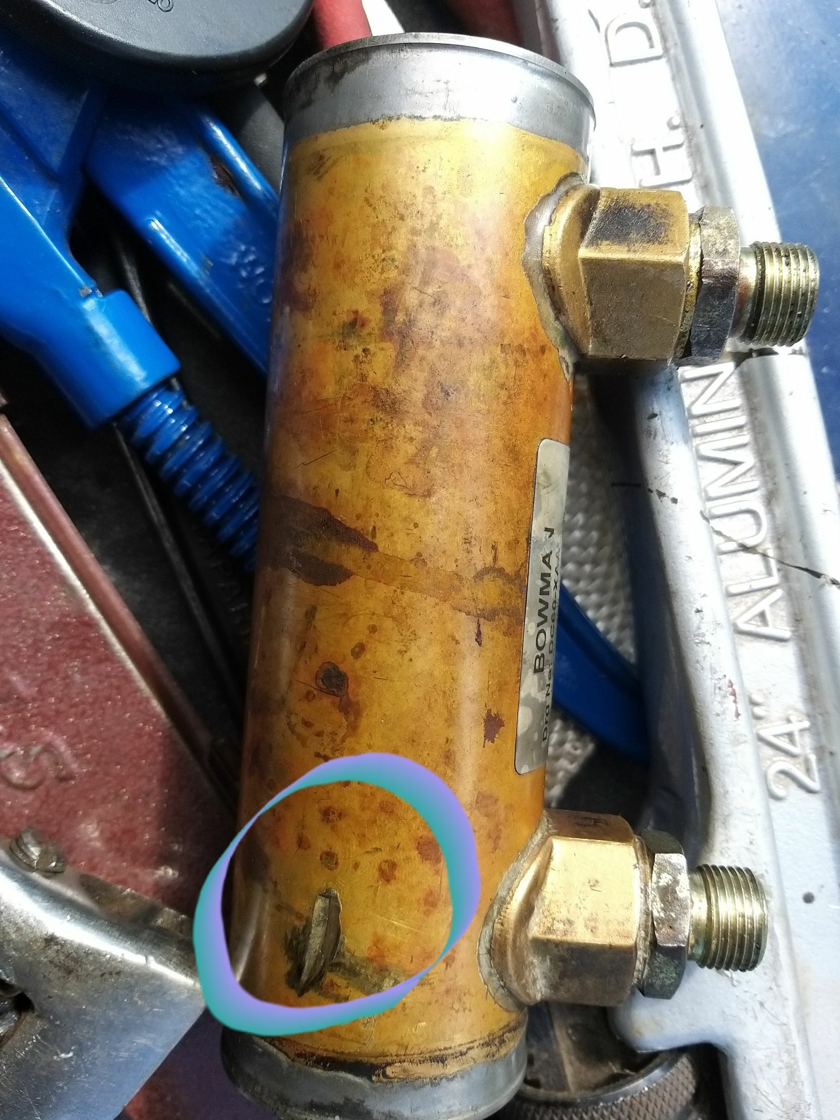

matty40s Posted August 26, 2021 Report Posted August 26, 2021 We had an interesting gear box leak this week, owners said that they had topped it up and it had emptied in hours. They left the boat on Saturday. We couldnt feel or see any oil leak on Monday so emptied engine sump, put down clean pads, filled it and ...still couldnt see any leak. Ran it up, and eventually saw some ATF oil on a nut on the Isuzu engine top. One of the engine mounts was very loose, meaning more than usual vibration, heat exchanger not mounted, just sat on a bracket, who's nut had worn through the outer jacket.
