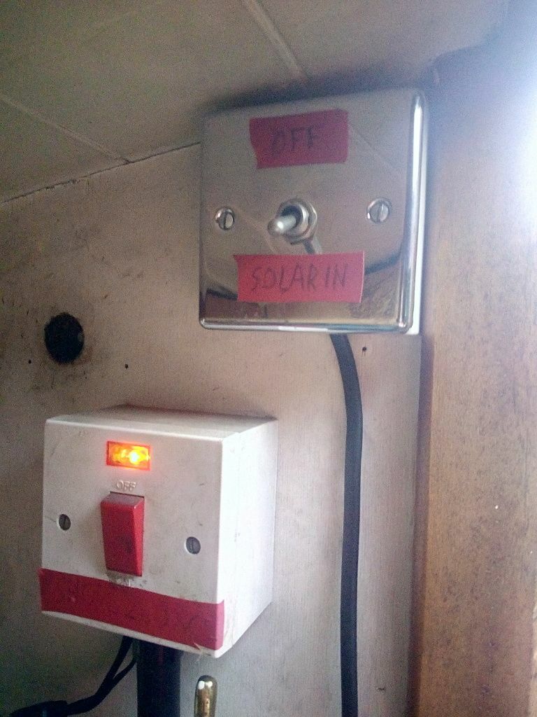

LadyR Posted August 19, 2021 Author Report Posted August 19, 2021 9 hours ago, LadyR said: Yay- so can I now I know it’s working, I probably wouldn’t have slept 🤪 The water that I couldn’t pump out was what went into the shower tray (on my boat) before I managed to get in the shower because the pump didn’t want to work, so I pissed about for 2 hours trying to figure it out, which is now working and luckily I’ve had a “boat shower” now. I hope that helps to clear up the confusion 😃 Not the best photo of the switch. It seems to be working again this morning. It’s definitely something I will take a look at when I get the boat home.
Tony Brooks Posted August 19, 2021 Report Posted August 19, 2021 8 hours ago, The Happy Nomad said: Im imagining the 12v shower has been wired through a 240v fused spur?? It looks that way, but I have tried enhancing the photo to see exactly what the working parts are, but with little improvement. 16 minutes ago, LadyR said: Not the best photo of the switch. It seems to be working again this morning. It’s definitely something I will take a look at when I get the boat home. It looks as if that is a 230V AC (mains) switch and if so you need to be aware that using it to switch off an inductive 12V DC load like a shower pump motor has the potential to burn out the switch contacts. When it eventually fails, think about seeing if you can find a blank face plate to match and fit a proper 12V switch in that. With the dedicated fuse on the fuse panel, I don't see why you need a fuse in the switch plate as long as the panel fuse is rated for the thinnest cable in the circuit - possibly between the boat's wiring and the motor.
Jen-in-Wellies Posted August 19, 2021 Report Posted August 19, 2021 8 minutes ago, Tony Brooks said: It looks that way, but I have tried enhancing the photo to see exactly what the working parts are, but with little improvement. It looks as if that is a 230V AC (mains) switch and if so you need to be aware that using it to switch off an inductive 12V DC load like a shower pump motor has the potential to burn out the switch contacts. When it eventually fails, think about seeing if you can find a blank face plate to match and fit a proper 12V switch in that. With the dedicated fuse on the fuse panel, I don't see why you need a fuse in the switch plate as long as the panel fuse is rated for the thinnest cable in the circuit - possibly between the boat's wiring and the motor. This is the sort of thing that Tony is describing. The top switch is used on my boat to turn off the solar panels. A standard mains pattress blanking plate, here is a brass finish one, which has a proper 12V DC switch fitted. Toggle switches are easier to fit as it just needs a round hole drilled in the plate. A rocker switch generally needs a rectangular hole, which is more time consuming to make (there are exceptions). Make sure, for a shower pump, the switch is rated for at least 5A at 12VDC. Switching high current low voltage DC actually needs specially designed switches to last a long time. You can get away for years with using a mains switch, but ultimately, it will burn out the contacts. Someone will reply shortly to say that they have run a whale gulper for 127 years with a mains switch and it is still fine. 😃 10 hours ago, LadyR said: The water that I couldn’t pump out was what went into the shower tray (on my boat) before I managed to get in the shower because the pump didn’t want to work, so I pissed about for 2 hours trying to figure it out, which is now working and luckily I’ve had a “boat shower” now. I hope that helps to clear up the confusion 😃 Not sure if I should say this, or not, but pissing in a boat shower will mean it ends up in the canal when the pump works. 😃
LadyR Posted August 19, 2021 Author Report Posted August 19, 2021 36 minutes ago, Jen-in-Wellies said: This is the sort of thing that Tony is describing. The top switch is used on my boat to turn off the solar panels. A standard mains pattress blanking plate, here is a brass finish one, which has a proper 12V DC switch fitted. Toggle switches are easier to fit as it just needs a round hole drilled in the plate. A rocker switch generally needs a rectangular hole, which is more time consuming to make (there are exceptions). Make sure, for a shower pump, the switch is rated for at least 5A at 12VDC. Switching high current low voltage DC actually needs specially designed switches to last a long time. You can get away for years with using a mains switch, but ultimately, it will burn out the contacts. Someone will reply shortly to say that they have run a whale gulper for 127 years with a mains switch and it is still fine. 😃 Not sure if I should say this, or not, but pissing in a boat shower will mean it ends up in the canal when the pump works. 😃 Naughty naughty 🤣
